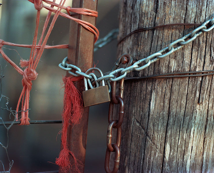

Hey guys,
Have been everything I can on scanning technqiues with my Epson V700 in combination with Vuescan.
I have been using the advanced workflow technique of locking the film base exposure/colour and then scanning as a raw output into PS. From there I have tried the Color Neg plug-in but I wasn't too happy with any of the profiles which didnt do too well with new Portra 400. So I cancelled the plug in and tried inverting the raw scan myself by using Photoshop auto levels and an inverse curves layer. From here I increased the contrast, brightness and vibrance slightly.
I'm really a novice at film scanning and this is the first time I've used Portra so i don't know what I should be aiming for in terms of getting the great tones and colors that Portra is known for.
Anyway I'd like your opinion on these final scans as I'm not the best judge of color. Am I in the right ball park. ANy idea of how I can improve these further?
Both were shot with RZ67 with 110mm wide open (f/2.8) in late afternoon sun / partial shade and overexposed 1 stop (according to incident meter readings). Developed normally in Rollei Digibase c-41 chemistry.

kaiser, scaning software can only do so much. The last step is on you to adjust density (how dark/light) and color balance in an app like photoshop. Your images look pretty good to me, but maybe a tad light and a bit cyan.

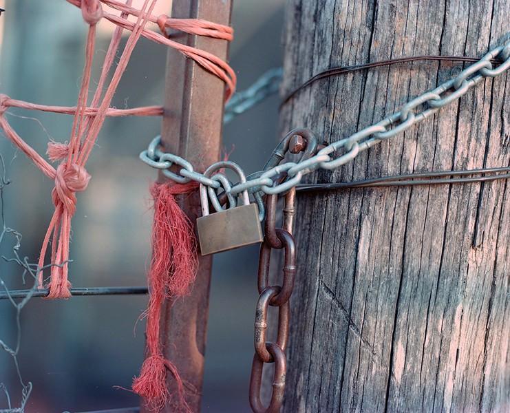

Using the curve tool I made the following changes to the images posted:
Young girl:
Input >> Output
Green 127 >> 145
Blue 127 >> 144
Pad lock
Green 127 >> 152
Blue 127 >> 154
By adjusting these channels the density fell into place by my eyes and it took about minute for both. The trick for me is to push the green channel beyond where it needs to be and then pulling it back (when the color goes from blue to mag and or cyan to green) and then doing the same for the Blue channel. I know CC is difficult thing at first, but practice makes it pretty intuitive. After a while you should be able to look at an image and immediately see what is needed.
In my experience automated tools can never replace the human eye and if they work even 90% of the time, if you have not developed the skill then you'll be stuck the other 10%.

Just ran those two through ColorPerfect with my usual settings and a quick eyeball ballpark guess on CCs. I probably spent no more than a minute on these two. It's just to give you an idea of what you can expect from the plugin when you get it set up correctly. As jd was mentioning above, it has a concept of CC filters for tuning the colour balance. Basically, it makes a first best guess at the colour balance, your second option is to click a neutral area in the image if there is one and finally you can just start adding and subtracting virtual cc filters just as if you were doing it olde skool but much faster.
For the girl I clicked a white spot on her sleeve to get close and then added a little blue and green to taste.
For the locks I clicked on a mid-tone section of the grey metal chain and tuned slightly from there. Honestly, on the second one I could do better if I knew how golden or not the light was supposed to look. Also, the chain and post one has some pretty burnt highlights on the one chain. ColorPerfect will work best if you don't have clipping on your original scan.

the pad lock and the girl look a tad pink (see the sky in both and the highlights in the post on the paddlock). here is what I got.

It's just the rose tinted glasses with which I see the world! ;-)
And there's nothing wrong with your versions either. A little colder, a little more punchy on the contrast. A matter of taste, I'd say. But for the original poster I think he was wondering whether he was in the ballpark on his inversions and I would say that we have both shown that he was really very close. It just needed that overall green cast removing. The base scan itself obviously had plenty of information for all the versions we have seen in this thread. So, kaiserkudo, you are VERY close and your scanning technique looks fine.

Guys thanks for much for all that information. For what it's worth I only have the trial version of Color Perfect at the moment and its in German - but from further reading I have worked out how to use the film type, gamma white and black point clipping functions. Might need to pony up to the full version me thinks.
Both of your edits look great and I guess it comes down to personal aesthetics. This lighting at time of shooting was quite contrasty and mixed - think low sun about 45 mins before sunset, filtering through lots of green foliage, and with patchy areas of shade.
It's good to know I'm headed in the right direction. Going to shoot some Ektar this weekend so I'm sure looking forward to seeing how I go converting that as well.
Just to clarify - I haven't been touching any histograms in Vuescan - only locking film base exposure and color and scanning as a linear raw file (tiff, jpg, dng etc all deselected). Should I be setting white and black point clipping in levels in Vuescan?
