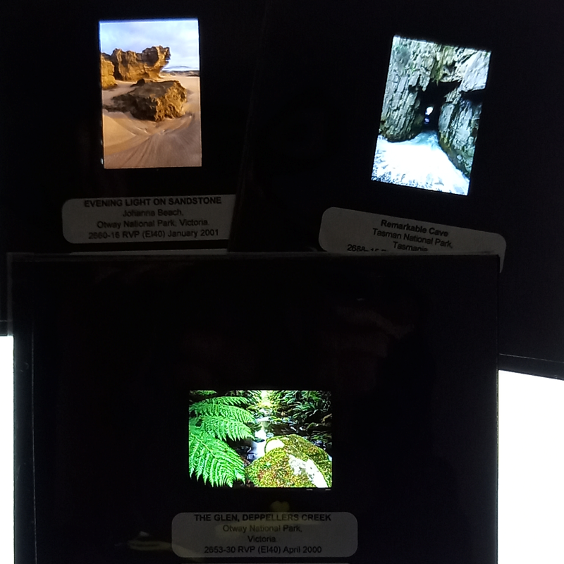

In my particular case, individual images scheduled for scanning then printing are snipped from the strips and mounted in archival card mounts. At the lab, the single frame is removed and taped to the drum scanner, then returned to the mask and taped down, inserted back into the poly sleeve and returned. Semi-stiff archival polyethylene cards (35mm, 6x6, 6x7, 6x9, 4x5 and others) are available at photographic suppliers.
____________________________________________________________________________________________
• 6x7 transparency individually poly-card mounted for scanning and printing
___________________________________________________________________________________________________________________________

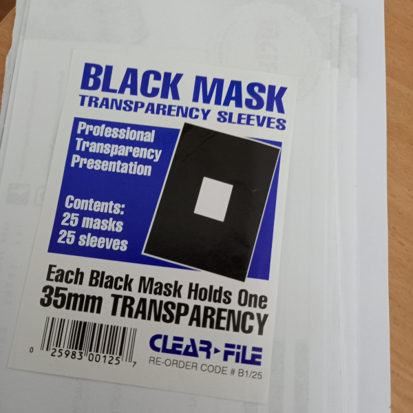

• Same poly card sleeves for 35mm + reference and CLEAR-FILE BLACK MASK TRANSPARENCY SLEEVES slip

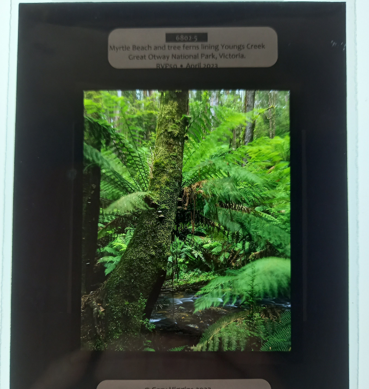

Good advice, beautiful photo!
Apologies though for the tote crappy phone pic, but I'm just posting here and there while having a (late) morning tea!!
