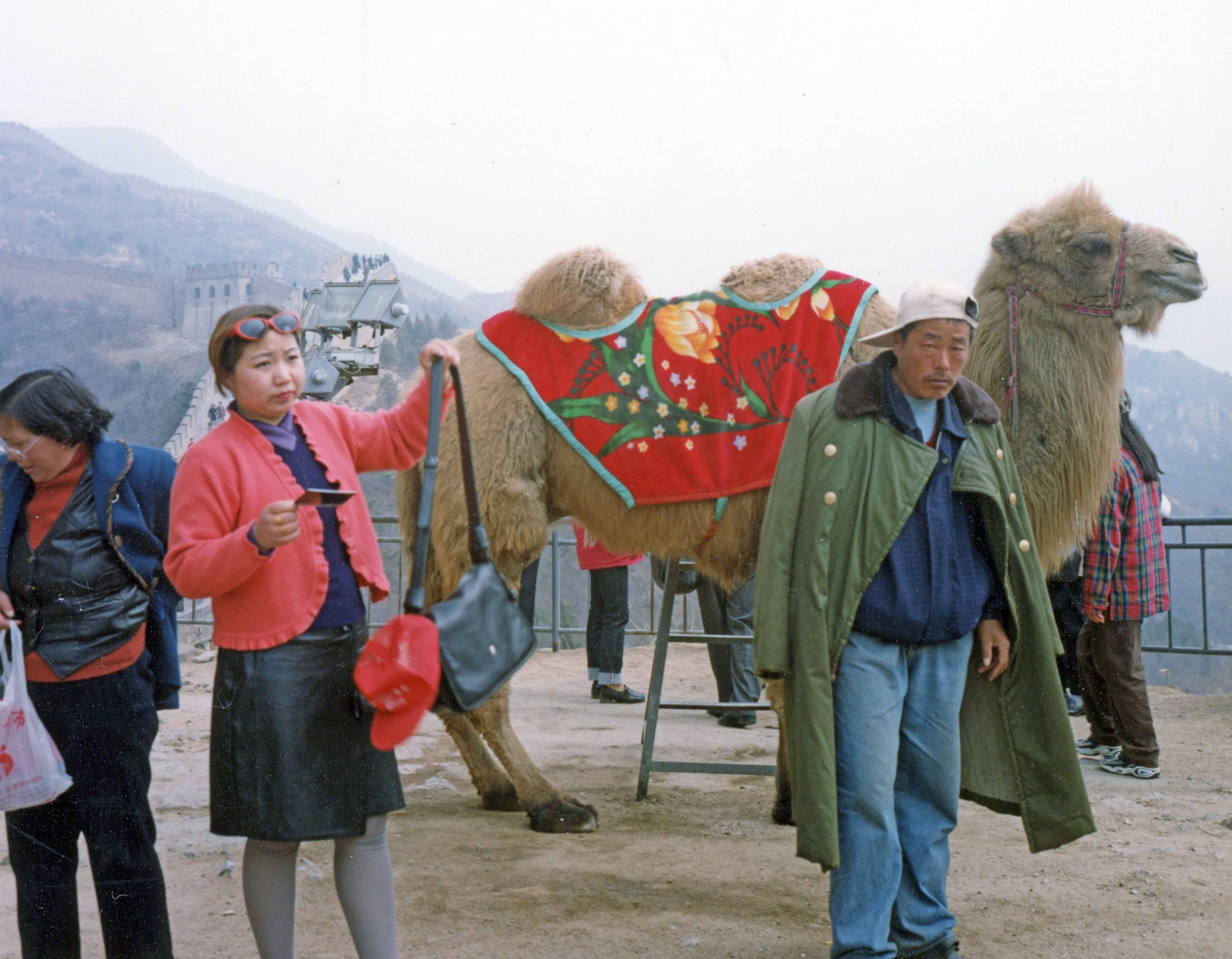

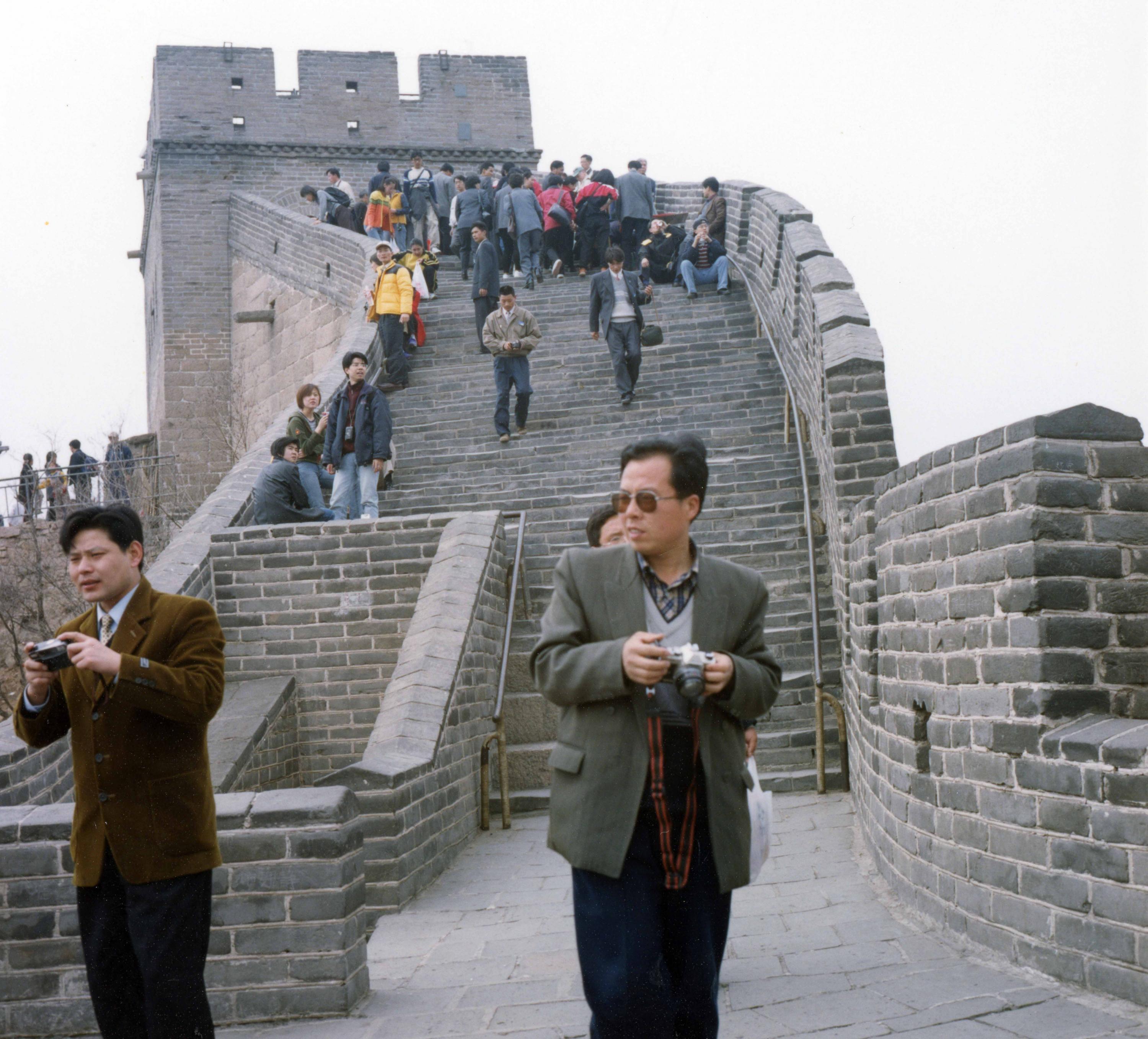

I don't know what you are doing if you are not getting sharp scans off 120. I've had 120 negatives that were rolled on cardboard tubes for around 10 years and just scanned them last week. They were hard to get into the holders, but I still got satisfactory results. Betterscanning may be a good place to start with holders and ANR plate. It was also be far cheaper than buying a 120 scanner from Plustek or Minolta ( I assume these are no longer made ) I'll try to attach a couple of images from 120 negatives in this post.img--C978-Great Wall photo area.jpg
I'm pretty certain that these are 120 negatives. I may have cut off part of the sky on the first making it look like it is not a 6x6 image.
