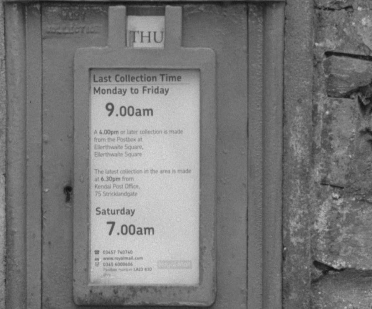

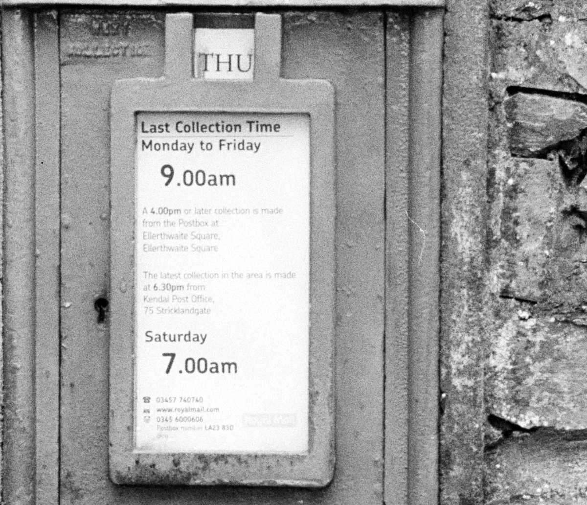

I can squeeze 48 lp/mm from my Epson V700 (about 2200 ppi). For my 6x7 transparencies (actually 68x57 mm) that's enough to print to 12"x16" at 300 dpi which is big enough for me. One thing I have noticed from slide (and neg) scans is that I have to apply way more sharpening than I would normally feel comfortable with to make a print look like it's high resolution - the resolution is there in the scan but you need to bring it out visually in the sharpening. I'm sure a dedicated MF scanner would be better, but the question is how much are you willing to pay for printing over 12"x16"?
To show the difference between the V700 and a filmscanner, I made those scans with my V700 and my Imacon Flextight.
Scanned on 3200dpi, only adjustment was setting black and white points, so no sharpening etc.
Scan 1 and 2 are Imacon, 3 is Epson. What you can see is that the Imacon shows grain, which the Epson does not, but I think the Epson scan is surprisingly good if you do not plan to go pixel peeping. After postprocessing both may look the same, apart from the finest details (grain).
If you plan buying a used filmscanner, I bought my Flextight for less than you will pay for a Nikon 9000 today. The biggest challenge is to get and keep it working on an old computer and scsi.
It’s a lot easier to use the V700.

Very interesting comparison, thanks for posting that. On balance I'd have to say that the V700 is pretty damn good for the money.
