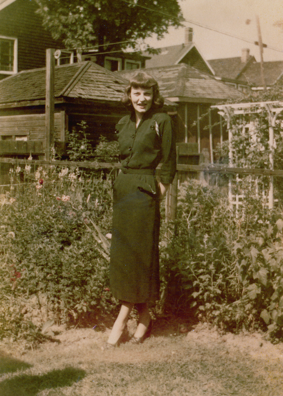

This photograph came from my late father's extensive "collection" It is a picture of my late and mother comes from an approximately 68 year old Kodachrome slide. The slide itself is almost transparent, with an overall green cast.
There are hints of colour and density information there, which really aggressive, manually adjusted post-processing (Corel Paintshop Pro) helped reveal.

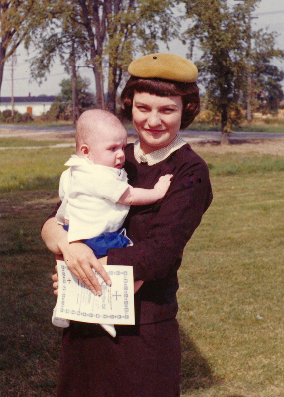

This one - showing my mother and my brother - is 60 years old:

Matt, the top photo, is that after correction? Looks like it could use a touch more magenta.
With ccd scanners I would make a 16bit raw scan with all correction settings and adjustments turned off. From there correct in photoshop. Any thing you do in the scanner app, with the exception of ir dust removal, can be better done in photoshop. Use layers for the best results. I also scan negatives as positives and correct in photoshop.
Yes - post correction.
In fact, there is so much correction applied, that I'm basically in "Spinal Tap" zone - "11" on the scale that goes to 10.
More magenta just makes it more weird.

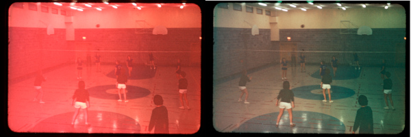

I have a different approach to creating digital images of faded slides.
I recently digitized my great-grandfather's collection of several thousand slides. Most were Kodachromes, and they looked great, but there were some Ektachromes that had faded badly.

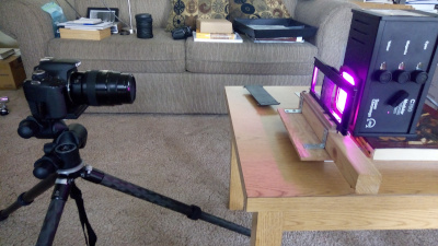

I use a macro lens and DSLR along with my colour enlarging head. Using the colour enlarging head on its side, it is possible to dial in the correct optical colour filtration to mitigate the severity of the colour shift. If a colour layer has faded linearly in relation to the other layers, this brings them back in balance so you have all three RGB colour channels properly exposed, which gives you the most room to do math on the pixels in your preferred editing program (I use GIMP, which is open source and free), since the image information is sampled properly (i.e. you won't get as many artefacts when you do major curves adjustments.)
Basically, your starting point can go from the faded red slide on the left (how the slide appears to my eye), to the image on the left, which has not been manipulated digitally by me. I just dialed up the cyan on my colour head.
