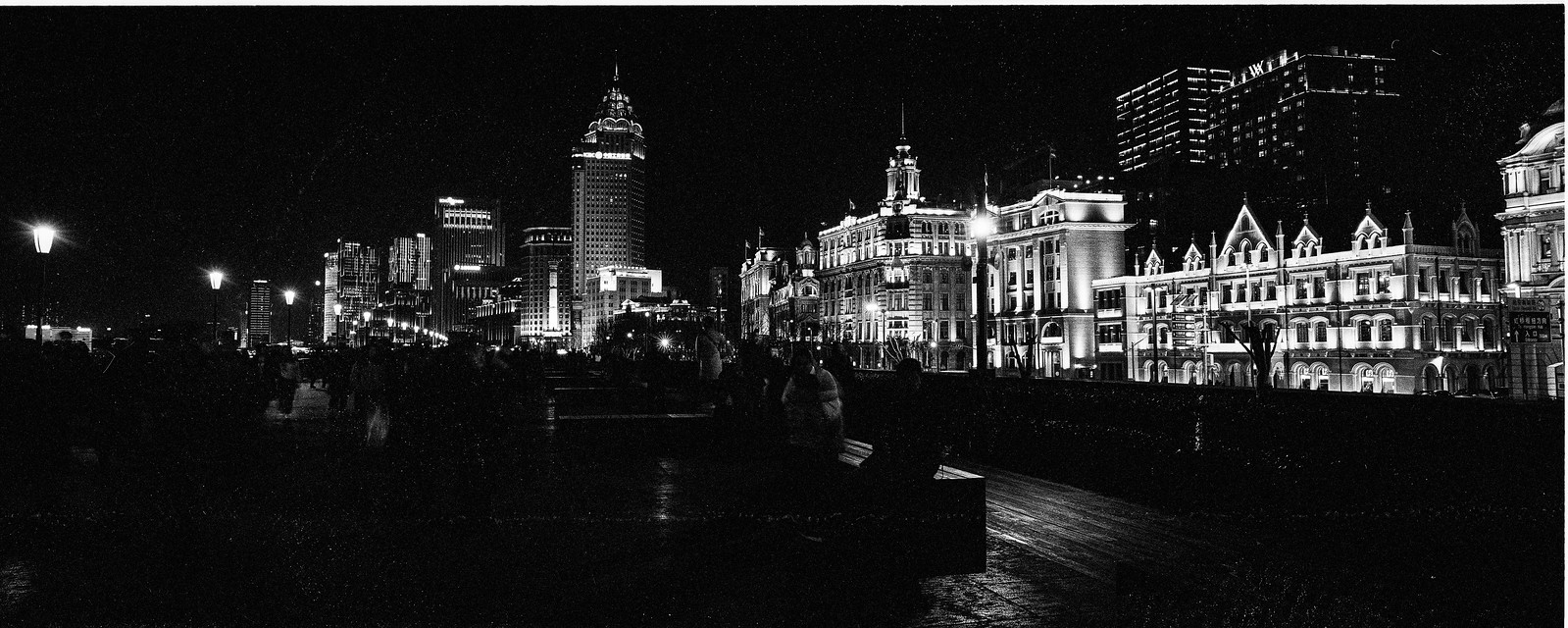

My most recent scans of film showed some very serious defects in image quality, that I initially thought was due to a problem with my development. As seen in the example below, there are all kinds of white specs on the scan (and every shot in this roll; similar lighting). Thankfully, I developed a second roll in the same tank and these images are from during the daytime, without much darkness at all. No spots at all on this roll. Same film, TMAX400, and the same developer, obviously being in the same tank at the same time.
So, I'm guessing that this must be some sort of scanning defect. Is my scanner dying or is this the result of some software error that I am not aware of? SilverFast is a very confusing piece of software so I'm not that great at it.
Thank you for your comments!

1st suspect: dust from the drying enviorment.
2nd. suspect dust in the scan path, under side of the scanner glass, mirrors, lens, sensor. Do not remove the sensor in any scanner for cleaning as its exact position must be reestablished to get accurate scans without distortion.
The dust is likely micro fine and not visible to the eye.

I developed 3 rolls of film in this tank. All films have been in the same condition. Only the film showing dark scenes shows these dots.

Have you inspected the film with a high power loupe to eliminate it? Lighter tones can be masking the dust specs.
What scanner? I've never known of a scanner or its software to add such to the scan unless you have ICE enabled on a silver based film. In post 1 you state its a silver based film.

I don’t have a loupe. Scanner is a Plustek OpticFilm 120.

I suspect you have drying marks on the negative and would recommend rewashing the negative. The dark images on your scan correlate to light portions on your negative. My experience is that my scanning process (OpticFilm 8200i and VueScan) tends to magnify drying marks, dust and fingerprints when scanning light negatives. Darker parts of the negative (light areas on the scan) and areas of high contrast tend to cover up such blemishes. It appears that there may actually be a partial fingerprint along the bottom of the image near the right side.
Using photoshop, the noise can usually be removed by adjusting the gamma of the image (I use the levels control for this) but would cause a loss of shadow detail which would significantly change the image.

Why would there be drying marks on this roll of film and none on the other two rolls? Surely drying marks appear on all types of film, not just ones containing dark images. This confuses me.
I suspect that whatever you are seeing is in fact present on the other rolls but not seen with the scanning process. I have noticed on rolls I have shot using Sunny 16 (or just wild guesses) that marks similar to this are only identified on significantly underexposed frames while properly exposed frames are clear. I suspect that the scanner/software combination, when trying to extract images from areas of very low negative density tends to amplify irregularities on the negative. I have multiple scans of my own which suffer from the exact same defects as you noted on your scan. Sometimes rewashing the negative helps (or at least moves the marks to new places).

OK, thank you. I have purchased pure water to use during my washing stage to see if this helps with the situation. I dont know if the film I have left to develop has as much dark area as the roll that showed this problem initially.

In my experience, very thin areas of a negative, especially a generally thin negative, will result in the scanner (and software) trying to make detail out of whatever variations it can find. That can lead to seeing every microscopic scratch, dust particle and smear in existence showing up. (Try scanning a blank hunk of leader sometime with the scanner playing 'automatic.') On a more "normal" exposure of a typical daylight scene, the microscopic physical defects are suppressed because their densities are outside of the range for the important parts of the negative.

I like your theory, which means that what I am seeing is normal. However, I need to be able to scan these dark negatives so how to tell the software to tone down the amplification of the signal? I am using SilverFast AI Studio 8.

I use Vuescan, so can't give any step by step, but in general if you set the white point and black point in whatever sort of manual mode is available you can move the scan range around and expand or contract the range. (At least some, obviously there is no infinite variability.)

Get a bottle of PhotoFlo, use it in the final rinse. 1/4 to 1/2 cap full should be enough to get the water to sheet off without leaving marks or mineral deposits. The amount you need will depend on your water supply and tank volume.

I do use Photoflo. I'll also try out your scanning exercises and see if I can learn that way. Some adjustments seem to do almost nothing so I'm not sure what they are meant to do. The names do not give any indication.

Make a cover for your drying area. 3mil to 6 mil plastic that extends 10 to 12 inches either side of the hanging point will protect a 36 exposure strip of 135 film/ roll of 120 film.
The specs you are seeing in your scan is the fine particles that fall off the ceiling above the drying area as the occupants move about on the floor above and or the fine dust in the air from a central air circulation system (air condidioner/ heater). Textured ceilings are some of the worst.
Eliminate air flow in the area while the film is drying also.
