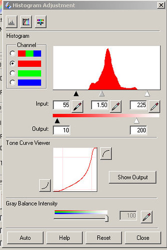

Getting back to addressing the other issue:
Scanning in Neg mode on the Epson software (as I said earlier) makes the scanner work differently and drives the capture of data differently. Essentially its now NON LINEAR. So any adjustments of levels (black and white points) introduce curves as can be seen in this screen grab
scan-fig1 by aquinas_56, on Flickr

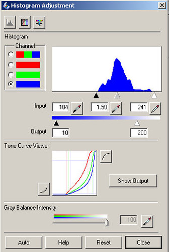

and also this screen grab
scan-fig2 by aquinas_56, on Flickr
so if you have a grasp of integer maths you'll know that you're getting different numbers which are unrecoverable in the same manner by "undoing" that curve.
so as I said in the start, you do get different things.
