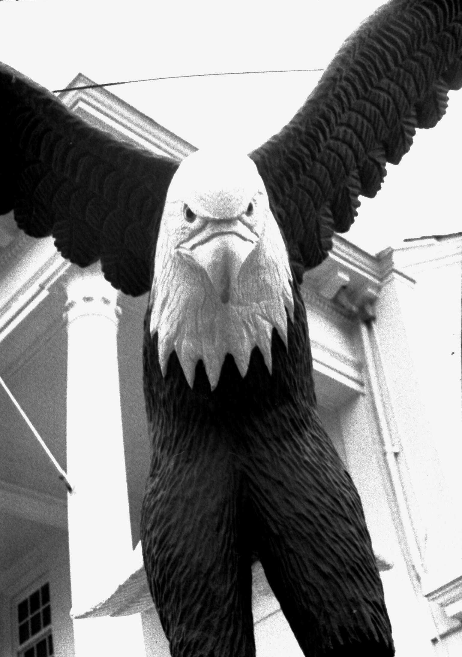

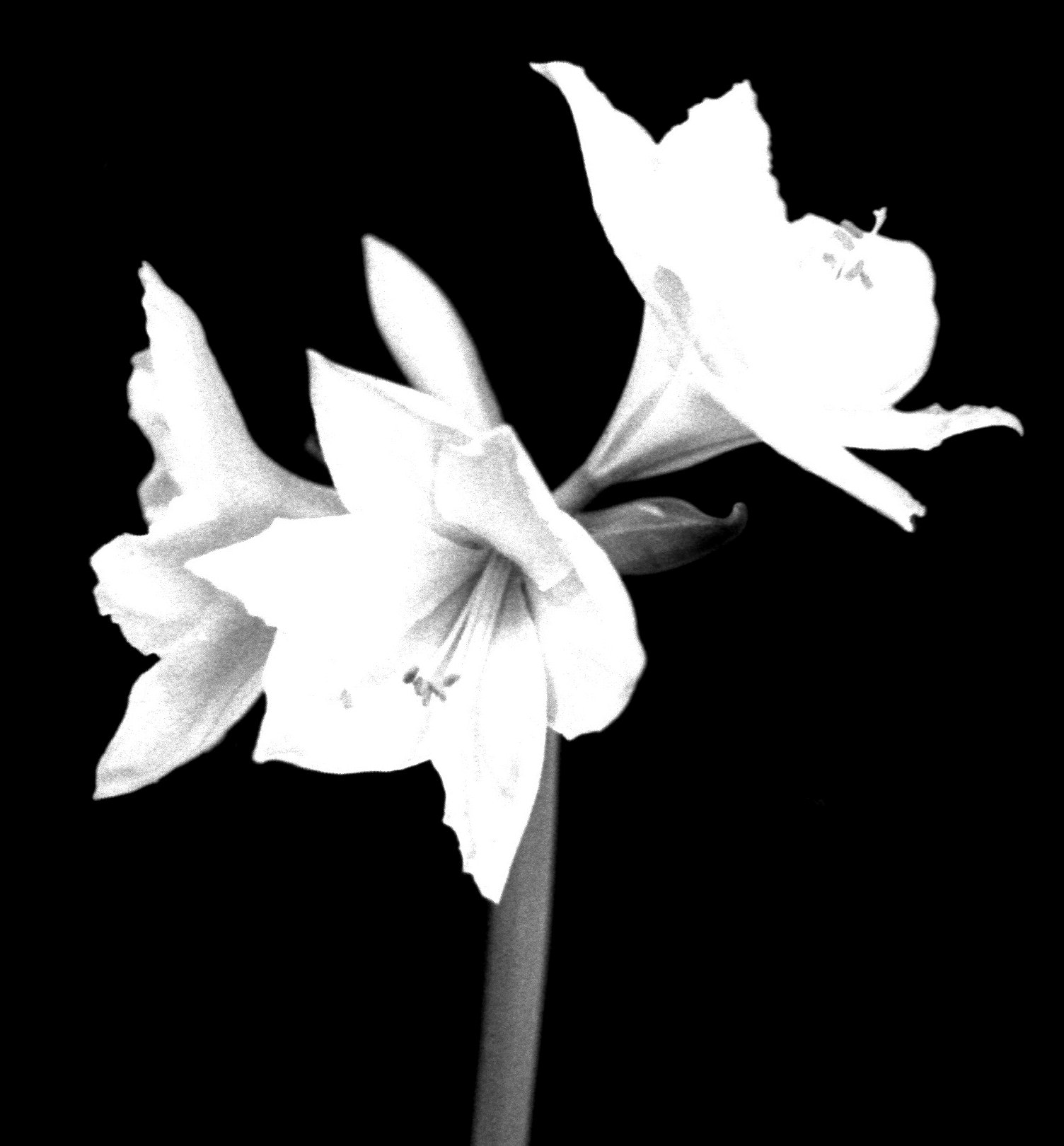

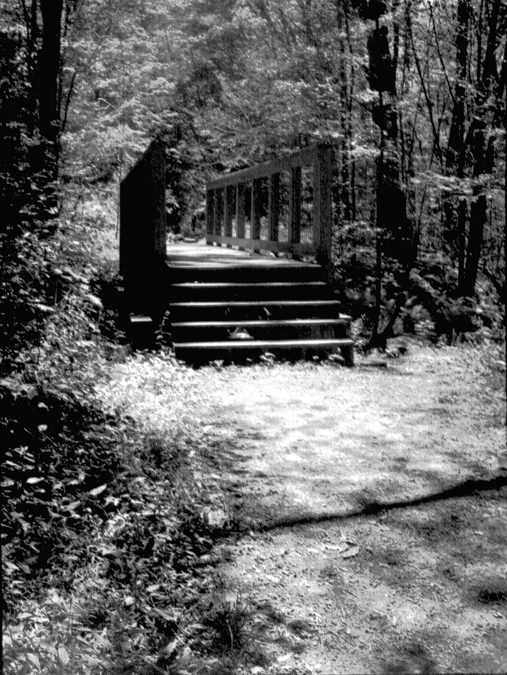

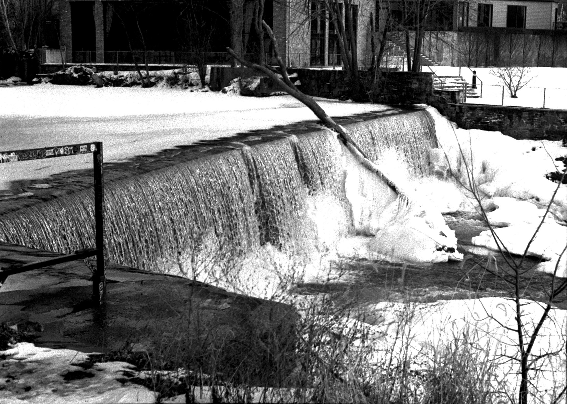

A crude jury rig? Yes. But with careful fiddling, it works okay a lot of the time. Here are examples, 2400dpi scans of Double-X negs from my Pen F and Pen S:
icedfallsDouble-X.jpgamarylisDouble-X2.jpgeagleDouble-X.jpgSchoolMtnRdTrailBridgePenS.jpg

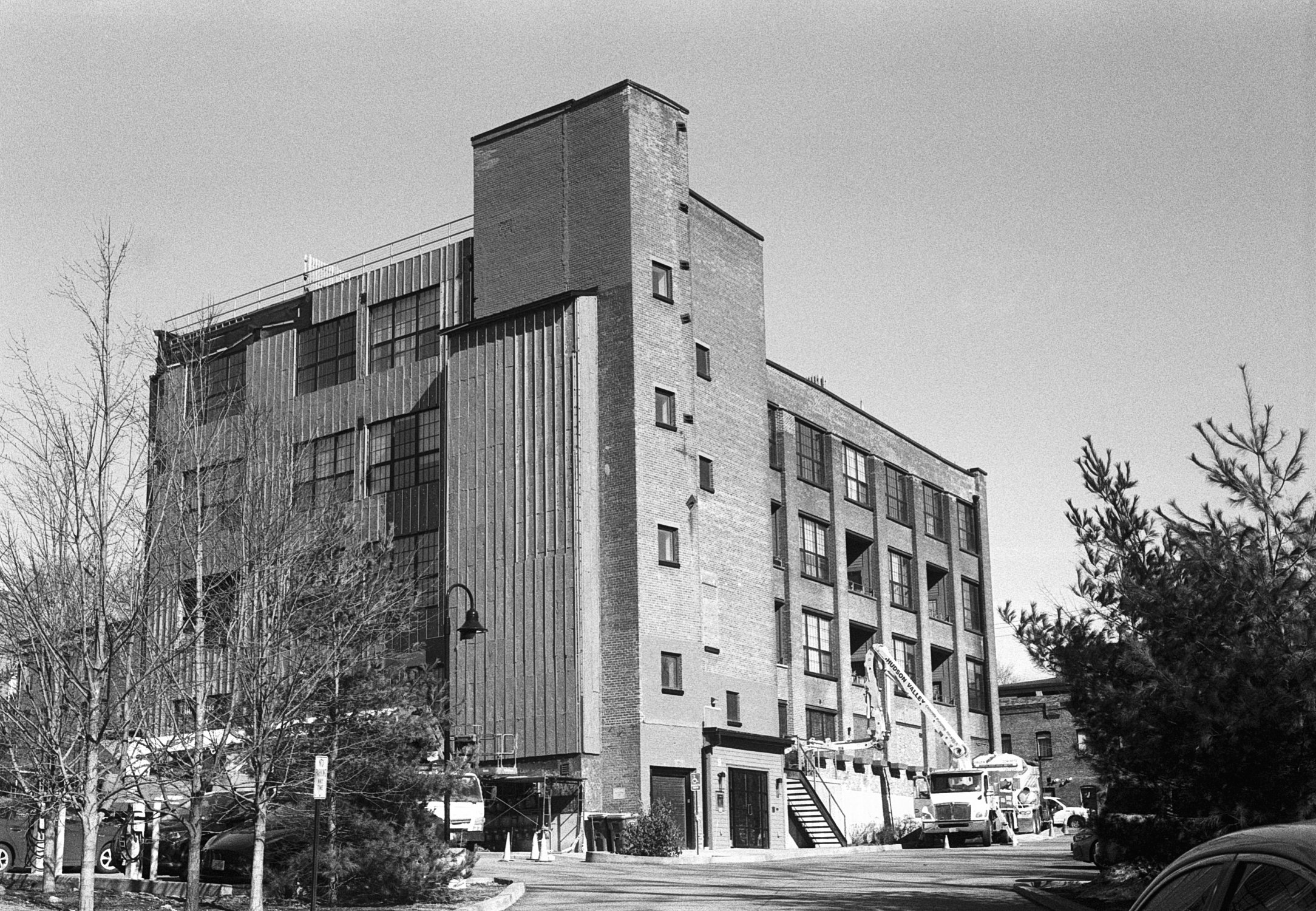

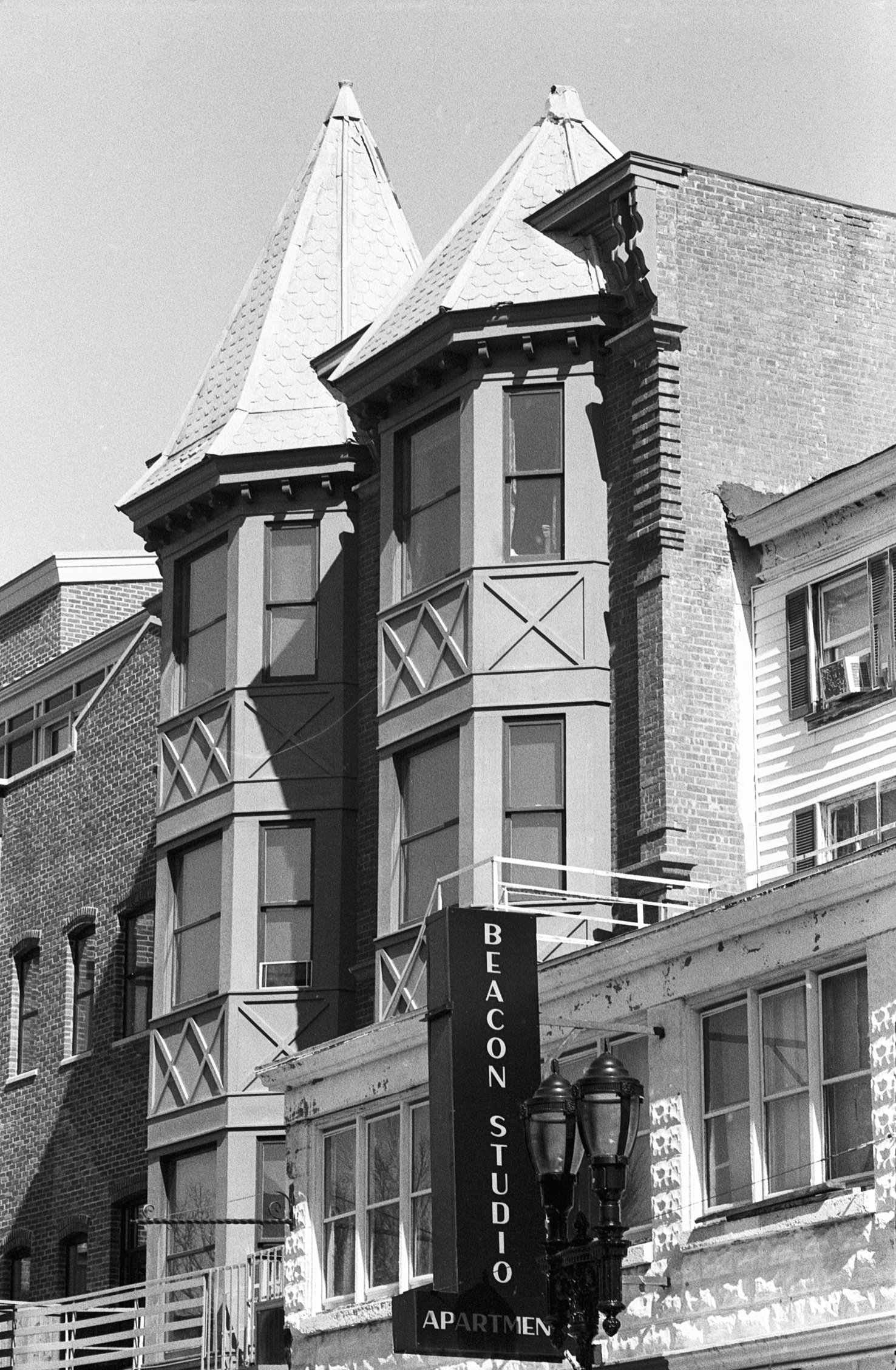

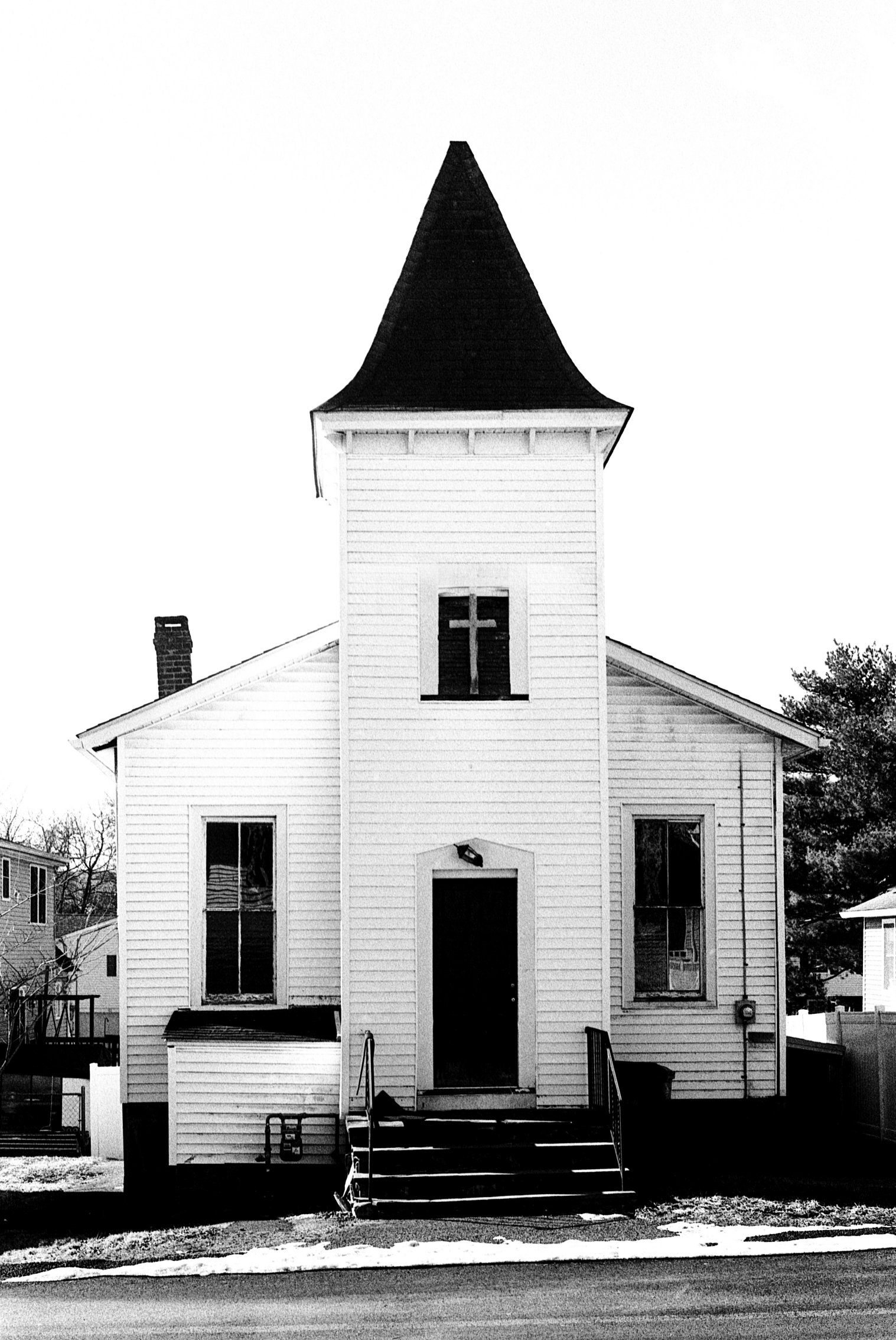

I usually just use Double-X in half-frame, though I also shot some in my Nikkormat this year for a then-and-now exhibit of Beacon, NY (as an industrial river town in decline back in the 80s to its current renaissance as a thriving artsy community). Here are a couple - note that these are pro scans, my own scans weren't sharp enough for big exhibit prints:
I shot these with classic non-AI lenses that my folks got back in the sixties and early seventies, which had hard use for decades, then no use for decades before I began using them again in the last five years.... but none has ever needed a CLA! The church with the 35/2 (this one vintage 1972), the industrial building with the 45/2.8 GN (1969), and the towers with the 105/2.5 (1966). Man was that old Nikon gear well built!
