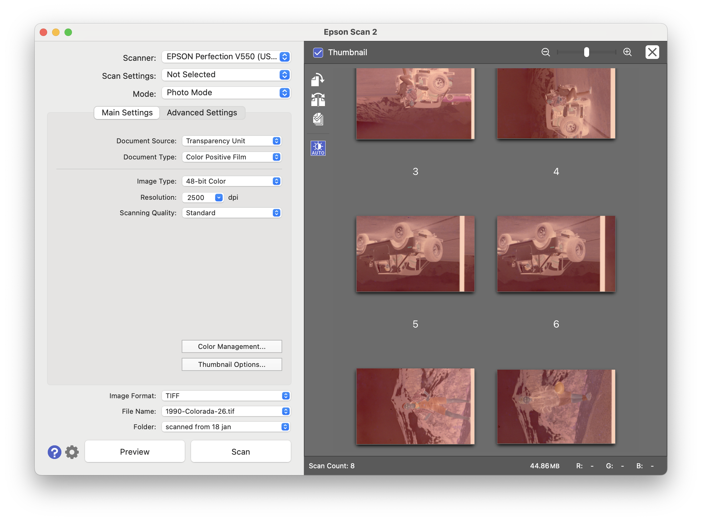

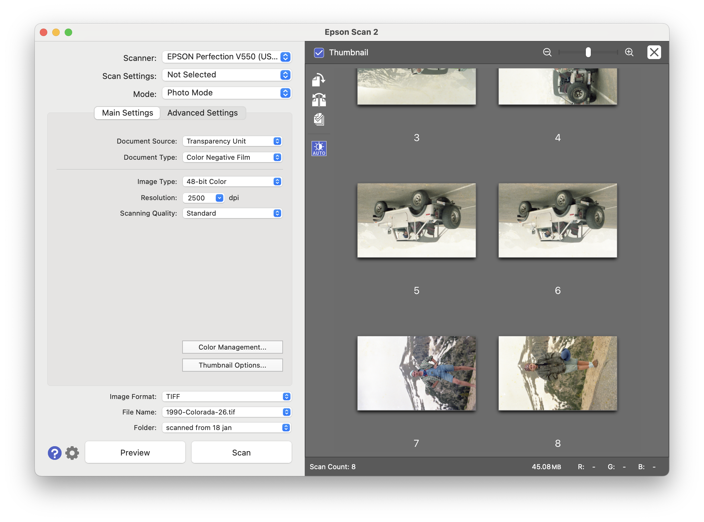

I just started scanning old negatives and have mostly 33mm b/w, but some color as well. I have an issue that when I scan using Color negative Film as document type, it initially scanned the individual photos as negatives, but now it scans them as positives - and vice versa for scanning as Color positives scans as negatives. (like attached photos)
Also, the files previewed as negative film are cauing the borders to be off, whereas they are fine when scanning as positives.
Any suggestions on what I'm doing wrong?

Notice the jeep, on the negatives they have crop marks that cut off the front space of the image. I guess that is the real issue.
It would appear that the frame detection algorithm in the scanning software is less-than-perfect when processing a negative. Are all negatives effected or just these frames in particular? Some frames may be more susceptible than others.
My advice would to be to (1) check for any updates available for the scanning software, (2) go into 'Thumbnail Options' and change the cropping area setting, and (3) slightly reposition the film in the holder, if possible, and rescan to see if the software correctly identifies the frames.
Epson Scan 2 is a dumbed down scanning application on Mac. If you can't force it into a mode where you can manually select frames (Thumbnail Options) you will probably need to start looking at Vuescan or Silverfast...
What happens if you disable 'Thumbnails'?

Epson Scan 2 can be real finnicky when it comes to creating thumbnails. If it continues to misalign the thumbnails, or cut off part of the image, I would suggest going into the "thumbnail options" button and increasing the size of the thumbnail. This will, of course, mean that you will be scanning more than needs be, which could lead to incorrect color parameters if you're setting it to automatic, and that you'll have to crop later, but beyond manually setting the scanned image size yourself for each individual negative, I've found no way around this in Epson Scan 2 software.
As tempting as it is to use Thumbnail mode, I get better results using "Normal" mode under the "Professional Mode" option. You can create frames and save your settings. You then can just move those frames around to line up with your frames after you preview This has the added benefit of not losing your various settings such as Unsharp Mask, Color Restoration and Digital ICE, which get reset when you use thumbnail mode. I'm using the Windows version, but I suspect the Mac version is pretty similar.

From your screenshots it looks like it's working fine. If you scan a negative as a 'Document Type' positive (or slide) it will come out as a negative (top example), just as a slide would come out positive. You are simply keeping the negative as a negative. Is that what you want? If in the second example you change Document Type to Color Negative film Epson Scan converts it into a positive for you, which is normally correct. As for the cropping if you are scanning a colour negative in a 35mm negative holder as a slide (top example) I would assume the software is thinking there's a slide in a slide mount and is trying to compensate for the slide mount.
But it looks like scanning a negative works perfectly if you set the machine to 'Color Negative' so why worry about how it turns out with odd crops when the settings are wrong anyway?
