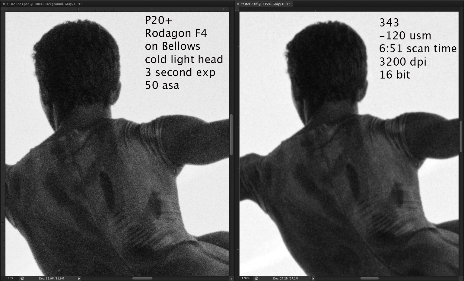

Dear Larry, great research and thanks for the info-
With the diminishing fortunes of film scanners and Hasselblad's 4-6K rebate program I wanted to ensure I could scan all my film properly and seriously considered an upgrade from my 343, but for a lark I tested my Phase One P20+ on a bellows with an enlarging lens, even used the cold light head as a source, both files unsharpened, the P20+ file was inverted in PSD and then slight s curve in adjustments unlike your approach for treating the files as you import them which I tried and the Histogram looks very similar to the 343. One question should you not have the enlarging lens on backwards in the photo of your setup?
Glad it's working for you. How's the resolution vs the 343? (Edit, I missed the attachment when I posted - it looks very good).
As far as reversing the enlarging lens goes, that will depend on the lens. The one (75mm Rodagon D) I am using isn't really an enlarging lens; it's more of macro/copy lens and designed for 1:1 reproduction. So in this case it shouldn't be reversed, but in general I think most enlarging lenses should be reversed for 1:1 copy use.
Apo-Rodagon-D
Platonumb
Mar 6, 2007
10
Larry the resolution- i liked the P20+ better and possibly your D800 method with the 36MP vs 16 is better again,, is it possible "the king is dead" if so "long live the king".
Cheers Platonumb

Amazon.com: Opteka HD² Slide Copier for Canon EOS 1D, 5D, 7D, 10D, 20D, 30D, 40D, 50D, 60D, 60Da, Rebel XT, XTi, XSi, XS, T1i, T2i T3, T3i and T4i Digital SLR Cameras: Camera & Photo
That would hold the film level to the lens and the bellows would allow it to focus closely enough?
I think I may go with the nikon version instead since it doesn't have any cheap glass in it.
Amazon.com: Nikon ES-1 52mm Slide Copy Adapter: Camera & Photo
Am I thinking this through properly?
