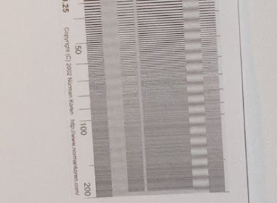

Okay, I did a little experimentation.
I got out my SMPTE test film for the movie projector and scanned it. I also found some film put out by Lucasfilm for the THX Theater Alignment Program.
JPEG scan of SMPTE film........ JPEG scan of THX film:
On both test films I was able to get approx 40 lines per mm of resolution off the film:
SMPTE.............................. THX:
If I was using this information to judge the quality of a movie projector, I'd be disappointed. The minimum resolution you should expect to produce is 48 lines per mm. On average, a projector should be able to produce 56 lines per mm and, if you are willing to invest in good lenses, you can expect to see even more.
If these were projected images in my theater I'd be telling my boss that I've got work to do! :wink:
40 lpmm is not so bad! Unless you use a sturdy tripod, mirror lockup, careful manual focussing and a damn sharp lens, the scanner won't really be your limit! The nice thing about film is that you can always move to a larger format if you really need more detail.
Sandy

Oh I agree completely and this of course brings up something that has many confused. I have a few cameras here and of course have done lens testing and film testing. There is lens resolution and film resolution. People often get these two confused.
However in a nutshell my point is that with larger film area you can have less of both and get sharper images.
Less film resolution is assisted with larger formats for the obvious reason of increased capture area and therefore decreased magnification on a given print size.
Less lens resolution is not as obvious, but comes down to how lens testing works. Targets are photographed at a function of lens focal length. So a 100mm lens will be photographed at a greater distance than a 35mm lens. Now as it happens on 6x9 film a 100mm lens is about the same angle of view as a 35mm lens is, but the working distance of reglar photography means that you will never stand as close to your subject to get the same view as you would locate your camera for lens testing.
When you place both cameras at the same distance (6x9 and 35mm) you'll end up with more lens line pairs per mm on the film or sensor.
24mm lens on a 10D camera:
which will give an effective view of a 100mm lens on a 6x9 camera.
but with both cameras at the same working distance that was required for testing the 100mm lens ...
we get a usable sort of image for this sort of photography... the smaller format ended up only showing about 1/2 the detail captured by the 6x9 camera:
so there are other advantages in larger formats, you need longer lenses for the same angle of view.
