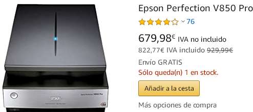

If you plan to scan film in the long term then I would recommend the V800 or V850, in my country Amazon sells the V850 today for 680€ plus VAT taxes. B&H and Adorama have ir for $1150, I don't know why presently it is that expensive in the USA, low stock bacause of covid manufacturing issues?
The V800/850 will make 4x5, so it's an investment for the future. You always can start with the cheaper V600 that will be ok for many situations, but the V800/850 is a better performer and it includes better ANR glass holders, allows to better recover deep shadows in dense slides and it includes Silverfast, the V850 has the Silverfast SE plus version allowing multi-exposure (https://www.silverfast.com/highlights/multi-exposure/en.html), The V800 requires upgrading the Silverfast version to have multi-exposure.
The V800/850 on the paper is not as a good performer as high end scanners, but most of the times it reaches enough performance to take all what film has in practice, so a better scanner has little advantage, or no advantage at all, specially for MF and up.
The V600 is consumer level, the V800 is prosumer level, but none of those are Pro level, still one may get perfectly Pro level quality from them if being careful in the scanning and proficient in the edition. Epson scans always require a wise edition to get most of it, while a pro scanner usually delivers a very well optimized image. See this https://petapixel.com/2017/05/01/16000-photo-scanner-vs-500-scanner/
With the V600 it's even more important to perform a wise scanning/edition for optimal results.
