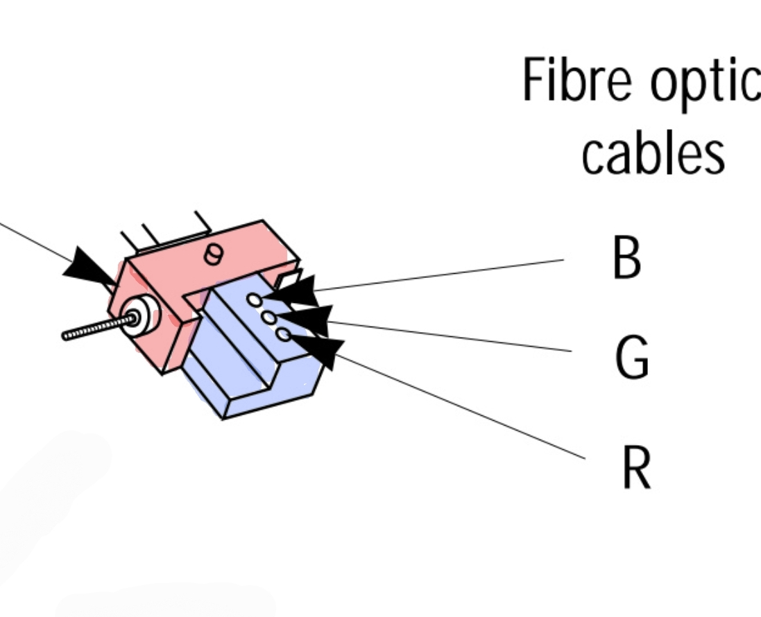

Yes, the pots are variable resistors you can adjust with a small screwdriver. On the 5000 they are appr 10x5mm blue boxes with a screw on them. They are placed on the larger box that contains the PMTs.
Thanks - I'll take a look at that. Before I adjust anything though... is there anywhere else I should look - for anything that could block light for instance when using the smallest aperture? I tried to se if I could find the actual apertures but I am not sure where they are. I have not opened the larger box that contains the PMTs yet though.
There is an aperture plate in the light path. I think it's spring loaded and a motor moves in position (to select the aperture).
You can remove the aperture plate and clean it with a solvent. If a speck of dust is caught in the smallest apertures it can give strange results.
Yes, if it's anything like the 5000 I think the plate is inside the red part. I remember the allen screws took some force to remove.
If you remove the aperture plate, remember to make sure it's correctly seated when you put it back. I don't think there are any sensors stopping the motor if the plate gets jammed.
I get it. It's not like you can easily buy a replacement part if something breaks.
I was afraid of breaking the fiber optic cables. They get pretty inflexible when they're this old.
