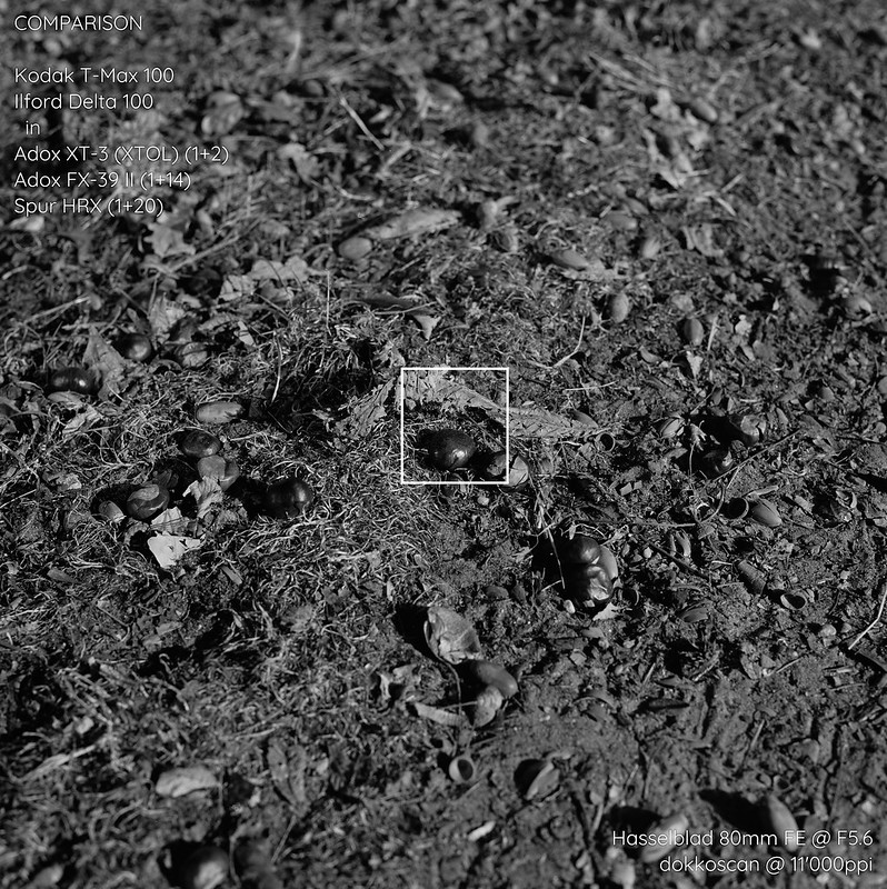

I recently did a comparison of Kodak T-Max 100 vs Delta 100 developed in Adox FX-39II, Adox XT-3, and Spur HRX. Since the discussion involved scanning questions, it was suggested that I'd start a new thread in the scanning forum. The original discussion with the detailed info about the film development can be found here:
I scanned the films at 11'000ppi on my custom built scanner. to make things easier to see, I've created a animated gif at 200% scale since many people will watch this on a high ppi screen (open the link below in a new window for larger display size). no digital sharpening has been applied:
individual jpegs can be found here (go to download → original size for the unscaled unsharpened version):
I've also created a layered .tif file with all the samples in one file:

my scanner is a proprietary custom build machine that I've spent more time and money on than I would like to admit to myself, so unfortunately I can't share specific details.
But I'm happy to discuss different scanning methods in general and share my findings about the various challenges.
there's really nothing groundbreaking in the general principle of my scanning method itself though, it's just a light source, a lens and a sensor, like nearly every other scanner (apart from drum scanners, which by now are 20-30 years old).
the problem arises once we want to get more than 5000ppi in resolution, everything gets very difficult very fast. it needs extremely careful optimisation and very expensive components. for example, only the components of the optical system of my setup cost about 40'000 EUR.
as a comparison, the Imacon/Hasselblad scanners, that sold for up to 25'000EUR until 5 years ago, uses a lens worth around 1000EUR.
here is a comparison of a 35mm negative (Adox CMS 20 II) scanned on an Imacon 848 at 8000ppi and on my dokko scanner at 11000ppi, scaled to the same size for comparison. first the overview of the full frame with the crops that follow marked in red:
my scanner at 11'000ppi:
and the Imacon at 8000ppi:
(as a side note, the distortion of the Imacon scan comes from problems in its line scan mechanism).
as I mentioned in the other thread, my scanner is able to scan up to 40'000ppi. However, such an extreme resolution is usually not worth the effort since is very time-consuming and doesn't always result in a better looking image. I found that the sweet spot for extremly large prints is around 10'000-20'000 PPI for 35mm and 7000-14'000 PPI for medium format and large format film.
the main reason why I started this endeavour was because I was frustrated by the digital scanning artefacts of the existing scanner models and wanted something which kept the organic nature of analog film in a hybrid workflow, even on high enlargements.
