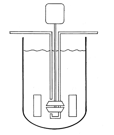

Avoid foam at all costs. It can distort the emulsion precipitation reaction because it can force crystals to form on the surface of the bubbles which is ungood.
For mixing, we used a PEPA or Planar Emulsion Precipitation Apparatus.
Attached is a rough depiction. I have a better one somewhere, but can't find it right now. Basically, it consists of two parallel disks with holes in them. Solution is added above and below, and mixes in the gap between them and is then spread out to the sides. It is sometimes called a spreader. There were probably up to 4 generations of these used at one time or another.
PE

Ron, funny coincidence in that I was thinking of a similar approach if needed, whereas a tube (tubes, actually) would bring the silver solution from the multiple parastaltic pumps down to near the mixing head on my stirrer. I come here to find your illustration.

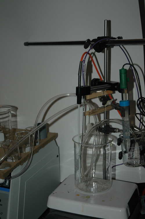

2x scaling setup. Two peristaltic pumps each set for 40ml / min to precipitate all the silver nitrate in 10 minutes. 2-channel ower supply on the right. The light source on the left is a red LED lamp that doesn’t fog plates after at least an hour exposure.
Not easy to see, but the tubing coming from the pumps are on either side of the mixing motor. You can see at least one of the streams of silver nitrate flowing into the solution. Thermocouple on the left for the PID controller which I use to control temp of the water bath and thus temp of the solution.
I was able to replicate the temperature timing of my smaller batch size with ease (in fact it cooled down slightly faster). Currently in the lab/beer fridge cooling down to set for washing tomorrow night.

Nice setup. I used a timed syringe addition or a pump, and was very careful. Things worked out for me.
See my setup in the book. If you missed that, I can post some of it.

Here is the whole thing. Included in this is the vAg electrode setup with salt bridge and the pump with holder for source beakers. No mixer is shown here.
PE
Thanks for the photo.. I'm proud to say I can actually make sense of that setup.

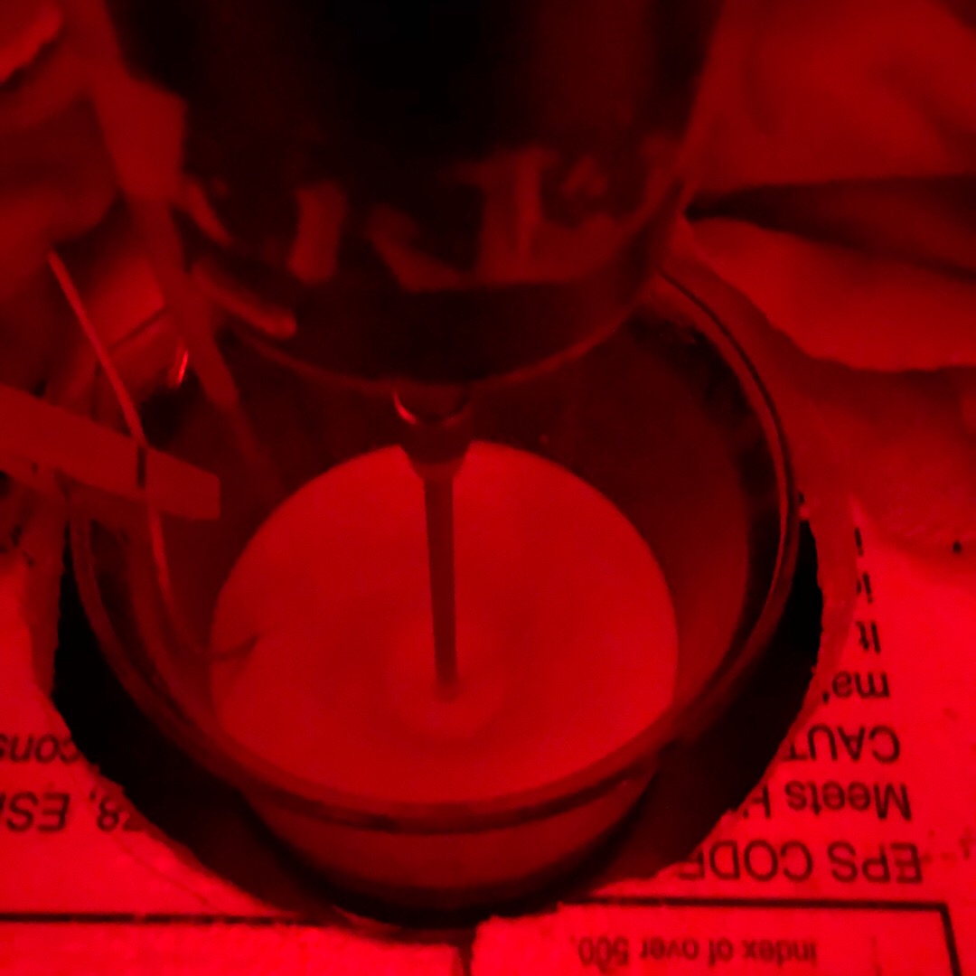

For the latest batch, I rigged up to do under-the-surface precipitation. I connected my paristaltic pump tubing to straight glass tubes so I can inject silver nitrate right at the stirrer.

Sub-surface precipitation seems to be a good move. i have scaled from 100ml to 500ml without problems that way. Did you ever figure out how to measure vAg? I built the salt bridge and electrodes described by Ron and had success with it working. Controlling vAg is another matter entirely!

I took some test plates but didn’t have a chance to scan them before I went on travel. They are a little slower than previous plates..I think my precip/first ripening temps might be a little low. My temperature sensor needs recalibration.
