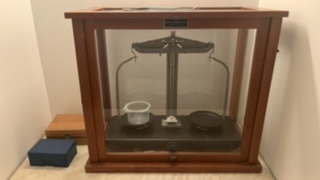

I’m certainly not claiming this is better, but I use an old laboratory beam balance. I got used to these at school, and I enjoy using such a simple device that is nevertheless highly effective. My wife got this one for a couple of pounds at a boot sale. Extremely sensitive and repeatable, and plenty precise enough, but accuracy depends on the quality of the weights used, so you need to be careful over that.
