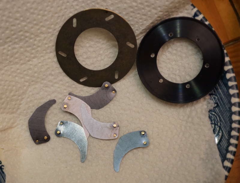

I won't argue that this works, but I have always recommended a proper dismantle and cleaning of the mechanism. Soaking the blades and moping up the residue can remove most of the resinified grease/oil from the visible parts, but the same solvent also drives the unwanted oils deeper into the mechanism, and after the solvent dries, the mechanism will start showing issues again. But you do buy a year or more, depending on how the rest of the mechanism is like.
A full dismantle is not that hard, and you can properly clean to parts that need to run dry, remove the old oils from the clock work mechanism and re-lube it (sparingly) with a light long lasting oil. I have been using an ultrasonic cleaner in the last ~10 years, which speeds up the process.
This is the aperture part, I don't have a picture handy of the shutter disassembled. But done this way, the mechanism is good for a decade or 2. As long as you did not put too much oil on the clockwork - as it will migrate into the blades otherwise. I believe that over-lubing the clockwork mechanism by previous service personal is responsible for many a stuck shutter/iris.
