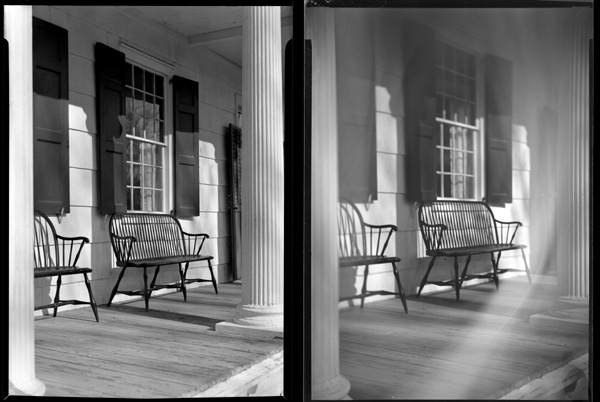

Anyway, It looks like this shutter is going to have to be replaced. The attached neg scans show the difference between the 10" Rapid Rectilinear (on the left) and the 10" Petzval. Both shot from the same camera position, the RR was exposed 1/50th @ f/16, the Petzval 1/25th @ f/5 with a 3 stop N.D. and a light yellow filter. The RR is quite a nice lens, it'll be even better once Carol CLA's the Unicum shutter.

The RR is pretty good!
Thanks! Wait 'til you see the glass on this one, it's pristine...

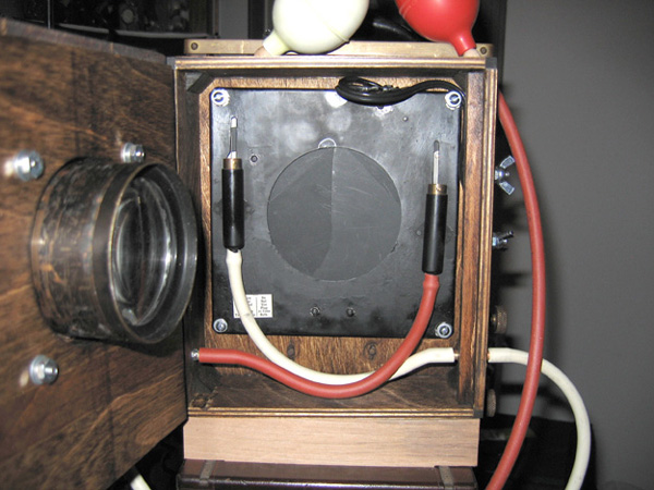

I resolved the light leak on the #8 Packard by making a rather large box lensboard. Seems that a shutter that large (3.25" opening) doesn't like being out of doors and hanging in front of the glass - the slightest breeze will move the blades and wham! - light leak.
Anyway, I made this box different from past projects, I made it with a hinged door on the front. The door is 1/2" Baltic Birch Plywood and has a 1/4" wide, 3/8" deep rabbet all around, so it's light tight. So far, the shutter has passed the light tight test - a strong flashlight held about a foot in front of the lens shining straight in. From the back, nothin' but dark! As you can see in the attached pix, I have some more work to do to the lens. I'm going to remove the lens cells and re-blacken the inside of the lens barrel, then blacken the outside of the barrrel where it protrudes into the camera.
I took the doublet out of the front cell and used a gel-type super glue to attach a 72mm filter ring inside the brass hood. Since the Packard has one timed speed, I'll use ND filters for more precise exposure control. The ring and the inside of the hood also need a re-blackening.
The flash sync connections exit the side of the box via #8 machine screws. Wing nuts on the outside of the box allow attachment of a cord with a household plug.
The piece of walnut under the box is temporary. It's just supporting the weight off the front standard until I finish my permanent brace.
Anyway... Jim Galli - you created a monster!

The old girl never looked so good Bob. She's citified. How do you keep track of all that plumbing. I've seen less piping under the hood of a new Audi. :D:D
After seeing your pictures, I wonder if you have ever seen under the hood of a new Audi.
A really old pickup, now, that is a different story...
