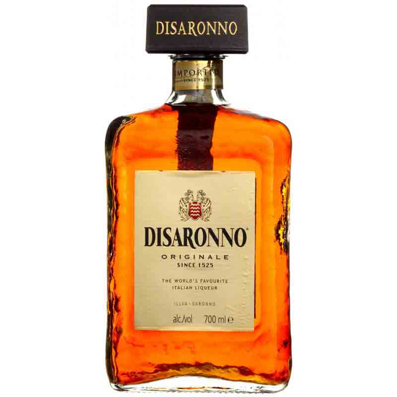

Well, my favorite are Deseronno Ameretto bottles. The square shapes are easy to hold even with wet hands. They seem to be amber when you get them, but they soon are clear. I don't worry about that because I leave my darkroom dark when I'm not in there, so there's no light affect.
They are 750ml, so when I mix one liter, the first bottle is full, so no air. The second bottle is used first. I have had no problem with my Microphen this way.
