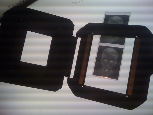

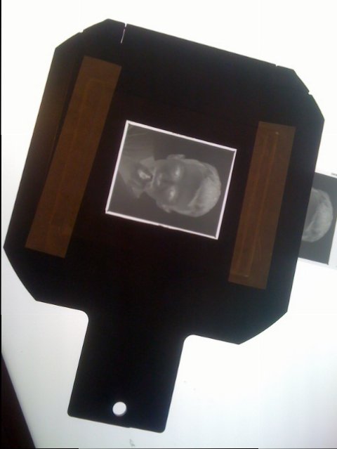

Here's how I use my 4x5 glass carrier with a black plastic mask for printing 6x7 negs with the film border:
The plastic mask can be flexed to tuck into the grooves on the long side of the carrier. A little strip of black and some masking tape blocks any stray light on the short sides. It's easily removed and changed to another size, if needed.
PecPads are the bomb for killing dust on the glass and negatives!

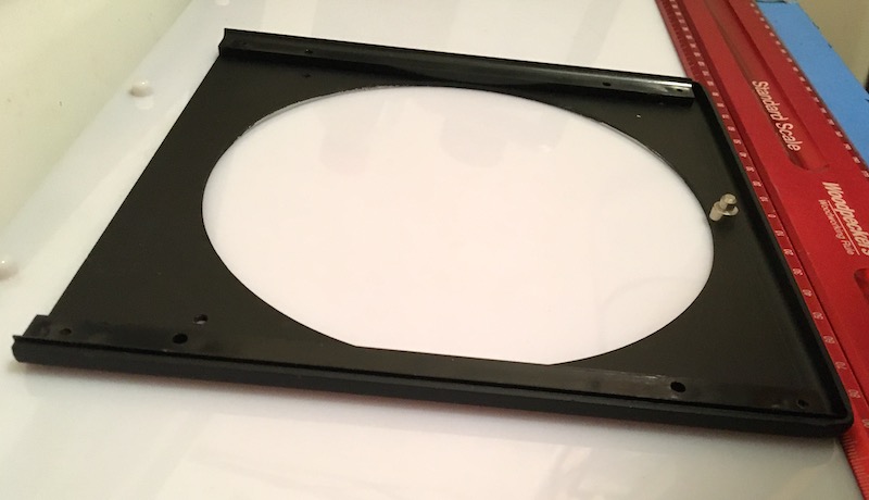

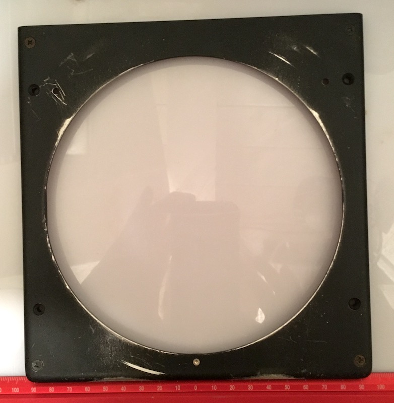

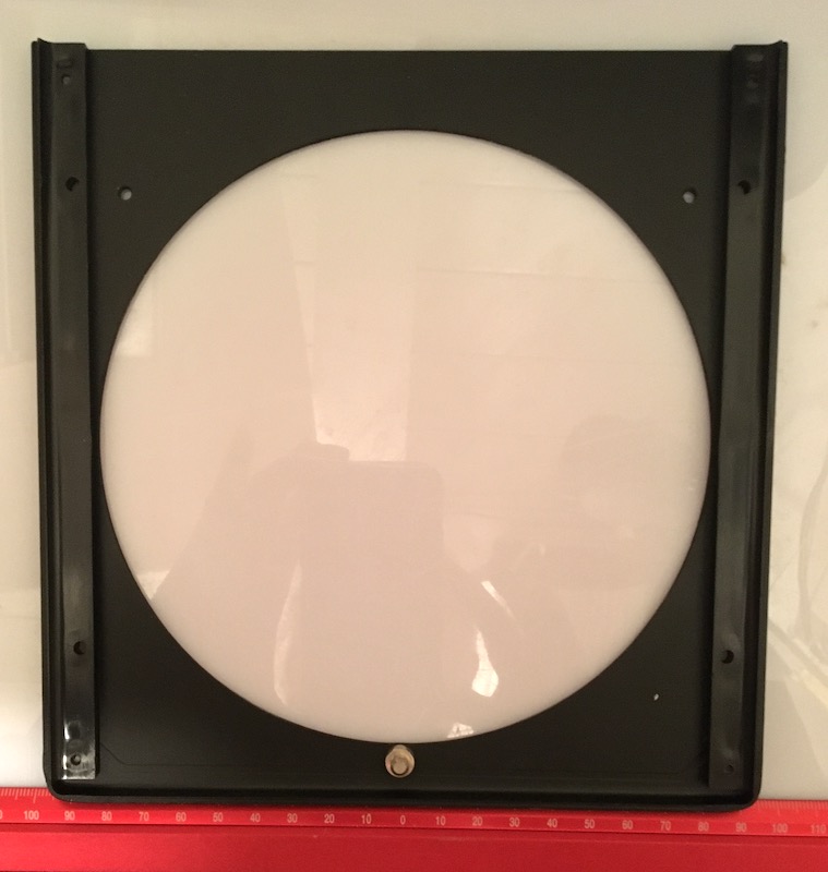

Can anyone post pictures of the negative carrier plate, please? All I found is the small one posted in my previous post. Maybe a top shot, bottom and sides?
let me know if you want more/different pictures
Top
bottom
side
front
Thank you so much. These are very helpful! If I can trouble you for one more shot. An closeup on-edge shot of the bent edge and rail. There seems to be the bent edge, the plastic rail and another lip I can't quite make out.
