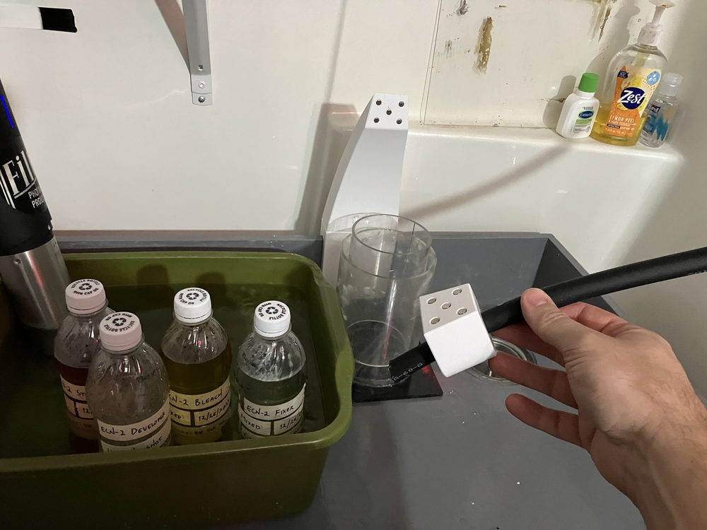

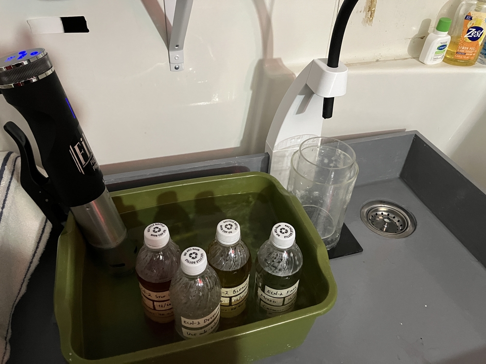

The one thing I missed having after this darkroom remodel (besides just putting this sink in, I also pulled out a toilet and pedestal sink to reclaim floor space, and built a proper stand for my enlarger), is a faucet. I pulled off my shower head and replace it with a Tygon hose that gives me mobility to put water anywhere I might want it in the sink. But I didn't have a way to anchor the hose somewhere for hands-free use, like washing my hands after a darkroom session. So I spent some time over the last couple of days modeling up, 3D printing, and assembling a little "faux faucet" that simply sits over the lip of the sink. It can slide laterally to reposition it, and the hose goes through a magnetic collar that can easily clip onto the "faucet" so it behaves like one. But I can also just grab it and use it as a hose when necessary. I'm pleasantly surprised with how well it worked on the first try; usually with projects such as this, I end up having to tweak and re-print parts to get proper fit and tolerances.

I'd post pictures, but I took a couple with my phone, resized them down to about 300kb each, and when I try to upload, I'm still getting an "uploaded file is too large" error from the forum.
Resize them to jpegs, 80 quality, 1000 pixels on the long dimension.
Ah, it was a dimensions problem rather than a filesize problem. Thanks.

Just by way of closing the loop here a bit, I've been using this sink extensively for nearly 11 months now with zero issues whatsoever. It has been really great to have a proper sink in there.
Reading through this thread, it appears there were many good ways to skin this cat. The one I went with may not be optimal for various reasons, but it was inexpensive and is working really well.
