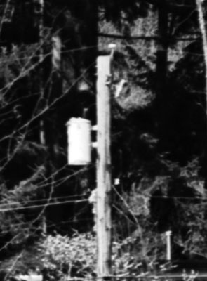

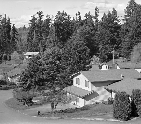

First of all let me thank you for letting me participate in the testing of the developer. My main film is Fp-4, but I also tried it in Acros, tri-x, and T-max. This is the first time I have tried T-max since I gave it a shot when it first came out. Using -P I would say my opinion of it has moved up to I don't care much for it compared to Fp-4. That's up from deciding whether to defile my trashcan with it. With Fp-4 as a base, I have observed noticeable but not dramatic differences. For the same developing procedure I find –P builds more density than –HD. For me dropping my developing 1.5:1:200 time from 23 min semi stand for –HD, to 20 min for- P made them equal.( negs keyed to Azo ) Comparing the two, they are very close. But each has it’s own flavor so to speak. I could be very happy with either one.
As far as grain, it’s a little different also, I put a 4x5 Fp-4 neg in my 8x10 Salsman enlarger and put an 80mm lens under it. I was able to get about a 15X magnification. Even then grain was hardly noticeable. With my peak1 grain focuser I was able to see the grain structure. Edge definition, is so close, decisions on differences would be subjective on the part of the viewer. I would say that grain structure is the biggest of the very small differences. Viewing thru the peak grain focuser –HD structure has a pattern similar to reticulation in the emulsion. This is not unusual. -P had a lot less of that pattern and not large but noticeable increase in the coarseness in the grain. A little more of a sharper grit to it so to speak. I find this a positive. Remember, this is looking at a 15X enlargement with a grain focuser. At that enlargement, a print had the grain that would be apparent in say, an 8x10 print from 35mm 200 asa in d-76. Less than would be observed with tri-x 35mmm to 8x10 print.. It’s the first time with pyrocat that I haven’t had to use my grain focuser as an image focuser. Then again I haven’t gone under 4x5 with it.
I am now in the process of working up a developing time for my 4x5 condencer enlarger.
What’s the biggest difference in -P over –HD? I no longer have to threaten, bribe, or otherwise cajole, the phenidone to go into solution. This, more than anything else has influenced my decision to make –P my new standard.
I have included a sample shot out my front door on Fp-4.
I’ll be mailing you some examples of the results.
Thanks,
John Berry

John,
Thank you for posting your comparison of Pyrocat-HD. I am very pleased to hear that your experience with it has been so positive. Your comments about the grain are particulary interesting and are very much in line with what two of the other beta testers have told me in private messages.
It seems that everyone who has gotten back to me so so far has been testing with minimal agitation procedures, so it looks like I still have some close testing to do myself to compare Pyrocat-P with -HD with constant rotary agitation.
Sandy
