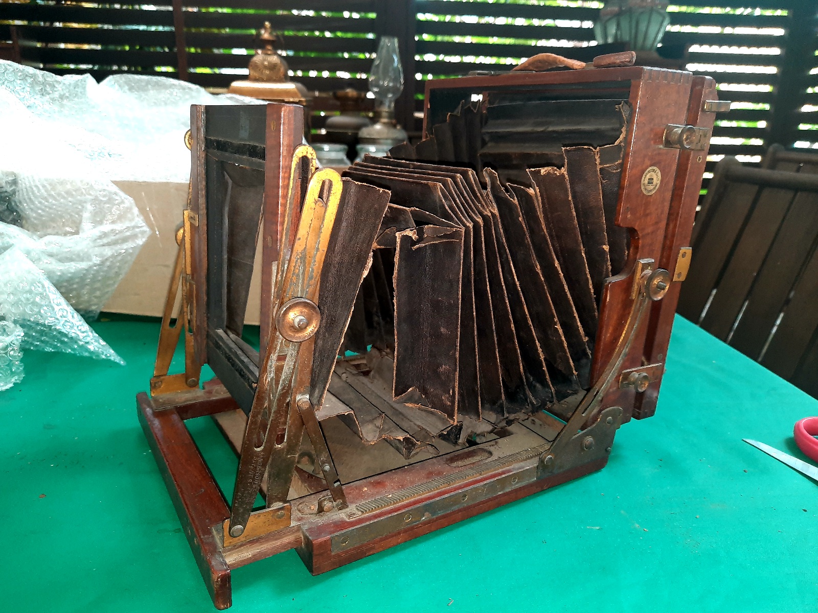

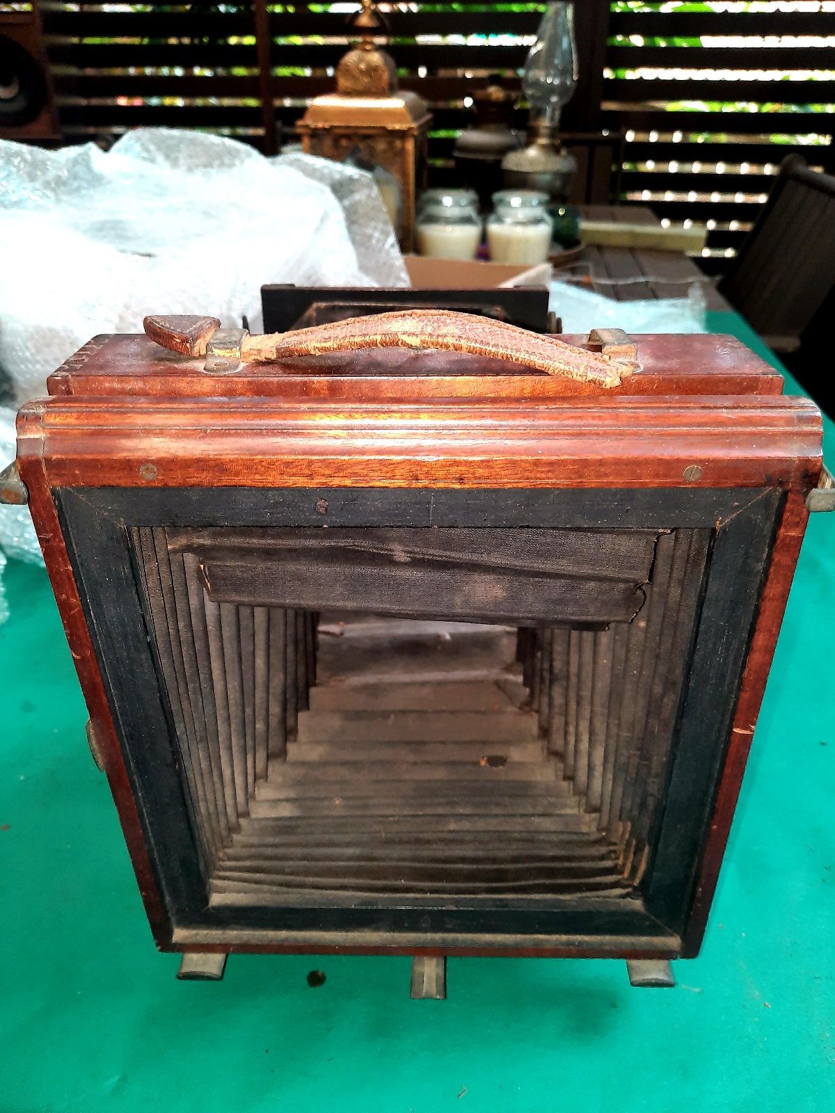

Rebadged by Harrington and Co Sydney & Brisbane.
Reckon she should buff out?

Aside from a possibly missing back, as John noted, the wood looks to be in reasonable shape. I don't think I'd try patching the bellows:smile:

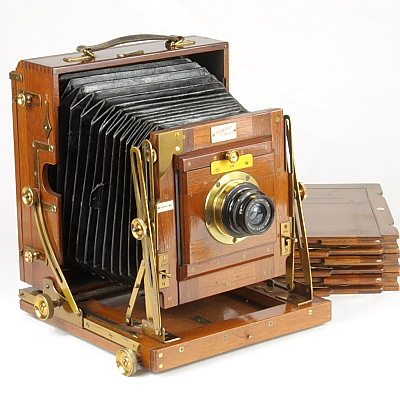

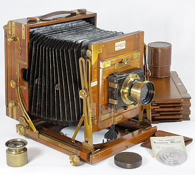

Strongly resembles the Sanderson Junior model : https://collectiblend.com/Cameras/Houghton/Sanderson-Junior.html
Why do you think yours is the Tropical version?
Because it is very different to the junior and exactly the same as the mid version of the tropical. Why do you think its not? http://www.earlyphotography.co.uk/site/entry_C330.html
Not sure if it were a special order or just switched the badges around to say Harrington and co.. Missing the front name plate so will never know.

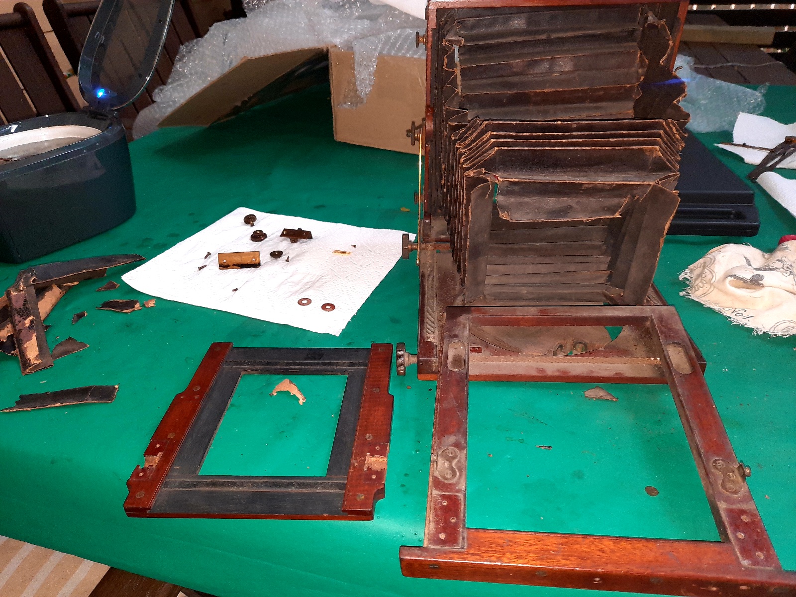

Don't think duct tape will fix it ?

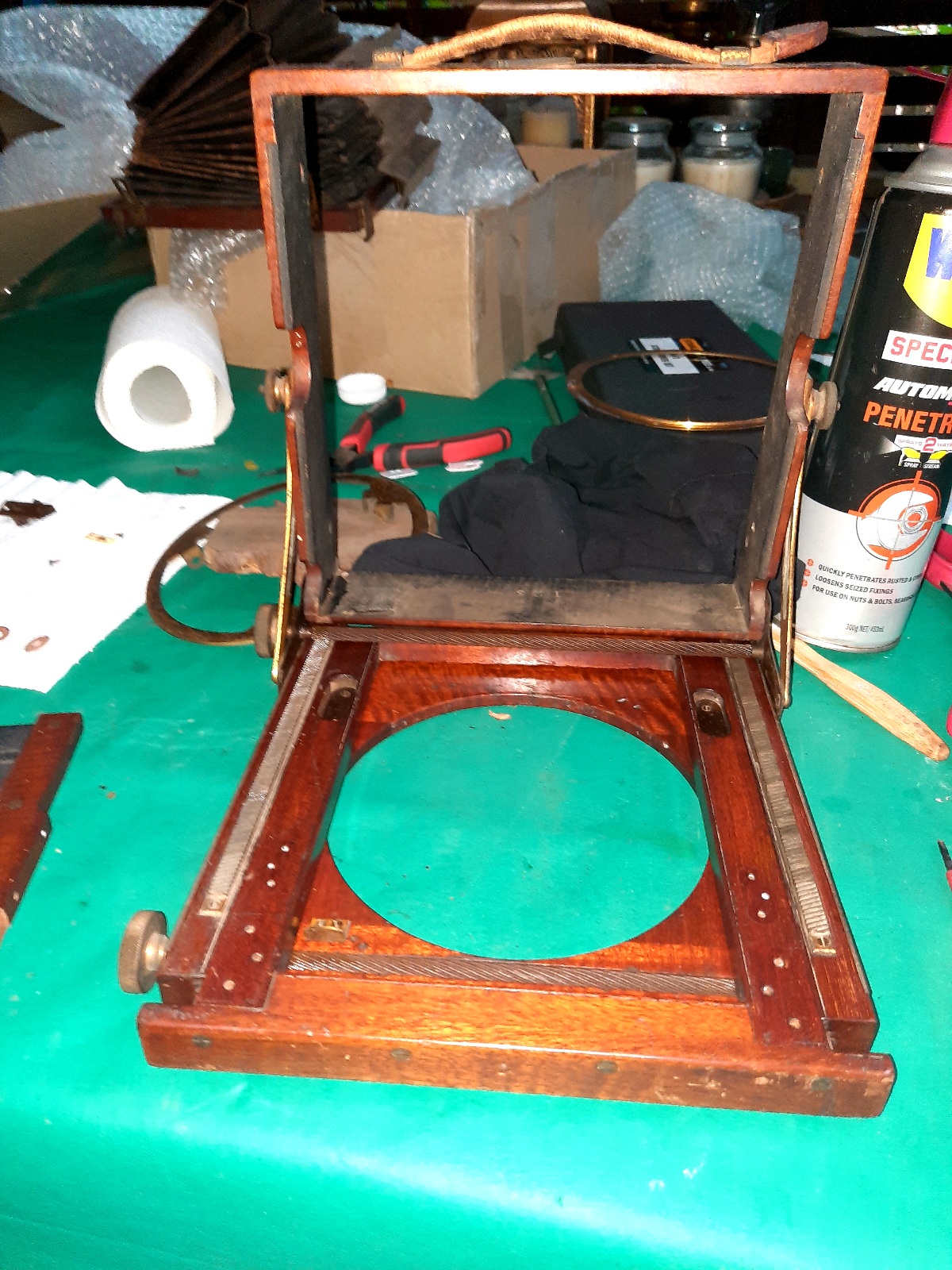

Started pulling it apart and wood and brass are good. Pretty solid camera when the front standard is locked in.
Since yours does not have the extra brass reinforcements (which the tropicals all had), and since yours is made from Mahogany, which was the wood for the regular Sanderson camera.
The Tropicals are all made from seasoned Teak.
Therefore yours does look exactly like the Junior.
(so I may hope you didn't pay what should normally be a higher price for a Tropical version of the camera); however in this condition it should not value much even if it would be a Tropical version.

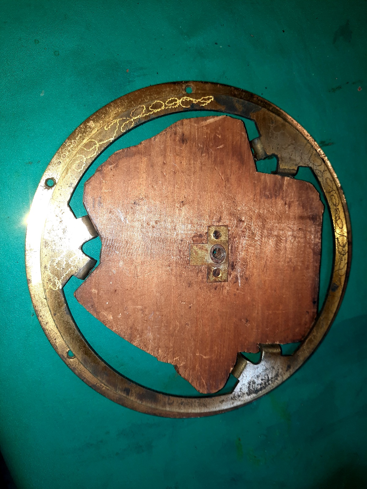

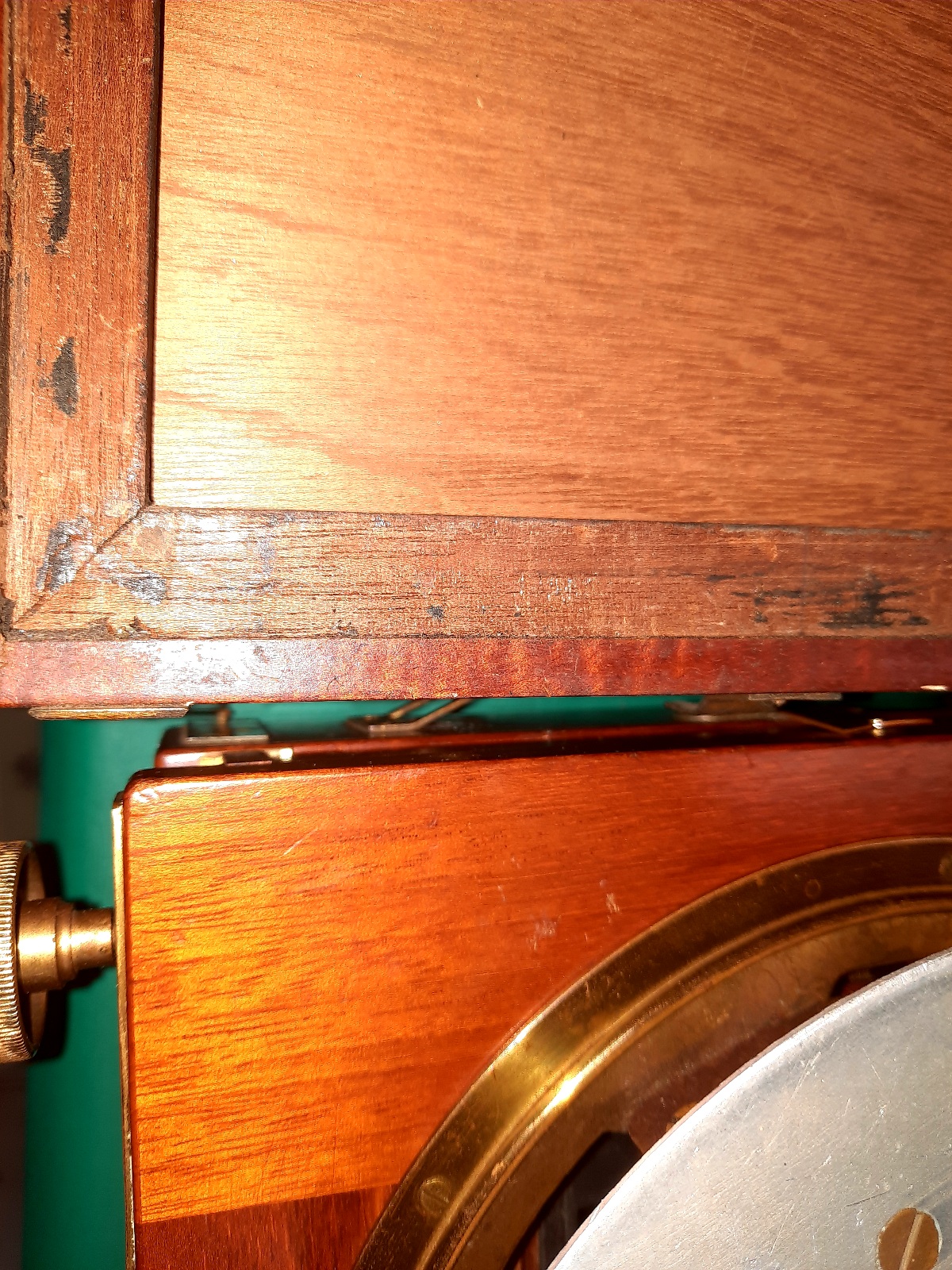

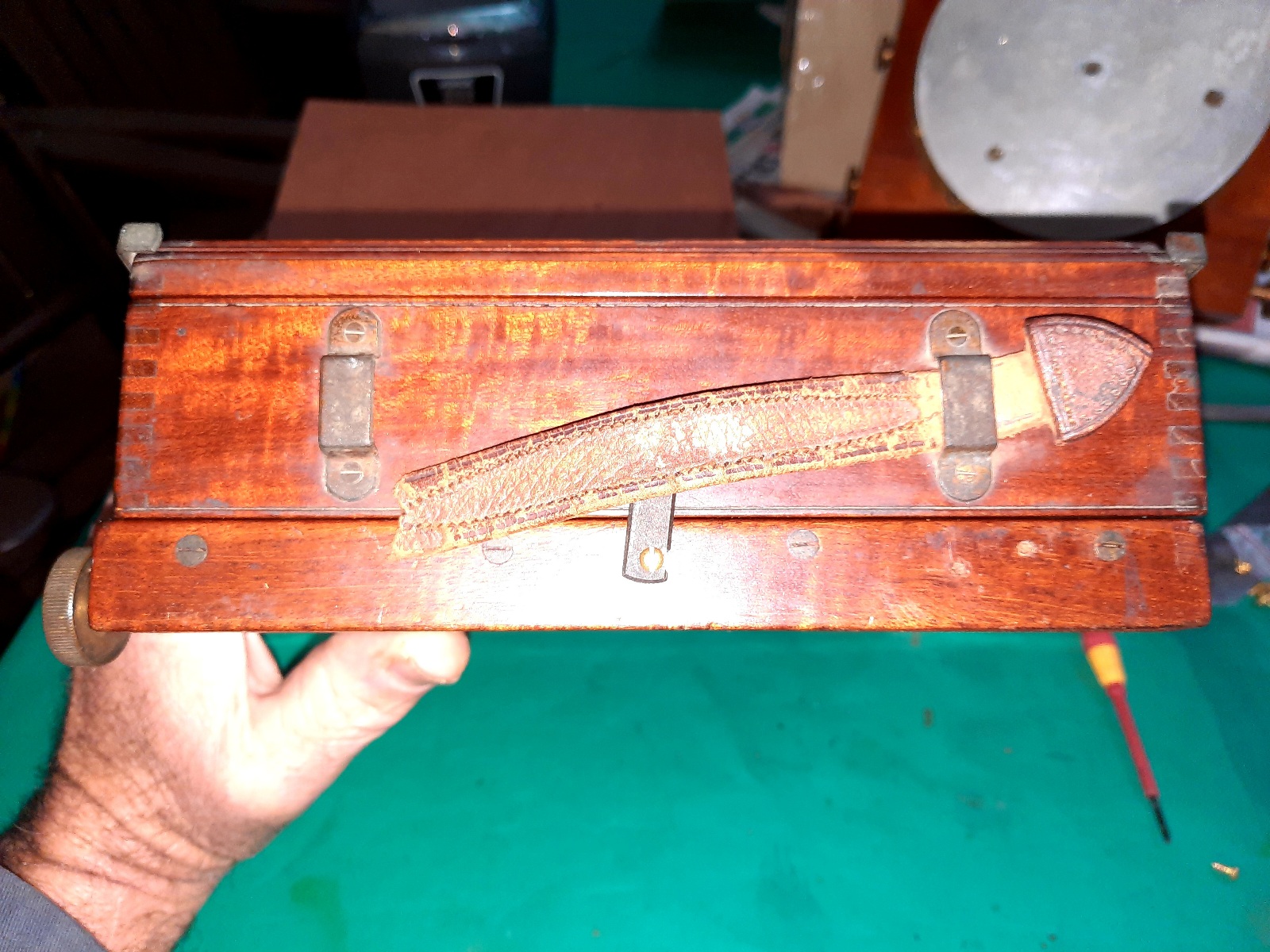

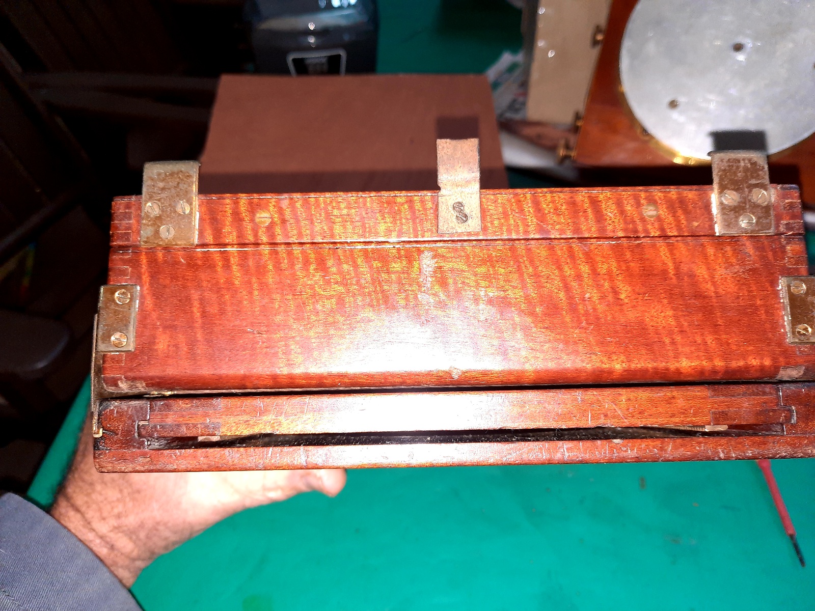

Comparing to some raw mahogany I have, it does look the same. Might be a "Regular". Interestingly my Victo Superbe looks teak and is supposed to be mahogany. Makes no difference to me.
Back standard of the Sanderson with Mahogany under, next to my Victo Superbe which is much more of a golden brown.
Interesting wood work skills, might keep it that way.

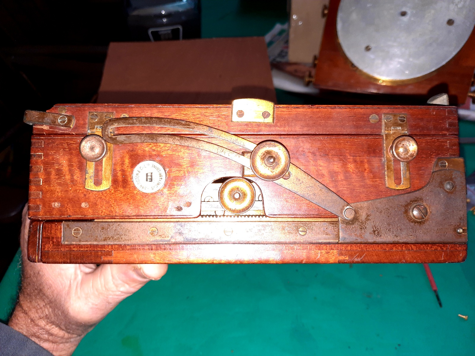

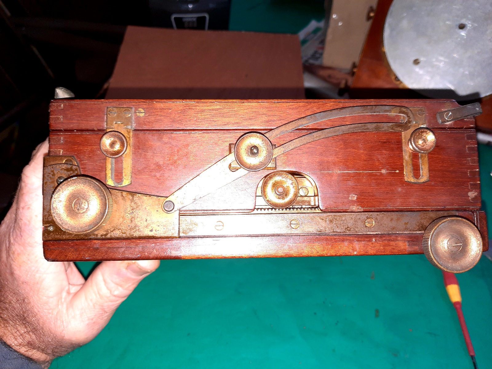

Folded down.

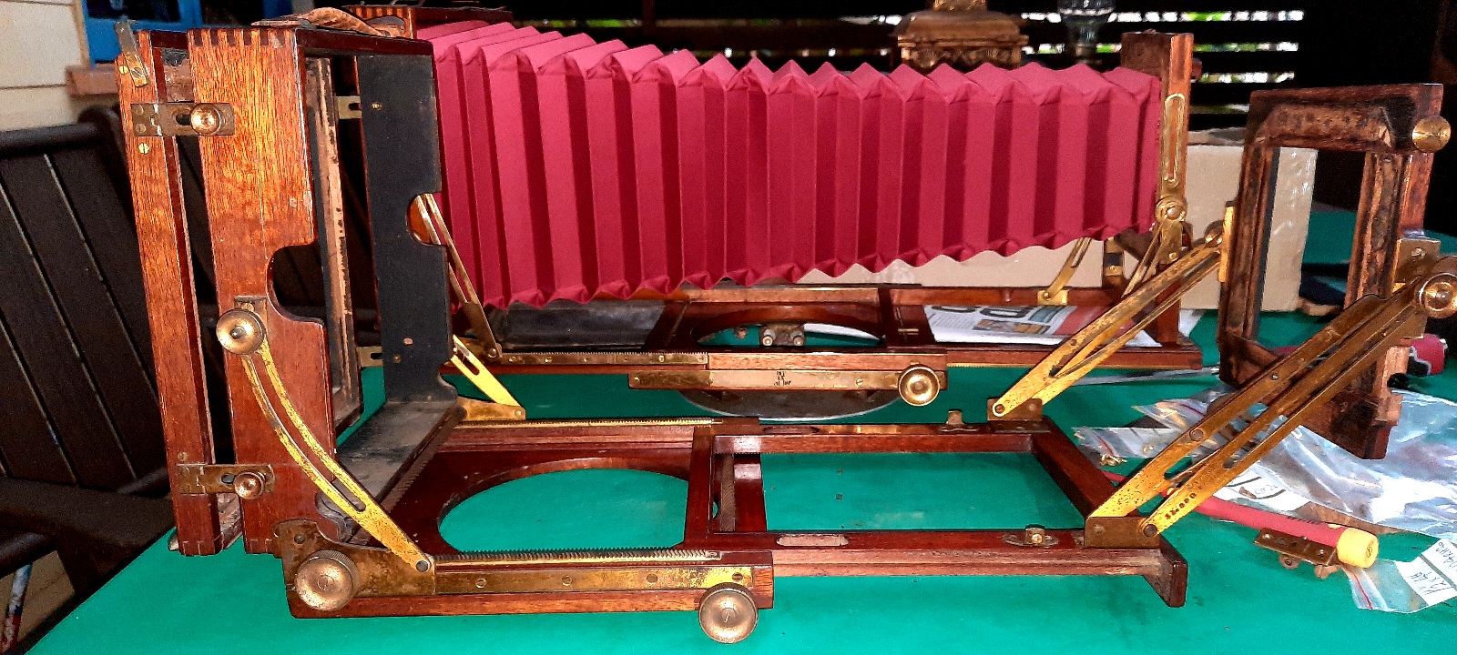

Fully extended goes to 500 mm about the same as the Victo.

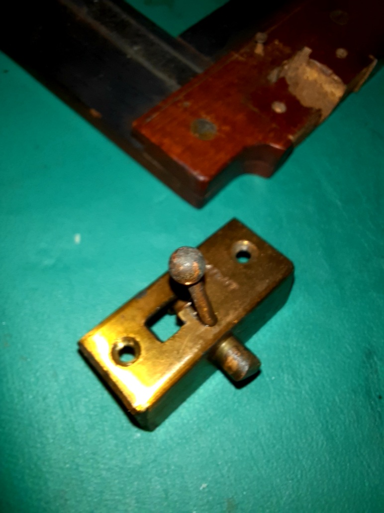

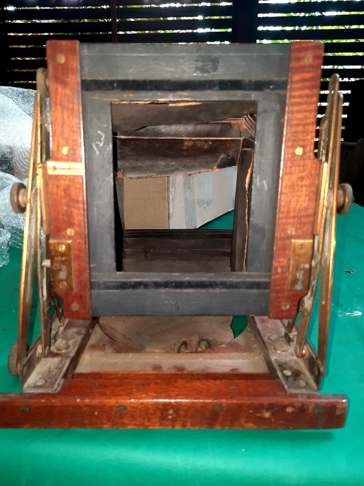

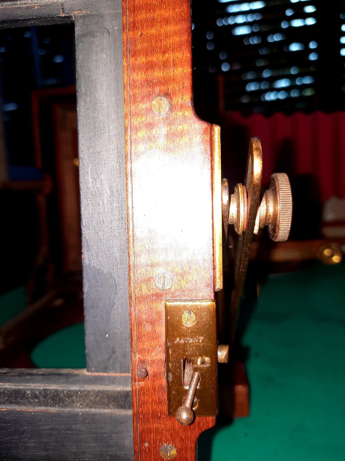

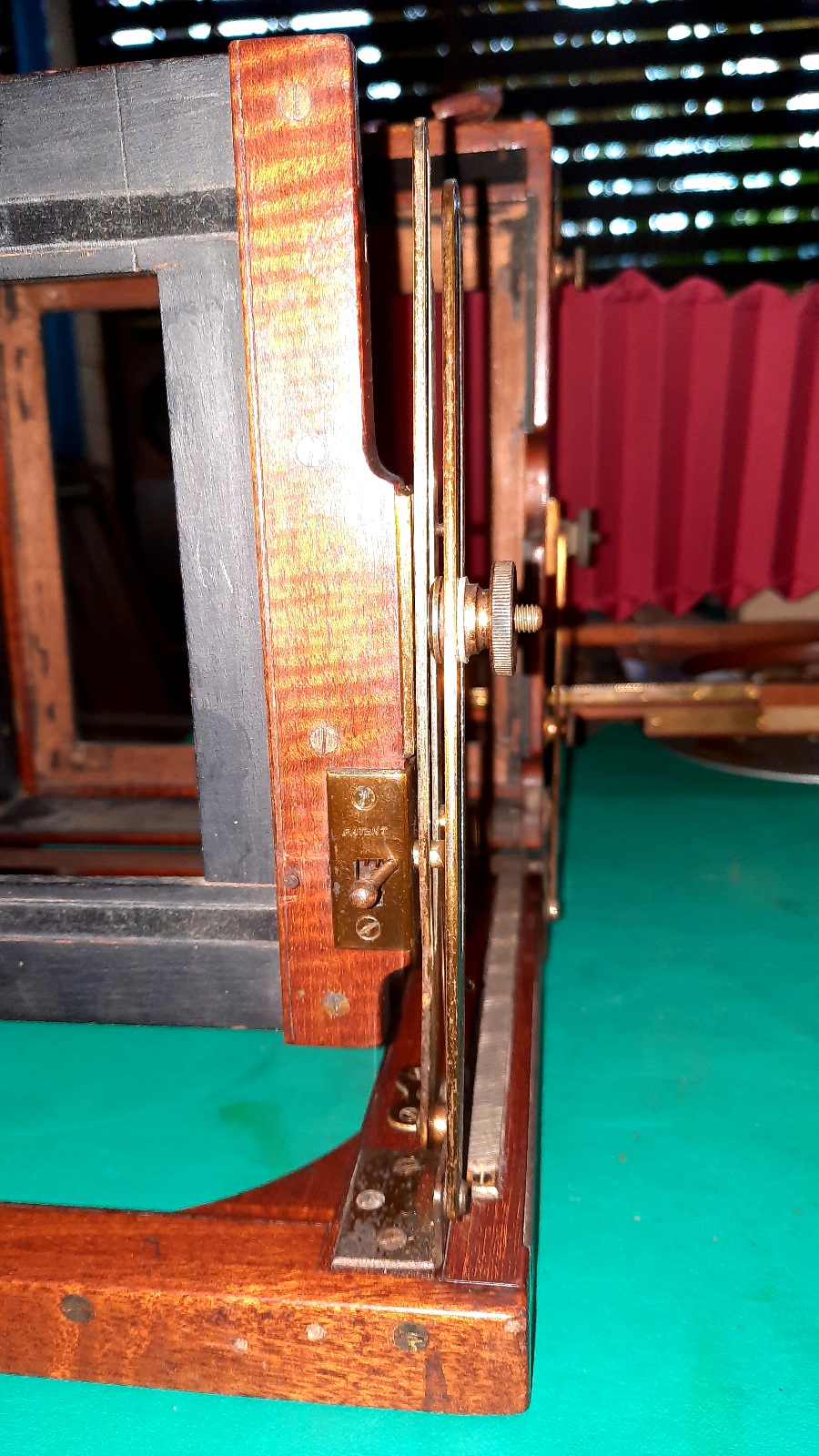

The front standard when locked upright has a small amount of rise.
When you unscew the lock nuts out, the slide can come out to extend the front standard a little awkwardly.
Folding doen is also a bit awkward as you need to have the locking pin in lock position to fit the knob into the slots but you cant lock untill it is folded, which is hard enough to do without any bellows be even harder with the bellows on......unless Im missing something.

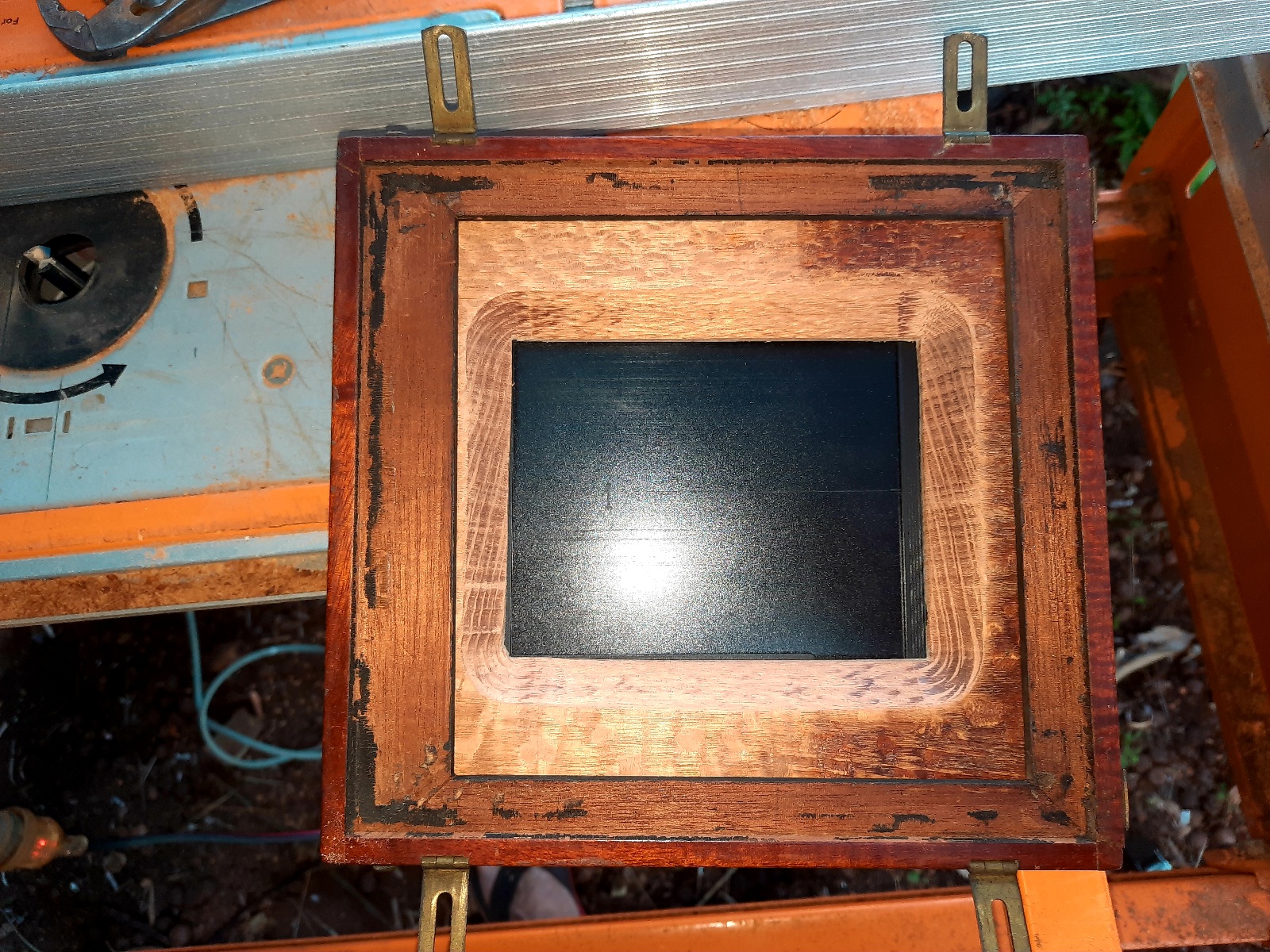

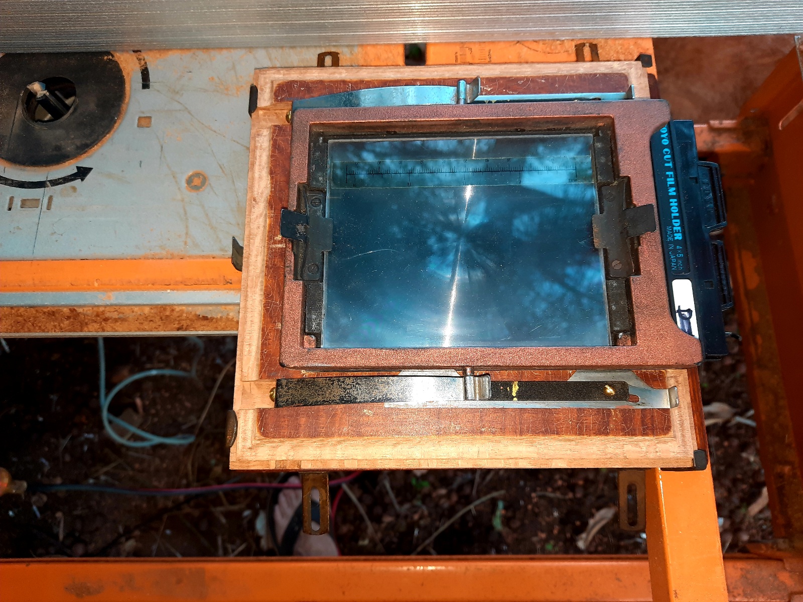

Made a new film back to take 4x5 film out of some Silky Oak I have lying around.
Just need to give a final sand and a good shellacing on exposed parts and matt black on the other bits.
Now onto the front, I have some pieces of mahogany veneer on thin ply I have left over from some speakers I made awhile back. Also some plate copper for the rise and fall.

Interesting I find that instead of two sprocket wheel the whole focusing axle is geared. Also a helical gearing is employed.
