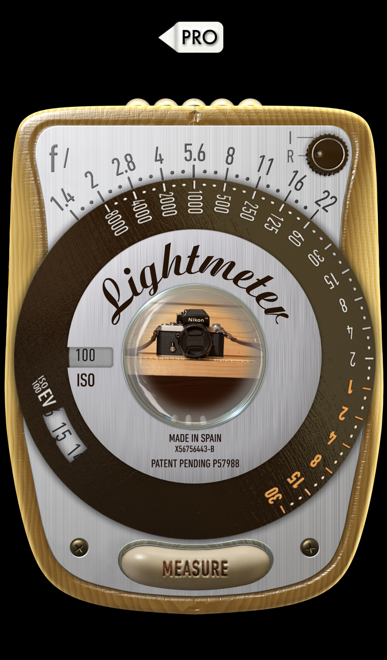

Try the app myLightMeter pro, it’s great…!
