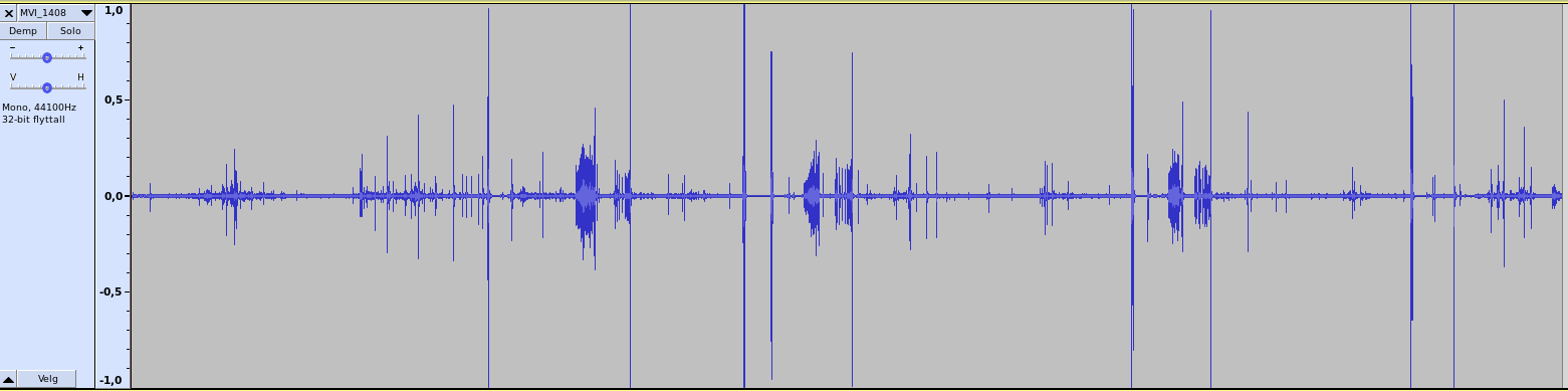

here I cock and fire a 1967 Salyut and then S2 at B, 1/60 and 1/1000:
the waveform:

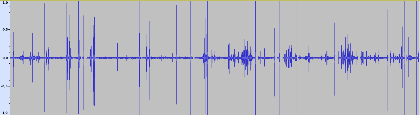

By the way, Kiev-6s (Kiev-60 same):
I need to update it with a 1000f and a few others...
