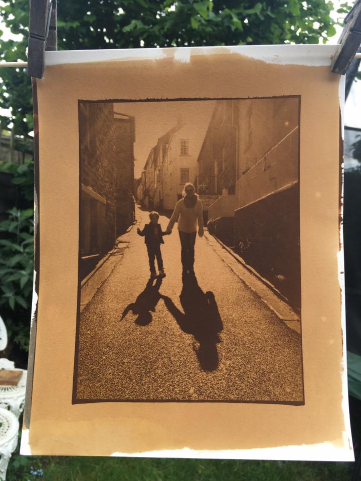

IT WORKED!!! Thanks for everyones advise!
Looking good! Keep it going.
A tip for seizing. Lay the negative you're gonna print on the paper and mark the 4 corners of the image on the paper with a pencil. This way you know how far you need to seize the paper (+ 1 cm to be sure).
I think the messy edges add to the charm. I only had Rapid Fixer and the print now dry is more redder and has darkened. What would you recommend for fixing and is a hypo fix stop necessary?
