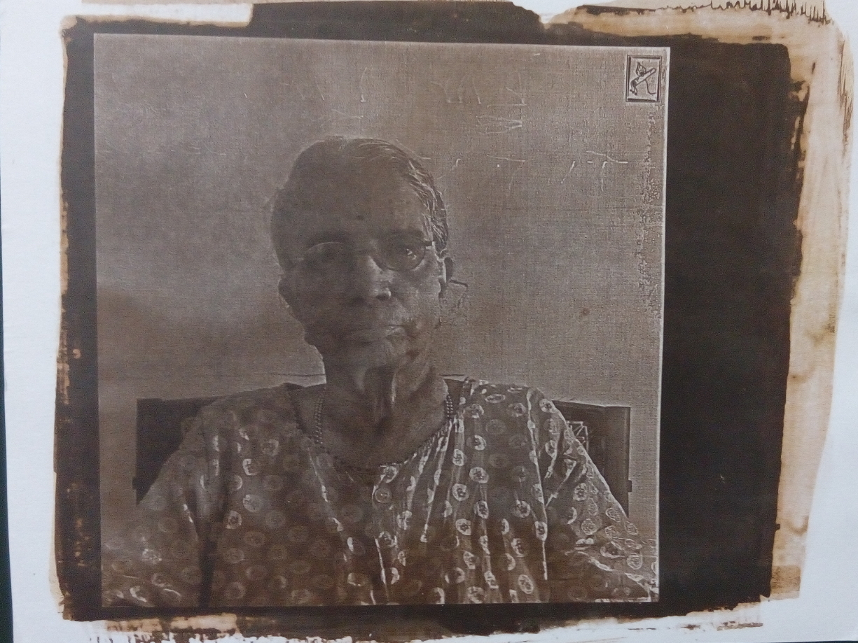

Hi ,
Attached a sample image (taken from mobile cam):
I'm a first timer and very new to salt/contact printing. I couldn't afford much , so trying it in a home setup.Did some research online and prepared my solutions. Finally settled for 2% Sodium chloride Sea Crystal Salt and 18.6g of Silver Nitrate in 140ml Distilled water. I tried sunlight , results were bad. I used my basic strobes which has 100W bulb , I have two of them. It gives me decent results. There is no Pictorico films available in India. Even if it is made available I might have to pay dollar value which is 68 times the cost , beyond reach to say. So I found peace with OHP polyester sheets.Paper Negatives didn't work for me. These are my unfortunate / fortunate situation.I get a dark/Brown color with the results for 1.5HR exposure.
I used Sodium Thiosulfate 50g , Sodium carbonate 10g , Sodium sulfite 5g per 1000ml solution for fixer.
10g Sodium sulfite per 1000ml as clearing agent.
15g of Potassium Ferrocynade & 15g of Pottassium Bromade per 1000ml as Sepia toning.
15g of Selenate anhydrous per 1000ml for Selenium toning.
It's a test paper that I obtained from local store ,since I don't get any branded stuff .
I got a wet on wet Canson Montval 300gsm paper A3 , saved it for good prints .
Kindly help me with few things :
What could be the proper mixture of silver nitrate ? I might have to finish the existing solution to proceed further.
I used Cooking Sea salt crystals because the Agar Agar veg gelatin didn't work .! Is there any good substitutes ?

I'm not sure what you want to achieve with your question. The result looks good to me, you seem to have a tone range from nearly white to quite dark. I think you are at a good point to experiment with different papers, different amounts/combinations of toning, and perhaps adding a little gelatin to your salt solution ( it changes the look... you might or might not like it! )
Your silver nitrate solution is about 13%, which seems about normal. I've tried as low as 6% and as high as 24%... for me, lower concentrations increased contrast a little and higher concentrations were more "muddy". 10 to 14% is about in the middle and a good range, a compromise between contrast and depth.
I've tried about 10 different kinds of sea salt and each one produced somewhat different results. The colors were all slightly different, and some produce more background "fog" than others. One kind of rather expensive sea salt ( "kala namak" black sea salt ) fogged the paper after coating the silver nitrate, and before I could make the print, no matter how much citric acid I added. Different salts change the color ( w/o toning ) from various yellow-brown colors to more pink/purple/peach. They affect the color after toning too, but for me the differences were less. I have never tried the toners you are using, so I don't know how much changing the salt will change your results with those.
Have fun!

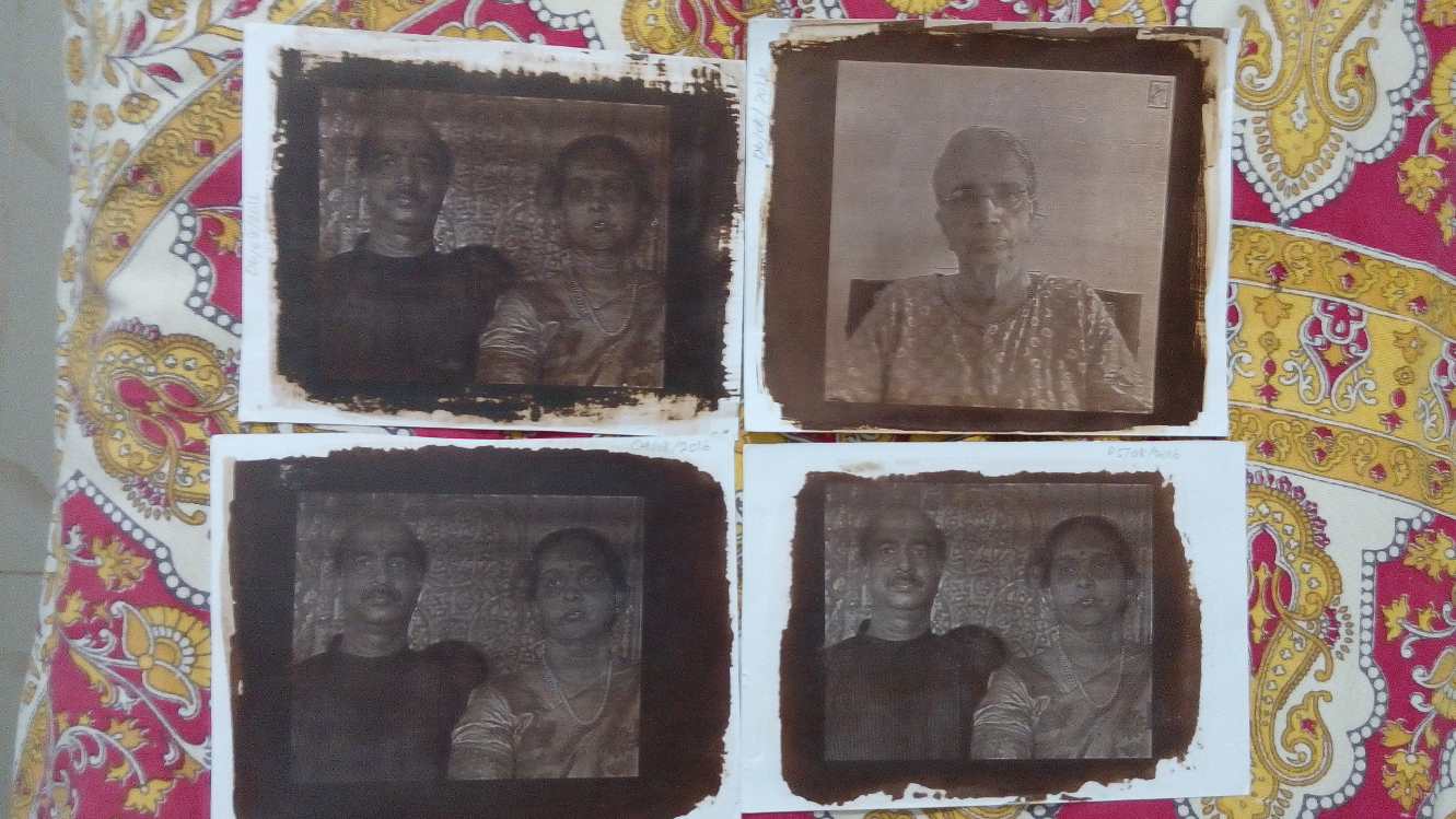

I was experimenting few salt combinations.
What I understood is less of Sodium Chloride / Table Salt gives better contrast & D-max value.
I tried Sodium Chloride: Sodium Citrate in 1:3 ratio , & my usual 13% Silver Nitrate it kind of fogged a little but gave a good contrast. Found this on www.unblinkingeye.com/Articles/POP/pop.html
Also tried R/O water instead of distilled water. It works fine for the same salt proportions but looks more Sepia even without toning.
I'm going to try new recipe today - 100ml R/O water 1:3 Sodium Chloride: Sodium Citrate & 1g gelatin.
Hoping for good , shall update soon.
found this link from apug forums , I like this recipe Vandyke (http://unblinkingeye.com/Articles/Vandyke/vandyke.html) I don't know If I could afford now. May be in future :smile:
Sample Image : Top Left - Bottom Right : 1. Crystal Sea Salt & Sodium Citrate 1:3 + Silver Nitrate 13% 2 . Same combination with RO water 3. Crystal Sea Salt 2% & Silver Nitrate 13 % 4. Same as 3 but lesser Silver Nitrate .
Forgive the image quality taken from mobile cam & reduced the size for upload.
Thank you .

I have only tried sodium citrate a few times, but that is very similar to what I noticed. Mine fogged a little, and I thought it might work better if my negatives had less contrast. I think it prints a little faster too... and the color is darker. It depends what you like! With your subject, I can imagine it would be nice.. I am always trying to get delicate highlights and a sense of "air" and distance in my landscapes, so I probably will not use sodium citrate again.
Yes... I also use RO water for all the steps in salt printing. It seems to be fine. One time I was amazed to see fog develop during the washing when I used well water.... so I use RO water for everything. I found no advantage to using distilled water.
I think 1g of gelatin is a lot, but again it depends what you like, and it depends on the paper. Some people use even more ( 2 or 3% ).

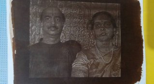

Attached the image of today's trial .
Though I heated and mixed the gelatin with other salts properly for about half hour, it kind of fogged the image.
Darker portion are evident of sodium chloride and little light brown shade are evidence of sodium citrate.
But I got better D-max here. Looks like RO water isn't bad after all.
I think I'm going to omit gelatin from my process here after.
With my budget getting tighter, I kind of took advice in other forums on pigment printing. I liked the control over color in that.!
Because I couldn't achieve the neutral black tone with Silver Salt Prints ! It doesn't mean I'm quitting it , just a pause for few prints !
This Pigment prints seems to give that desired color but with a oil paint. !
I chose Silver Salt Print for it's versatility , Ansel Adams & many great artist did that. Forget the photographs , atleast I should get that tone right ..!
This is what leaves me hanging in search of other options.
Hoping for good :smile:

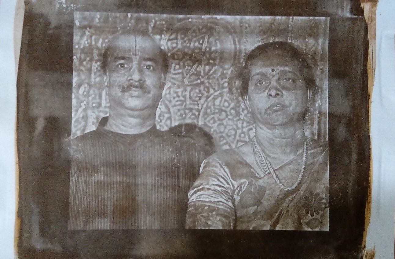

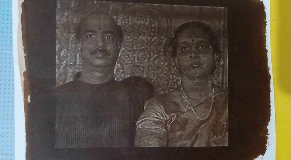

Hi all ,
Today's try .!
Part A & Part B was mixed at the time of application .
Part A : Sodium Citrate & Sea Salt 1:3 18 drops , Potassium Dichromate 5% solution 1 drop.
Part B : Citric Acid 5% 6 drops , Silver Nitrate 13% 18 drops
Paper : Titanium White Local Chart Paper.
Application : Applying Part A was easy and smooth.Let the paper dry.During Part B application the paper showed some weird yellow patterns , though the solution seems to have applied all over the paper.
I let it dry.
Exposing : Same Strobes Two in number . 2hr exposure. The weird Yellow pattern slowly vanished during development. Got some better contrast. I believe the citric acid didn't mix well with silver nitrate.
Washing : Water 2min | Sodium thiosulfate 20% solution 5min (My mistake) | water 2min | Sodiium sulfite 10% 2 min | water 2min | Sepia toning 20% ( my recipe) 30 sec | Selenite 15% (my recipe) 30 sec | water 5 min|
I let it dry.
I got better contrast .But the weird portions got washed away. I could see some paper No Fog. I would say my personal best so far.
Sample Image : Forgive the quality , taken from mobile cam & reduced the size to suite the upload.
