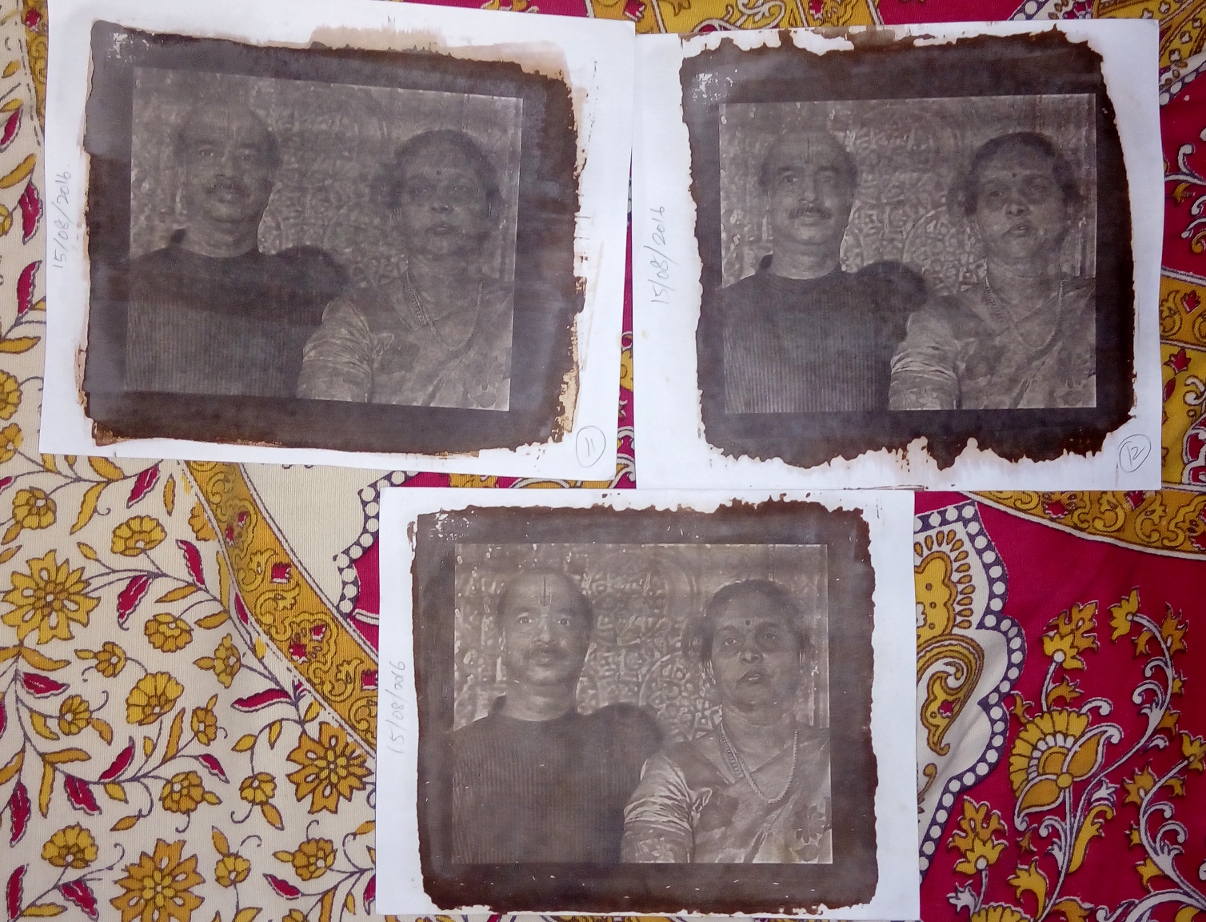

Thank you all.
I thought I found some acceptable recipe and paused my test printing for two days.
After seeing few post ,today I went on to test three types of salt combination with constant 13% Silver Nitrate Solution.
1. Crystal Sea Salt 4g, Sodium Citrate 13g (1:3) , Potassium Dichromate 32 drops 5% solution , Citric acid 5g - PART A 200ml solution.
I purposely made this concentration to know what could be the reason.
Result : A lot of white patches , fogged image . I believe the patches are due to Silver Nitrate's reaction with Potassium Dichromate or Citric Acid . IMAGE NOT USABLE. FAIL.
2. Same solution , increased the citric acid to 12g
Result : Slightly better image , comparatively less white patches but different kind of fogging , it was almost like rain drops on a water painting. IMAGE NOT USABLE . FAIL .
3. Crystal Sea Salt 2g , Sodium Citrate 2g , Citric acid 2g , Potassium Dichromate 2 drops per 30ml 5% solution- PART A 100ml solution.
Result : Acceptable image . Less white patches , no fogging. IMAGE CAN BE SHOWN AS TEST SAMPLE. FAIL.
WHAT I UNDERSTOOD FROM ABOVE THREE IS SODIUM CITRATE DECREASES DEVELOPING TIME. CITRIC ACID REDUCES FOG. BUT BOTH SHOULD BE MORE LESS EQUAL SAY 5g OR 6g PER 100ML.
4. I want to try the straight method 2% Crystal sea salt as PART A and CITRIC ACID -SILVER NITRATE COMBINATION AS PART B, may be tomorrow . I'm already tired making prints from 12 noon IST to evening 5.45 PM IST today.
I TRIED SOMETHING NEW TODAY , THAT IS APPLIED SOME BEESWAX TO THE 3. SALT SOLUTION IMAGE. IT IS NOW A USABLE IMAGE. I DIDN'T APPLY BEESWAX FOR THE EXTRA AREA. APPLIED JUST FOR THE IMAGE.
STILL I COULDN'T ACHIEVE NEUTRAL BLACK TONE. MAY BE AMMONIUM CHLORIDE SOME TIME.
My constant result came from this mixture Crystal Sea Salt 2.5g , Sodium Citrate 6.5g , Potassium Dichromate 2 drops per 30ml 5% solution / 100ml RO water or Distilled water as PART A . Citric acid 6g in 100ml distilled water , Silver Nitrate 13% solution mixed in equal portions at the time of applying as PART B. Result was Dark Brown color.
Thank you everyone for your support.

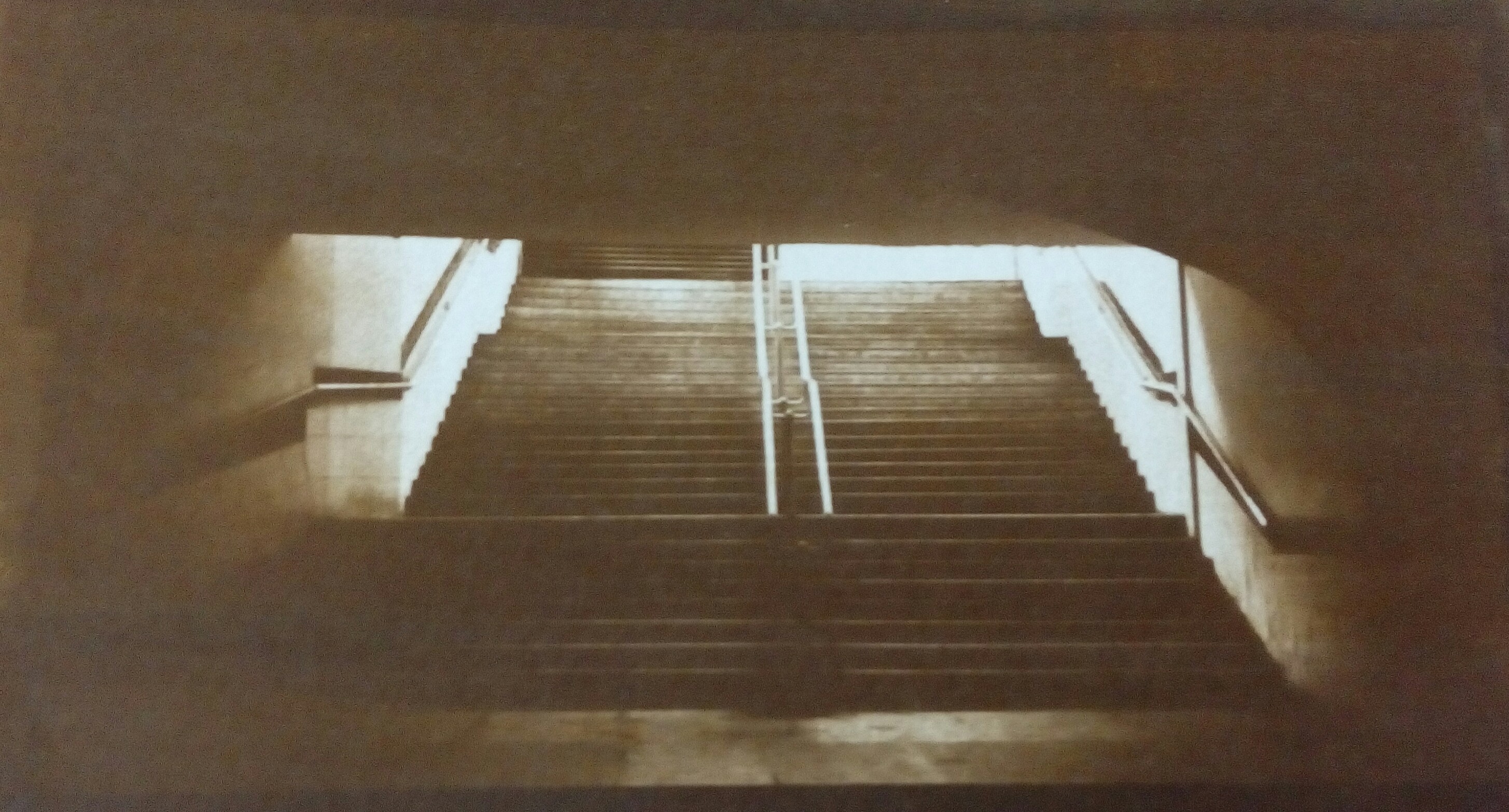

NedL
Aug 23, 2012
3,430
Sonoma County, California
That looks neat and the whites seem very nice!
I don't know what it is called, but this print seems to have something that I just love about salt prints.. it's almost like you can see the light going through the air in that stairwell. There is subtle atmosphere in those highlights. I really like this print.
Thanks NedL,
I'm glad you liked it. it was a test print 6" x4 ". Forgive the quality of the picture ,it was taken from mobile and cropped to suite the upload.I found some inkjet transparency film not water resistant but can be used for once for sure. It helped me.Also the paper. I'll be sponsored for buying some gears next month. I'll start making A4 size prints of my photographs.I post my experimental photographs in www.500px.com/kicha . Actually I was trying to match the color that I achieved digitally in my salt prints. Not there yet , hoping for good in the future :smile:
Thank you sir once again :smile: Have a great day :smile:
