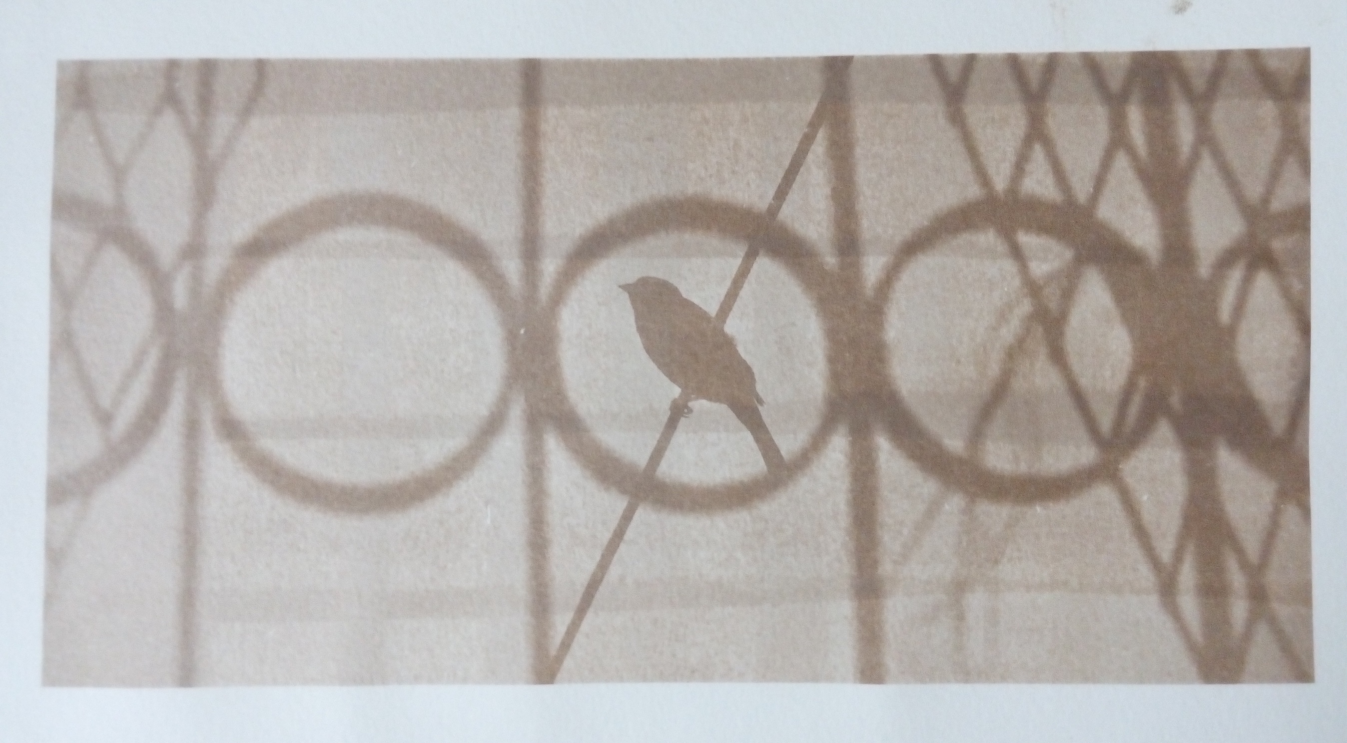

Hi All ,
I'm kind of two months experienced with salt printing :smile:
I use Silver Metal Salt and Sodium Chloride Salt for my printing process , on a Canson Montval Paper.
Only recently I have started making A4 size prints.
My solutions are about two months old.
I couldn't avoid the brush marks in my pictures. How to get rid of that ?
I do Sepia & Selenium toning to my pictures.
If I pour the silver Nitrate solution & spread , the area in which I poured is creating a mark.
Hence I preferred using a brush... a sponge brush ( common one - black sponge & wooden handle)
which also seems to create marks ..!
How can I avoid ?
The glass rods seems to be not available in India.
Attached a image sample for reference. Forgive the quality of the image , coz it was taken from mobile & has been made to suite the upload.

Buy a richeson...best brush there is
Not sure number though and you might still get streaks..salt is tricky..wish you luck

I have zero trouble with brush makes. Maybe my brush is a good one. I do pay careful attention to how I spread it on. Up down back and forth criss cross over and over again.

You have a nice image, so you are doing something right.
As per the glass rod, you don't need a fancy puddle pusher to do the job. A nice straight glass tubing, kind you will find in a chemistry lab can be used as well. I am sure you can find something like that in India.

First off, I would say that your salt prints are hand made so brush marks make them unique. I've had brush marks with silver nitrate solution because it's clear. With cyanotype and Ziatype, the solution has a color so I can see streaks when I brush the emulsion on my paper. Glass rods are a bit harder to use because you have to use exactly the right amount of emulsion. You either put too much solution which can over saturate you paper or not enough which you'll get streaks at one end of your print. I've never tried this with salt printing, but maybe try a drop of surfactant like polysorbate 80 to help the emulsion spread easier. It works with Ziatypes well. Also, try another type of brush like a Japanese Hake brush.
Good luck!

I wonder if you are using enough sensitizer, and if the paper is getting equally dry over the entire surface.
It appears to me you are taking a brush wet with sensitizer and starting at the top of the paper to apply the liquid. the second brush stroke has less liquid, and the third even less. If you pour the sensitizer along one edge then quickly brush it across the paper then brush in the opposite direction it may help solve your problem.
My method is to assure adequate amount of sensitizer which I pour in a line in the center of the paper. I then spread it quickly side to side,then top to bottom. I then brush in every direction until there is no apparent wetness on the paper. This can take anywhere from 2 - 5 minutes depending on the paper and its size.
Another method is to double coat. Let the first coat dry, then re-coat and brushing the opposite direction first.
Does your paper soak up the liquid too quickly? If so, soak it in starch or gelatin to seal it better.

I don't know about salt printing, but for liquid emulsion, I've enjoyed this brush - comes in a variety of sizes, good quality, no falling hairs, very affordable and doesn't drink up tons of emulsion...

I would say that traditionally the salted paper was gently floated on the silver nitrate solution. Begin with one end and slowly lower the paper so as not to trap any air bubbles. You can also consider any brush marks as part of the charm of the process.

I use a chunk of car-washing sponge to coat cyanos, salts, sepias and just about anything that needs coating. never get marks. always even. no special methods. dunk sponge in sensitiser, apply to paper. job done

Caveat: I've never done salt prints, only cyanotype and argyrotype but I do use a foam bush the same as you do.
It looks to me like you are soaking your brush in sensitiser and only brushing it once left to right top to bottom.
Here's how I do it but as I said I use different chemistry.
First I wet the foam brush with water and squeeze as much out as possible so that it is just slightly damp. This stops the foam from sucking up all the sensitiser as soon as you put your brush in it.
Then I measure out my sensitiser. Usually about 2 - 2.5ml for A4 but it depends on how thirsty the paper is.
Then, adding a little bit of sensitiser for each brush stroke I go left to right top to bottom. That's usually used up my sensitiser. There should be a little liquid sitting on the paper at this point. If not, a little more sensitiser is required. Then I go over it again, very gently now so as not to damage the wet surface of the paper, bottom to top, right to left. No pressure, just dragging the brush over the surface to move the solution about. If it's still forming puddles at the end of the strokes I'll go again right to left, top to bottom, then if necessary once again bottom to top, left to right.
I get good even coverage this way.

The fancy glass rods are just plain glass rods with a bit of acrylic plastic glued on for a handle, cut your rod to length, fire polish the ends with a propane torch or Bunsen burner, glue on your handle with aquarium cement or clear silicon and you're good to go. If all else fails you could try double coating your paper.

I took my own advice after I broke my pricey puddle pusher and recently bought this cheap ($1.24 a piece) glass tubing from Home Depot that is straight as can be and robust as well. It only took a little bit of sanding with a coarse sand-paper to get rid of the sharp ends. At 12" length it will be longer than I probably will ever need.

This is brilliant! I'm going to look for it at home Depot this weekend. But puddle pushers take practice and waste little chemistry. A also use a Magic brush. I wet the brush in distilled water before using.

My local HD store didn't carry it on the shelf. I ordered it on line and had shipped to store for free. I agree that the rod is a little tricky. But that's what I started with. Most people I suspect try the rod first but migrate to brush eventually. Brush is also good if you want to make quick small size test strips.

For me, it's not whether how my print might be worth, but how much are your materials and frustration is worth. I print with palladium that's very expensive. For cyanotype, I use a foam brush. What I do like to mention is that foam brushes can also cause contamination in the sponge which can issues in your print. Brushes and glass rods have less issues with contamination.

Foam brushes are so cheap I wouldn't use one for more than one session.

Did OP find a solution to this?
I had exactly the same problem appear after months of no issues - brush stroke 'bars' appeared in all the last few dozen papers I've sensitised. Used a new brush, still got the bars. Used a different type of brush, still got the bars. Used different paper, still got the bars. Used different batch of sensitiser - still got the bars.
Reminds me of when I used to build computers. Can't find the hardware problem, so replace each component one bit at a time... until you have a whole new machine and the problem is still there.
Theseus problems, man.
