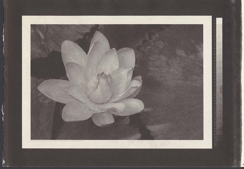

Attached is the first and only full image I printed with this process:
:Niranjan.
Somehow I completely missed this thread and never would have seen it if you hadn't mentioned it on the alt-photo listserve today.
Well done!
Thanks, Ned. I think I might have put this post in the wrong place. Should have used the Alternative Processes forum, although the mention of digital negatives might have been a problem there.
:Niranjan.
Looks very nice!@
Thanks Peter. It seems I need to work a bit to improve my coating/drying process. The sensitizer seems to travel deeper into the paper making it difficult to be cleared out as can be seen from the darker stains in the lower portion of the white border as well as on the step wedge. Perhaps getting the viscosity up by using higher silver nitrate from 10% to 12% or even 15% might help. May be there are some inert additives I can use to the same effect. PVOH or fumed silica come to mind. I wonder if anyone has used those in the sensitizer solution. Those might help in bumping up the Dmax as well. It's decent right now but could be better.
:Niranjan.
