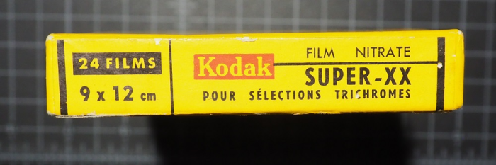

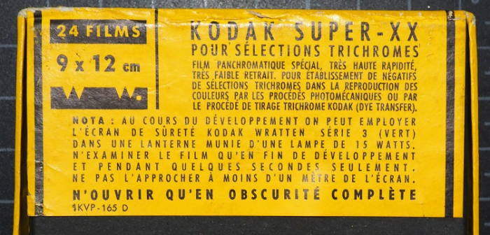

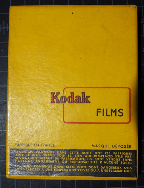

I also have some expired French made Kodak Super-XX Nitrate film in 9X12 that I shoot. There's no expiration date on the box, it could be from the 1950's, unless they were making Nitrate in France longer than the U.S.. The film was for Tri-Color Photography, probably not a consumer film.
Long Pier by Bryan Chernick, on Flickr
For safety I store this film in metal containers in metal cabinets. Like anything flammable, you want to keep it away from an ignition source.
