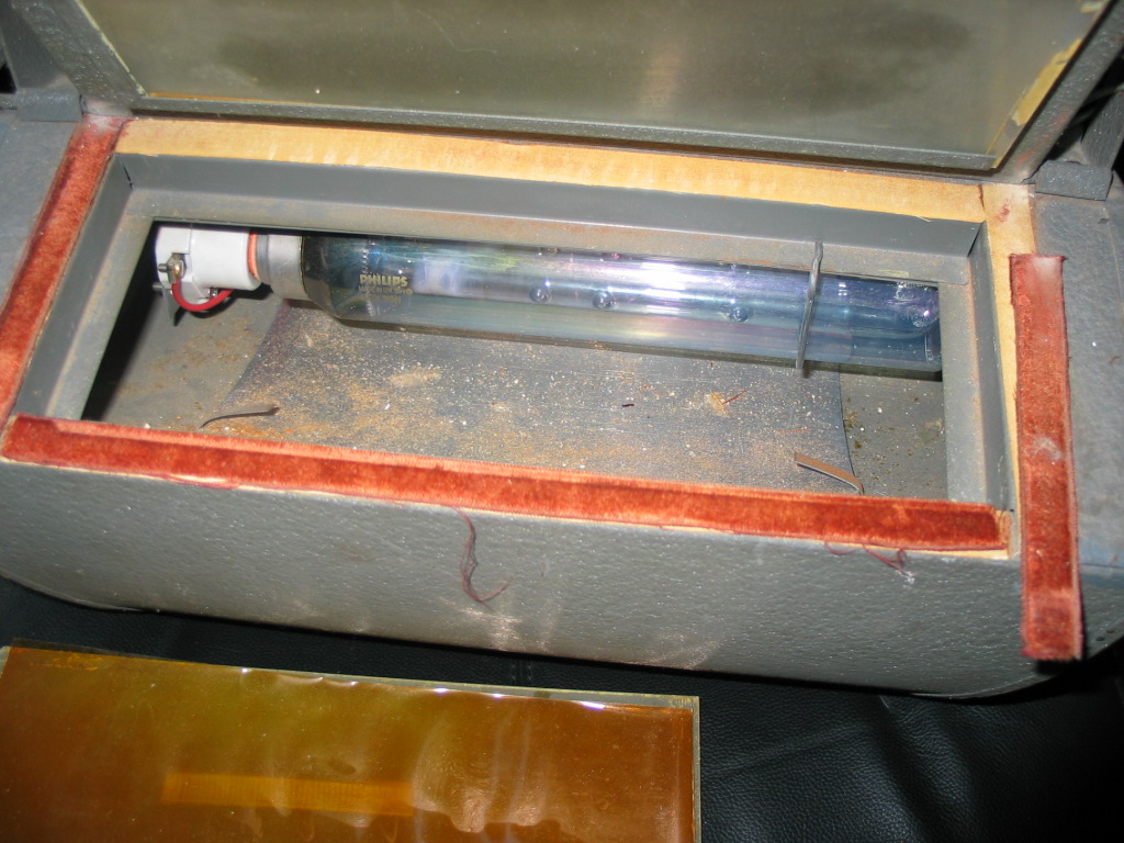

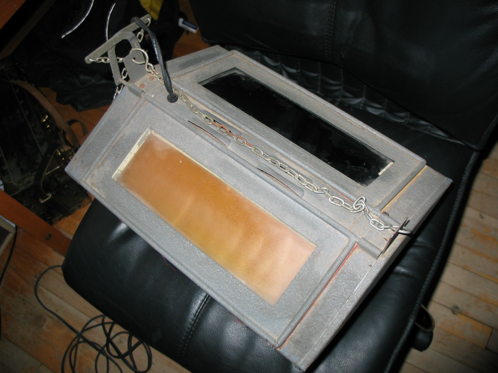

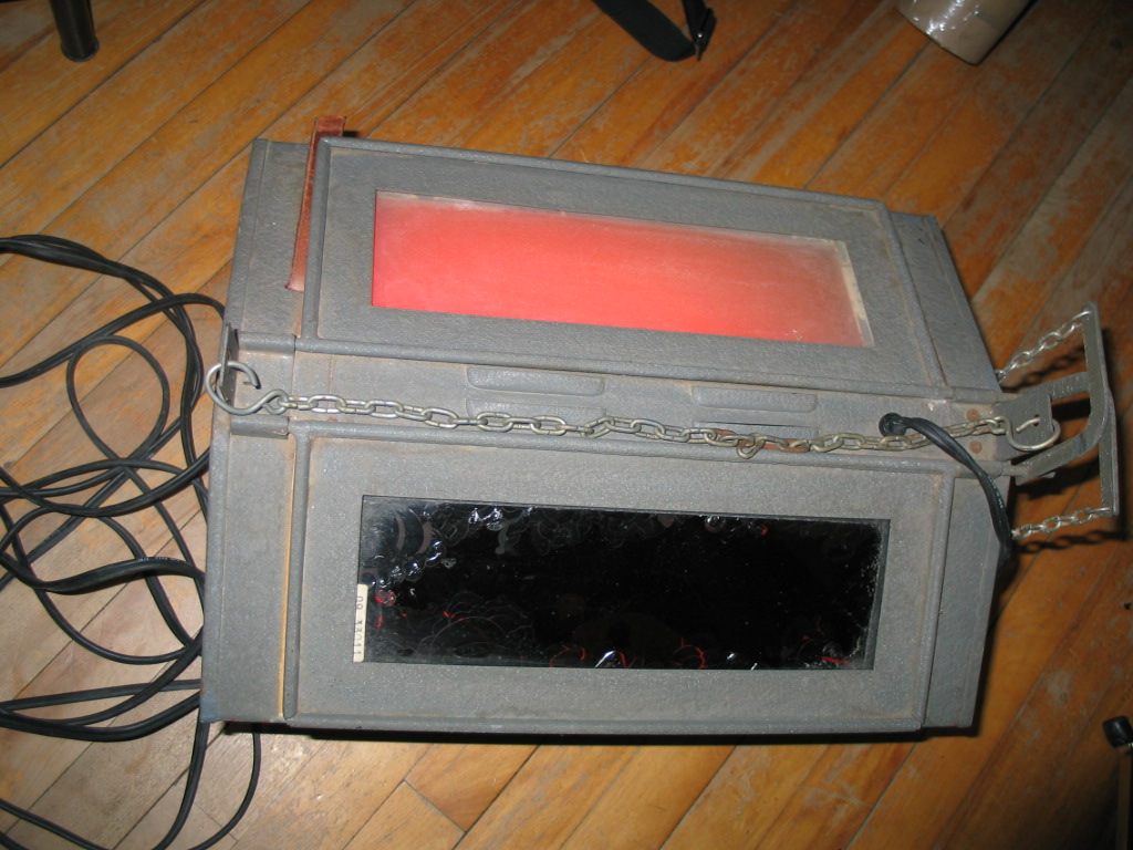

I am pretty sure that this safe light (see below) was used by Flash Gordon in his battles with the Merciless Ming. It weighs a ton and has a bulb in it that has probably not been manufactured since the Crimean War (not the current one), but it does light up!. It has two lids, each one with a piece of glass fixed in place. One looks like diffusion glass, the other is black with random silvering on it. Under each is another piece of glass with an orange filter sitting on top of it.
Any ideas who made this? Is it still useful or recoverable? I can imagine that when that light finally dies, it will be impossible to find a replacement. At the very least, it will make a terrific Halloween ornament (I took one photo with no room lights on and no flash. It's pretty spooky!).
These safelights were used in professional darkrooms. The sodium vapor bulbs produce a lot of light. The spectrum consists of a series of two thin lines. The filter cuts out all but a doublet in the yellow-orange region of the visible spectrum. Life expectancy for these bulbs is typically 30,000 hours so these safe lights last practically forever. The ones that I have seen have baffles to cut down of the light output. This is probably necessary for use in a home darkroom.
http://www.indiana.edu/~geol105/images/gaia_chapter_1/visible_light_spectral_emission_.htm
A properly set up Thomas safelight will give you a safe light level sufficient to read a newspaper in your darkroom while your print develops in a tray.
Assuming your eyes are good:smile:.
Yes...

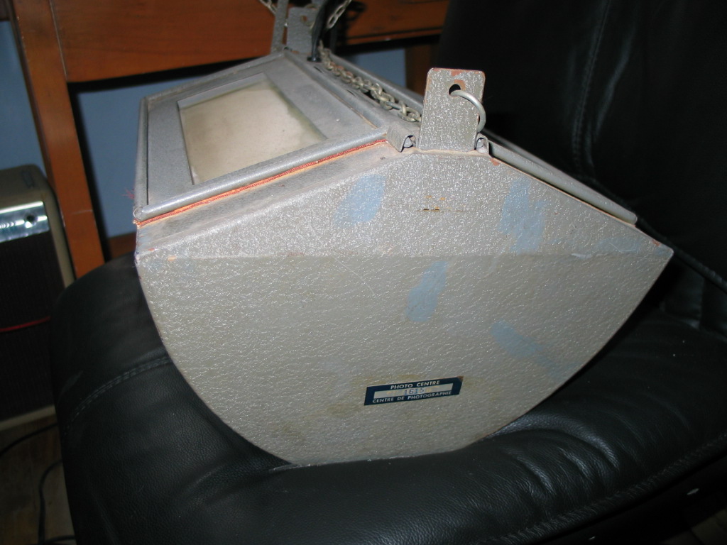

A Duplex model low-pressure sodium vapor (LPS) safelight, manufactured by Thomas Instrument Co. The unit itself is now discontinued. But here is at least one source for both new LPS bulbs and filter sets from Freestyle:
Thomas Duplex replacement parts
Note that the bulb itself is also available generically for less money from commercial lighting supply outlets. There is also still listed as available new a comparable unit from California Stainless Mfg. It's called a Sebastian Darkroom Products Model OC-1012 Safelight.
Filtration is required because the LPS bulbs incorporate a Penning gas mixture to assist with striking the lamp. The pure orange-colored sodium doublet output lines are themselves safe, but the additional argon and neon in the Penning mixture contributes unwanted blue and green spikes to the aggregate output spectrum, which must then be suppressed in normal use.
The unwanted blue/green spikes may be clearly seen in this illustration at 450nm (faint blue), 498nm (stronger blue), 515nm (faint green) and 569nm (stronger green). Note that this illustration contains a mixture of two light sources, low-pressure sodium (Na) and mercury (Hg), which are overlapping.

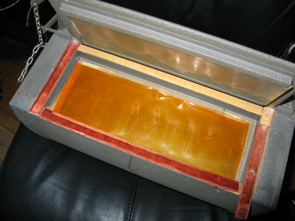

If it is too bright you can always add a layer of Ruby Lith or neutral density film to the filter packs.
Or even more simply, just cut two pieces of black mount board the same size as a filter. Slide one each into the filter slots on the undersides of the movable vanes. Then one can control the light intensity by progressively opening and closing the vanes with the chain.
Close the vanes completely and the room becomes almost completely dark for focusing. Open them completely and one can read the fine print on a medicine bottle.
If your spectral setup requires use of a second set of filters in the vanes, just remove those and lay them on top of the filters in the body.
And as far as warm-up times being a hindrance, this safelight is designed to be left on for the entire printing session. One only needs to switch the white lights off and on. If fogging over extended time is an issue, then one hasn't yet filtered out those neon and argon spikes.
