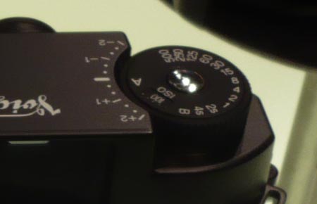

The markings beside the right dial look as if they might be for exposure compensation.
Title updated.
Looks like the dial on the right is for shutter speed or auto exposure with an ISO dial inset and exposure compensation next to the dial.
The shutter button is where it belongs. I found the shutter trigger on the Bessa II very awkward, though it was very elegant in the way it would become erect when the door was opened.

Do you think that the dial on the right is for shutter speeds for a focal plane shutter? Maybe the shutter speeds aren't on the lens.
Speeds would have to be on the lens unless one wants a bunch of wiring that eventually will go south at the worst possible moment.

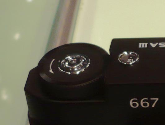

The dial on the right (camera's left) appears to be focal plane shutter control and the other dial (like the Bessa II) is the film advance.
The lens body appears to have (from the rear) aperture control, the next ring with the plastic thing a focusing mechanism and the front a depth-of-field scale.
If it's focal plane, I don't want one after all.

Note the frame counter showing "12." This suggests to me that selecting 6x6 actually controls film transport, resulting in 12 images per roll in the square format.
If there's aperture priority auto exposure, as would be suggested by the "A" on the shutter speed dial, then there's wiring between the body and the lens, so my guess is that it's an electronic leaf shutter with the control on the body. A focal plane shutter would add a fair amount of extra weight and thickness to the package. The downside of an electronic shutter is that it needs a battery, but the upside is that it will be accurate, even at 2 sec. and 4 sec., which aren't speeds you find on mechanical shutters.
