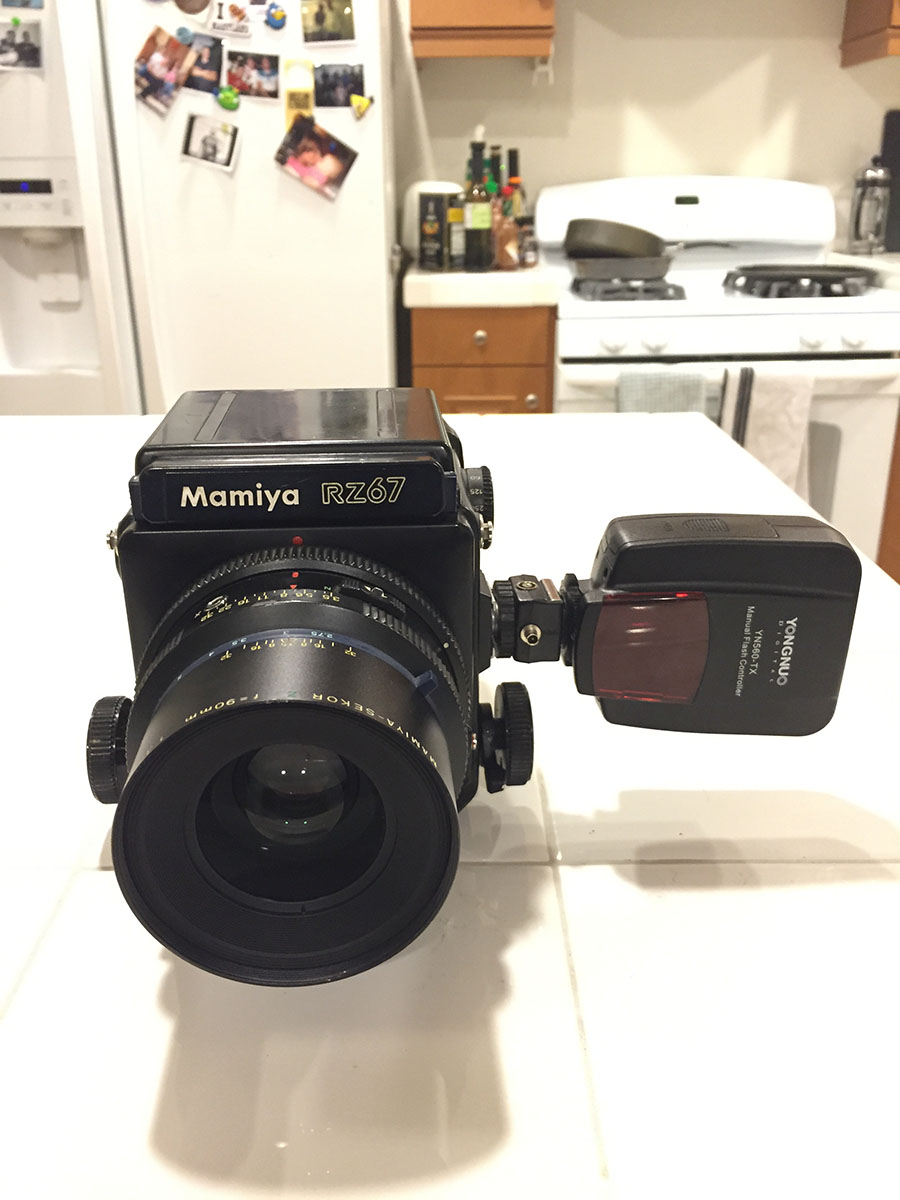

I'm trying to wirelessly trigger my Yongnuo 560IIIs. Here's the setup I would (ideally) like to use:
^YN560TX(manual flash controller) on hotshoe to fire my YN603IIIs. Well, even trying to wedge the pins in with a knife it wasn't happening. So, I tried a hotshoe adapter:

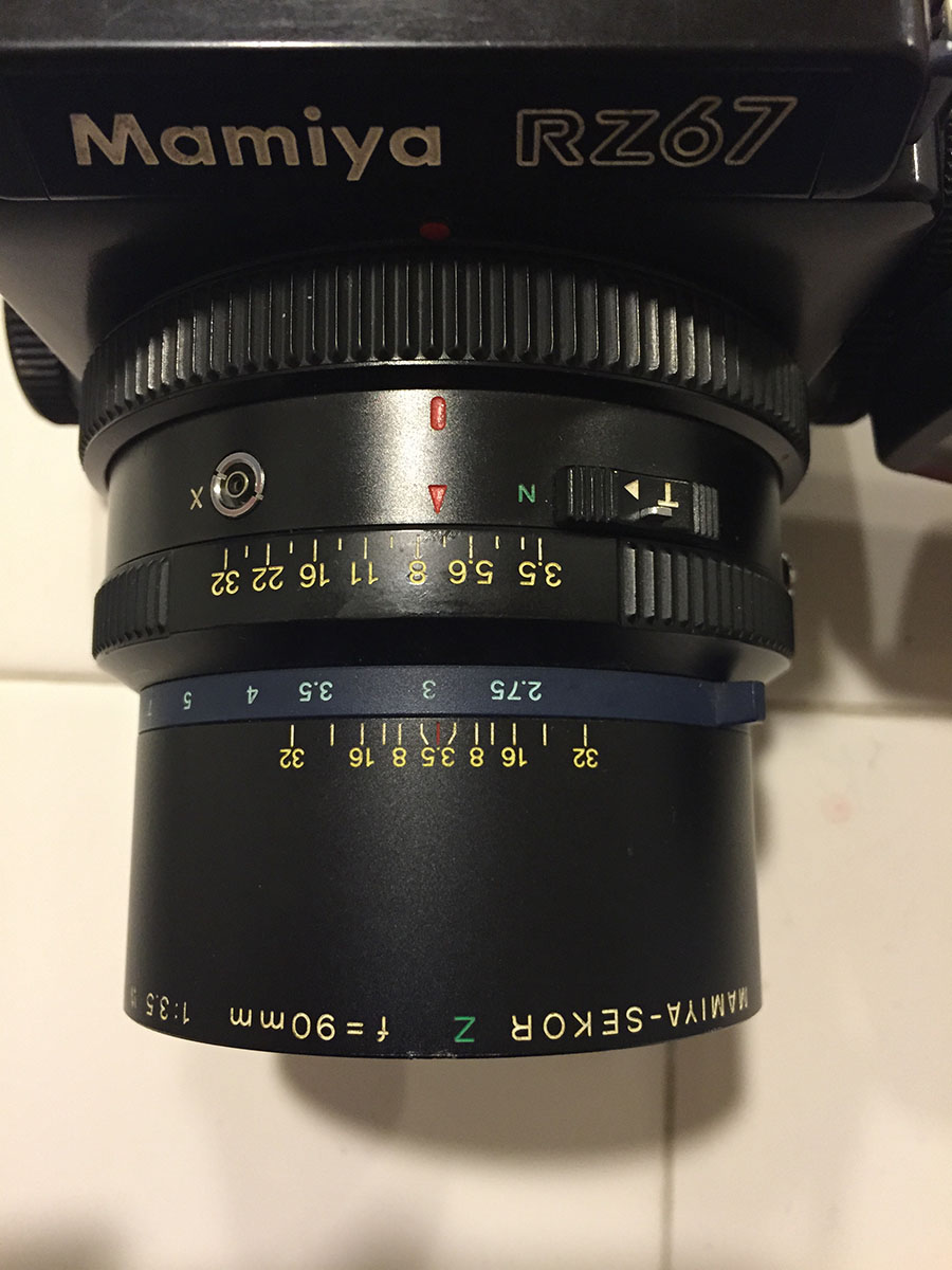

What does the N mean on the lens? T is long exposure yes? When I fire on M I have to turn that switch back over or it won't allow me to reset the shutter.

Ha, thanks. The 560TX won't even slide in and the 603 will only after wedging the pins in with a knife.

The T-N switch is covered in the manual :whistling:.
T is for mechanically operated time exposures. N allows the shutter to be controlled by the electronics in the camera. Nothing particularly relevant to use with flash.

N means normal. That should be on for normal operation.

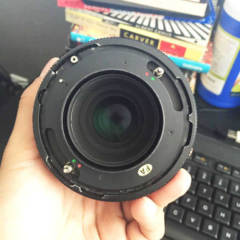

Sure enough! First, thanks for everybody's advice with my situation. Well, I noticed my lens mirror-up socket had not fully seated back into place after removing the cable release and thought I had found the cause of the x-sync not firing. Unfortunately, still no fire from the lens after that. However, relieving THAT issue now allowed the hotshoe to fire! This setup ended up working after trying everything else:
SO... I think what was happening is being unaware that the mirror-up socket had not fully retracted I wasn't completing the second (lens) shutter release to fire the hotshoe. After dong so releasing the shutter was firing the hotshoe!
As you gents stated the RF603 will only respond if getting signal from the camera. Works on my Canon A2 but no tamale on the RZ. BUT... the 560TX works great! Best case scenario really as I can remotely control three speedlites with it. Ultimately I'll have to see what's up with my lens sync socket.
Thanks again everybody!
