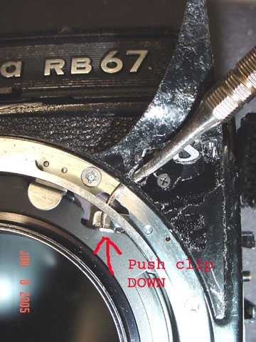

On the RBs its an easy fix to get a lens off. There is a hole at the top right corner of the front standard where you can insert a paper clip to push a lever that unlocks the lens. Ive never done it on an RZ though.
Let me see if I can find the photo of what Im talking about n post it here for you....
as you turn the lock ring, push the lever and wiggle the lens off.

look in this general area to find the hole? maybe an insignia cam be removed n the hole is under it?
maybe the plastic corner piece can be removed?
im sure a few other people here have a few remedies that worked for them. just be patient n dont force anything!

No little locking lever or paper clip hole on the RZ. Only way to remove it was through the bellows! I was quoted £120+VAT by the repair shop for just the lens removal.
they use expensive paper clips.
just out of curiosity... can you post a pic of the front standard with no lens mounted?
