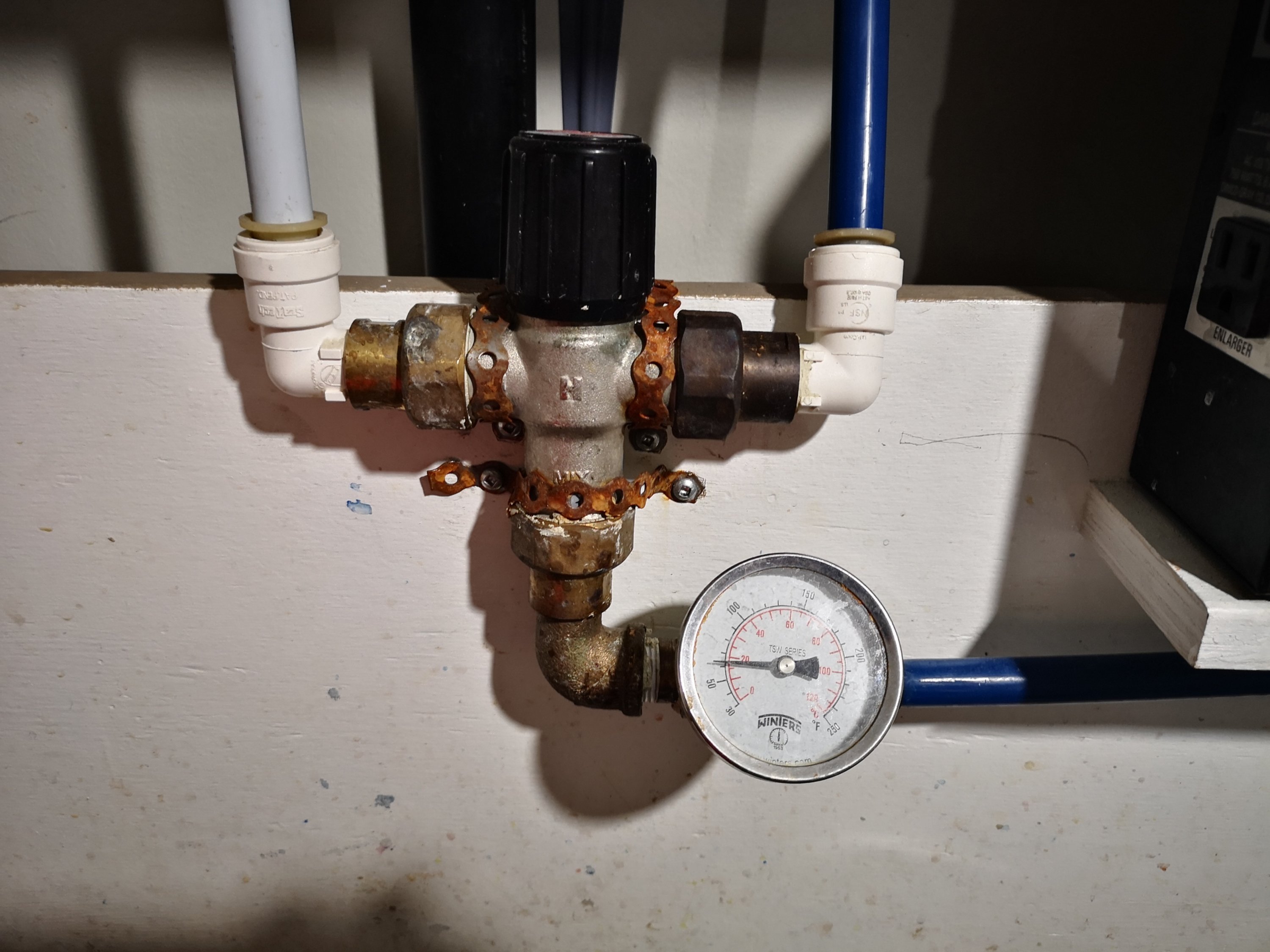

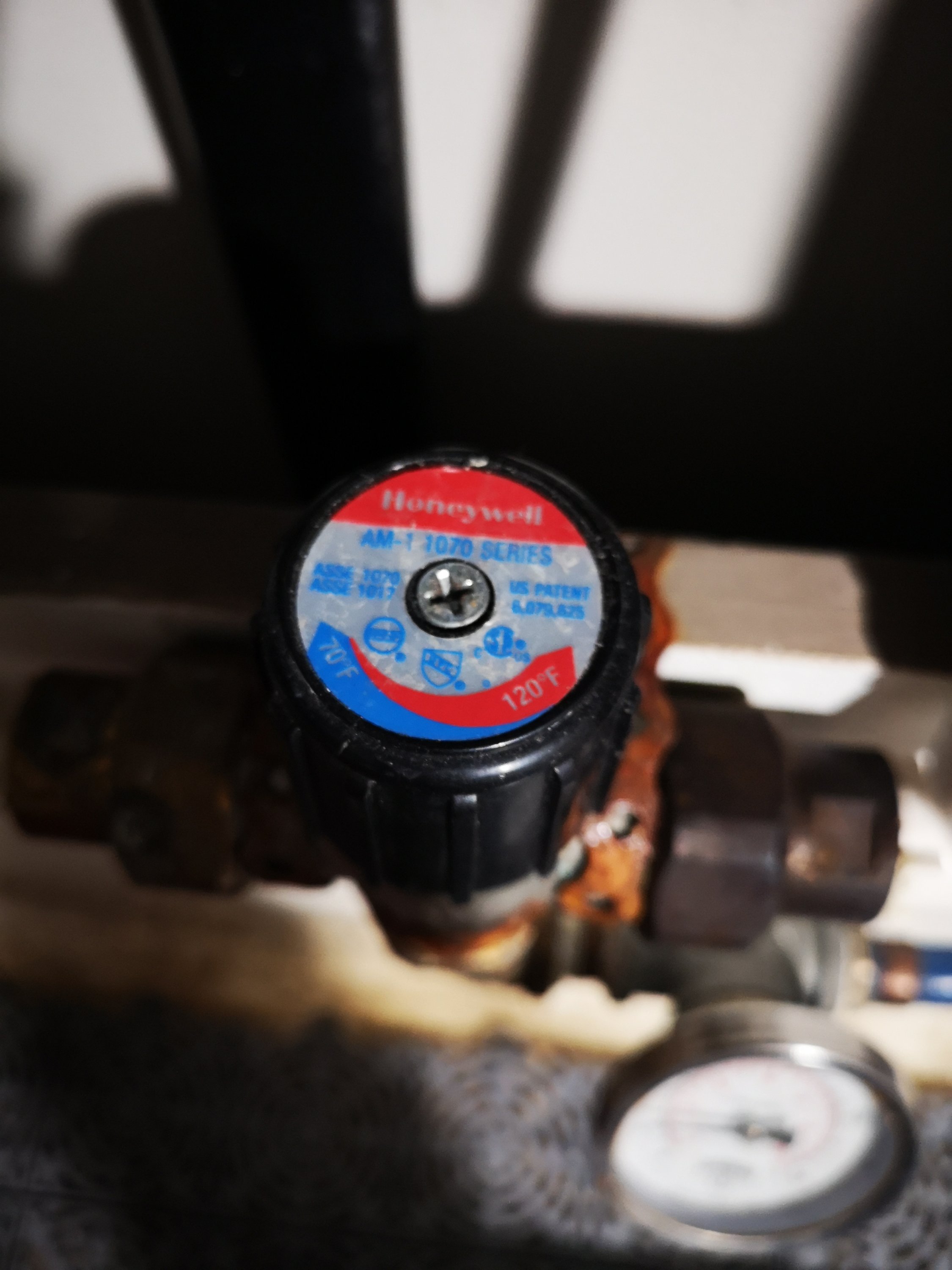

It's a thermostatic valve similar to the Honeywell one I posted above. Mine works just fine. I have it set at 21 C for my black and white needs but I did test it at 38 C as well. I plumbed in a temperature gauge on the outflow.
Do you have a thermometer in line so you can tell how consistent it is? I didnt click on your link when I first read it.
Yes I do although I just keep the set screw locked down at 21 C so it's not like it ever changes.

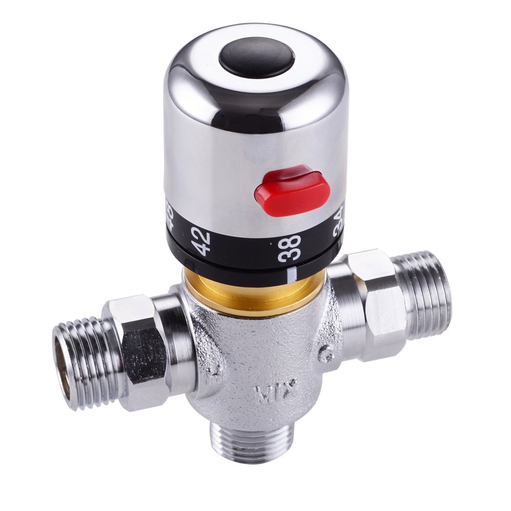

Also noted that the Amazon one does not have check valves built in whereas mine does. Without them when the water is off you will get backflow from whichever side has more pressure.
