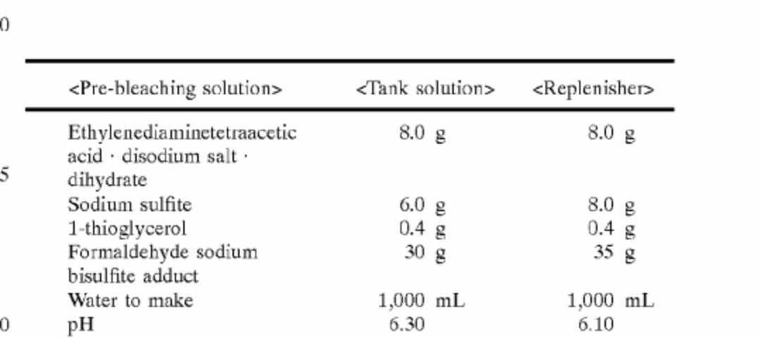

I join the conversation, I am using the pre-bleach proposed by Fuji, it uses few ingredients, here it is:
I did it is by adding the EDTA, then the sulfite, the pH increases so I add a few drops of acetic acid, in a solution Separately (70ml) I add 12g of sodium bisulfite and add Formol drop by drop (10ml) I add this to the mixture of EDTA and sulfite, at the end I add the bleach accelerator. Now from what I read here, perhaps the step you made with bisulfite and Formol is unnecessary.
Also, I only add bisulfite and not sulfite, which I don't like since it raises the pH.

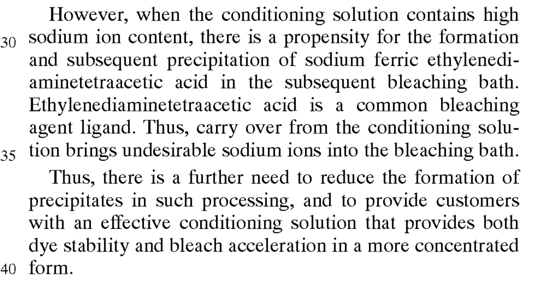

Review this Kodak patent (US 5962604) talks in more detail about pre-bleach, mentions the following:
so I am commenting on an error when using sodium bisulfite
As you can see, the Fuji bleach recipe has Sodium Sulfite as an ingredient, just about every E-6 bleach formula also has Na2-EDTA as ingredient. Small amounts of sodium salts obviously don't cause problems. What Kodak warns against are prebleaches with "high sodium content". The prebleach formula I derived from Kodak's patent is quite dilute and would therefore definitely not qualify as "high sodium content".
