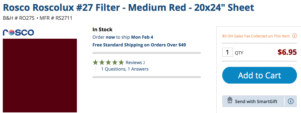

I looked into plain gels as well, but they are also expensive

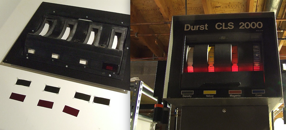

ic-racer
Feb 25, 2007
16,542
USA
I used the #27 in my enlarger to make it safe for B&W material. It came with olive color filters for some level of color material safety.
