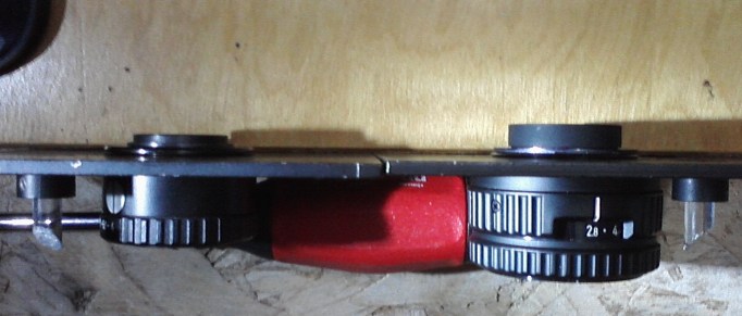

The El-Nikkor 50mm 2.8 lens does actually work now, I was using the lens board flipped over so the lens was in the shallow recess since I was trying to get it as high as possible to help solve my problem. This lens so barely fits under the sliding drawer in a 23c II (not the later type) that just the depth of the recess in the otherwise flat lens board is the difference between hitting it or not. So that problem is solved.

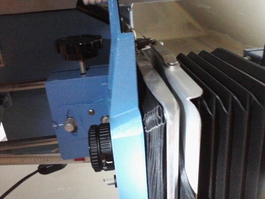

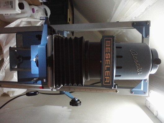

OK if these show up correctly they were taken with an 8x12 image in focus (just a random size). The right side focus knob is off of it in the pic because I am fixing it. The first pic is the S.K. 50mm F4 next to the El-Nikkor N 50mm F2.8 just to show you the size difference and why the Nikkor was originally hitting the filter tray by half the height of a lens boards thickness. All parts involved except the lenses are Beseler brand.
We seem to have established that what I have going on is not correct (repeatedly) but if someone that actually has a 23c II could take a 50mm lens with the enlarger set for 35mm and get an 8x12 image in focus to show me how much the lower bellows is supposed to be compressed that would be helpful.
If these pictures are not good enough or do not show what you need please tell me what you require.

This is how it measures for my enlarger, and I don't see why it wouldn't be the same for any other enlarger on earth...
From the Easel to the Negative Carrier, about 21 1/4 inches.
From the Easel to the Lens Board, about 18 3/4 inches.
The difference is a couple inches which should be room for the bellows to expand a little.

OK cool, I have about: (hard to measure lens board super accurate from underneath)
21 1/2 to the center of the negative carrier
19 3/4 to the lens board
If I use the S.K. 50mm it makes the lens board about 1/4" lower in height or so which is about the height difference between the two lenses if you look at the pics so that makes sense.
Assuming that was an 8x12 image from a 35mm negative where am I losing a whole inch? Focusing is universal math last I checked. An inch would be all I would need to uncompress the bellows.
I have seen this same topic in a number of other threads on the net so it doesn't seem to be unique to me but common to 50mm and the 23c II though I still don't have a clue whats wrong.

Middle of nowhere central Wisconsin, but the problem is the 23c is super simple, there's not really anything to adjust that I can think of that would allow the same focus with the lens and film farther apart, seems to be a fixed bit of math to have film, lens and easel a certain distance apart to be in focus.
Until I hear differently from someone with the same unit, this is just how it is with a 50mm lens for 35mm film I think, the cadet is actually the 35mm unit from Beseler and like I said the 23c was apparently designed for medium format with an 80mm or so lens which would put the focus point right smack in the middle of the adjustment range.

Is everything square? One of your photographs looks like the negative carrier is not true, but it could be an illusion.
What if you hold the lens loose out in space... If you get the same differences, where you lose a whole inch compared to me, maybe you have a lens with a defect. Is there any evidence of tampering? Maybe the previous owner took it apart to clean it and put it back together wrong.

Its probably the bellows that makes things look crooked as the folds aren't 100% square, and the funny angle of the picture. I am getting basically the same results with 2 different brand 50mm lenses on 2 different Beseler brand lens boards.
I don't know the units history from the late 60's when it was made till now, but if you can think of anything that could be changed to make a 50mm lens focus at a different distance from the film without changing the distance between the film and easel I am willing to try it.
EDIT: Sorry, everybody posted at once, I just checked it and its about 2" internally from film holder to lens board.
2nd edit: just to clarify since I'm thinking some people might have missed it, this is actually working fine as is, the only question now is whether or not the focus bellows is supposed to be almost fully compressed with a 50mm lens and 35mm film. What I read in other threads would lead me to indicate this is normal, but if someone else has a 23c II and wants to duplicate the experiment to check I would be very happy.
