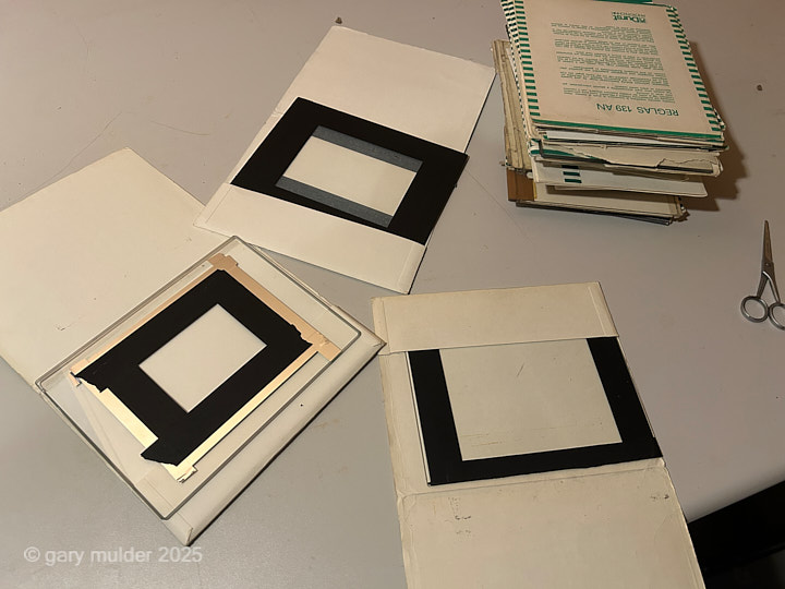

No, it won't, it's not a good idea to file the masking blades, and it will in many cases not even work at all. The masking blades are too far away from the film plane to create a sufficiently sharp border; it'll be a fuzzy zone unless you're working with a point source enlarger. Furthermore, the masking blades don't always move all the way to the center of the light beam area (although this depends on the specific enlarger), in which case filing them will not make a difference to begin with. And, first but foremost: the masking blades are movable. There's no point in filing them - just move them to the desired position. But as said, this won't create the kind of borders OP is looking for.
You could try cardboard. It would be a simple non-destructive experiment.
Cardboard works; I've done that many times. 3D printed plastic (e.g. PLA) masks work, too, and give somewhat cleaner edges, although these can also be shaped at will.
If you're going to 3Dp them, use a fuzzy edge setting.
I've done ragged-edge and unsharp masks with solid-core cardboard, scrap mat, thick watercolor paper, etc. both on the negative stage and the paper. You can also create some interesting effects with edge dodges and burns; those are also hard to replicate between prints, so it gives a bit more uniqueness to each.

I used thin plastic for making stencils and a pen-knife. The idea was to make them perfect but that's not easy without a machine.
The plastic was black 7.5 mil PET.

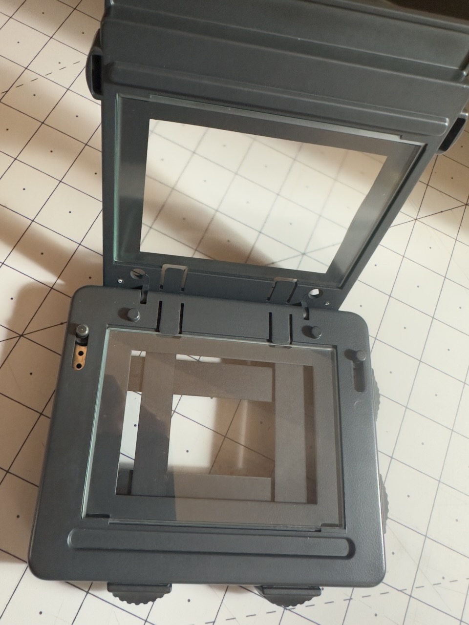

If you want “that look” you could get some used Omega or Beseler glassless negative carriers and file them.
The ghosts and fuzzy look comes from the hand work done to widen the openings.
What look do you get if you just open your blades a little?

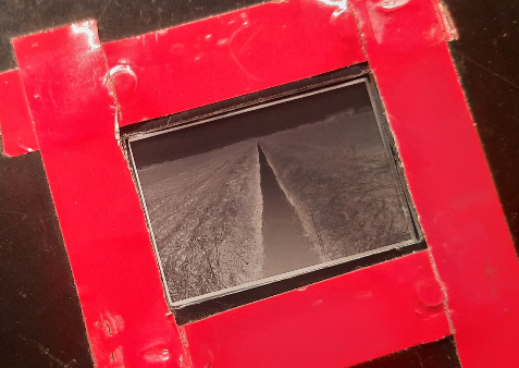

I made several masks for both 35mm and 6x6, but I can only get them sharp at F/16. At F/11, they’re generally sharp but slightly blurry when looking closely. At F/8, which I use for most of my prints, the edges are too blurry for my taste. You wouldn’t notice it from a distance, but I don’t view my 8x10 prints that way, and the blurry edge is distracting.
My enlarger has a film carrier where the negative is sandwiched between two glass plates. I place the mask on top of the bottom glass, with the negative resting above it. The mask is very thin, less than 1mm
Has anyone managed to achieve tack-sharp edges, as sharp as the grain in a negative? Is it even possible at F/8?
It probably depends on the distance between the lens and the negative, as well as the focal length. I’ll definitely keep testing various print sizes and lenses, but in order to adopt these edges, it must work consistently.

In addition to the many options listed, Beseler made a 35mm "full-frame" carrier for, at least, their 4x5 enlargers (#8302). The "cut" is 25x37mm. Perhaps other enlargers make similar negative carriers. These can also be 3D printed. In fact that's exactly what BitByBit Photo does --for Beseler, Devere, Durst, Omega, Saunders, etc. I got special, customized submini carriers from them -- no extra charge!
https://www.bitbybitphoto.com/
Other options, as mentioned are masking oversized GLASS or glassless carriers.

Ok maybe I exaggerated by comparing it to film grain. I just want it to be as sharp as the rest of the image when viewed from a normal distance, without noticeable blurry edges. Since I’m achieving that with f/16 and almost with f/11, maybe a thinner material like gaff tape could work at f/8.
About the glass—this cardboard is very thin and weak, and I think it would bend if inserted into the carrier without glass. If less than 1mm makes such a difference in sharpness, who knows how blurry the image would be if it bends in the middle without glass. So far, with glass on both sides and the cardboard in between, the image is tack sharp.

Mostly because of the extended exposure times. Lately, I’ve been doing a lot of lith printing, and the times are quite long. I’m also not sure about defringing at f/16—I’ve never really tested my lenses for that. But f/8 always seems like a sweet spot.
I see differences at less than a millimeter of focusing depth; they're the bane of my existence. Negative pops, tiny focusing errors, coarse focal adjustments on the enlarger...all of them are pretty tiny, but they ruin sharpness for me consistently. But hey, if you're not seeing a problem: don't change anything. If it works, it works.
My current setup is well aligned, from the baseboard to the negative carrier. It’s just the mask border that’s a bit blurry.
Anyway, gaff tape sounds promising. I’ll report the results.
