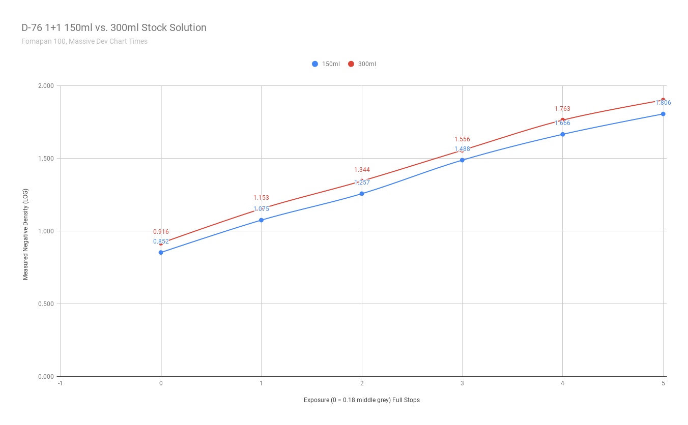

Here's the data I did. Both rolls had the same exposure, both were developed in D-76 1+1 at the same temperature and same development time. The only difference between the two is 1 had 150ml stock solution for a total of 300ml, and one had 300ml stock solution for a total of 600ml.
Using less than 150ml will result in less density.
Also, as @MattKing said earlier, the density difference will vary based on how much the exposure varied for the subject being photographed when using smaller amounts of D-76. However, it can and does produce a measurable difference in the negative density when using less developer if everything else remains equal.

both rolls where 24 exposures and had exactly the same images between them, so this is essentially best case. If you shot a full 36 and they were all high contrast, you’d see an even bigger difference.
Thanks for the graphs, Adrian. There looks to be good evidence that 300ml of stock v 150ml does make a difference
On an all other things being equal what does this equate to in terms of a print from each neg. Where is the difference likely to show and is such a difference easily recognisable to the viewer of the two prints in terms of a clear improvement.

Maybe I can propose some answer. The contrast (slope) between the "0" and the "4" points is 0.7058 for the red curve (300ml stock) and 0.6783 for the blue curve (150ml stock); and yes these are higher than the usual C.I. or G-bar values, because they are for the local gamma, perfectly normal. The ratio of these two gamma values is 0.9610, a 4% difference. Assuming the "red curve" negative would give an ideal print on grade 2 (ISO R-value 100), the "blue curve" negative would require, to provide a print of the same contrast, an ISO R-value of 96 (0.96x100). Grade 3 is ISO R=80. In other words, the difference is about 1/4 paper grade (slightly less).

The challenge when doing this analysis is that Adrian's test involves 24 exposure rolls, not 36 exposure rolls, so developer exhaustion probably doesn't need to be factored in.
In addition, Adrian's test probably doesn't involve a high key subject or anything else that might increase the likelihood of developer exhaustion.

The thing to keep in mind here is this was for one film stock, with only only 24 exposures, none of which were high contrast. I developed each roll for the same amount of time, used the same temperature, and did the same agitation, which was 30 seconds initial, then 4 inversions at the top of every minute. I got the development time from massive dev chart. If you’re using a 250ml tank with only 125ml of stock, and everything else is equal, you’ll see an even bigger difference.
now imagine you’ve chosen an emulsion that is going to be your go to emulsion for most of your shooting and you’re trying to nail down a standardization for your normal, and N+/N- times for making prints. Not using enough developer is going to result in a different amount of negative contrast for every roll you shoot because the content of the scene will effect that. You might as well not have a standard negative, and shoot it however you like and use the minimum amount of developer possible because you’re going to be spending a fair amount of time on each image working out a print time and print grade. If you enjoy spending time in the darkroom and don’t mind doing that, then great. You have nothing to worry about. However, if time is money, then the cost difference of 300ml of stock per roll is nothing compared to the time spent dealing with a non-standard negative.

I designed this particular test to see if a scenario that was least likely to induce a change in density actually did. Turns out, yep, it does, which for me in my lab means use a full 300ml per roll. Developer is cheap compared to the cost of time.

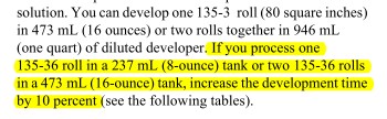

Thanks the data would be useful. By the way is there an actual reference to 250ml or 300ml minimum stock quantity in either the Ilford or Kodak instructions and if so where is this to be found?
What has always made me question the minimum quantity of 250ml/300ml of D76/ID11 or Perceptol is why would a reputable company such as Ilford give a 1+3 ratio for Perceptol and not say in its instructions that in the case of 1+3 dilutions this means using a tank that holds 1 litre of fluid and that anything smaller carries risks of poor highlight densities and in the case of 135 film which is usually developed in 250 mls tanks the risks are so serious as to be almost inevitable. Indeed in the case of Perceptol I wrote to Ilford and received the reply that 75ml would be what it would regard as safe for satisfactorily developed negs. If Ilford has clearly established that 250ml is the minimum then I would have expected it to have warned me that anything less might work but using one quarter ( i.e. the 75ml it quoted) of its stated minimum stock quantity was inviting unsatisfactorily developed negs
The OP has reported that his negs at 1+3 as looking OK and if 250ml is the minimum then even if the film is 120 the best he will get into a Paterson tank is 150ml which is still a long way short of the 250ml/300ml that you say is needed. At 100/150ml short of the minimum stock that is said to be required by Ilford or Kodak I'd have expected the problem to which you refer to have shown up
So yes any reference to a stated 250ml/300ml minimum stock quantity would be useful
pentaxuser
Re: minimum amount of developer needed. Anchell and Troop say that although Kodak cited a smaller amount (150 ml x roll) of undiluted developer needed, that Kodak acknowledged that this was the bare minimum needed to achieve somewhat satisfactory results and much better results could be achieved using 250 ml of undiluted developer per roll (80 sq. inches). Anchell and Troop attributed the pretext for the lower number was for commercial labs using Versamat machine processors to achieve the greatest economy. (The Darkroom Cookroom 3rd Ed.)
