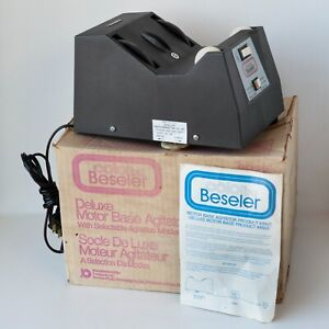

I use a Beseler Rotary agitator with Paterson tanks.
Here is a photo with another alternative - it shows a way to use steel reel tanks, as long as you don't mind the clatter.
Here is an internet pic of the agitator:
It is slightly smaller than the light source on logan2z's enlarger :smile:
But neither one has the temperature controls of the Jobo processors.
I always process black and white film at the ambient room temperature, adjusting development time appropriately.
