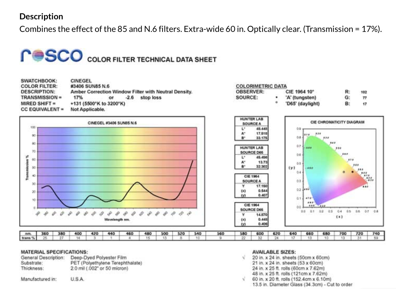

Thanks all - I will be testing my existing setup prior to making any changes (thanks Pieter12!). Also great resource, redessert, I compared the Kodak OC transmission curve to a typical Roscolux (you can get all the Rosco transmission curves here: https://us.rosco.com/en/products/catalog/roscolux
Here's the Kodak OC transmission curve, which is below 1% transmission between approx. 650 and 825 nm.
Compare that to the curve for a Roscolux Roscosun 85 + .6ND
The transmission ranges from 24% to 59% over roughly the same range. Perhaps doubling up the Roscolux filters or adding more ND could get closer to the OC, or possibly sandwiching in a different color Roscolux which has a lower transmission between 680 and 800 nm?
