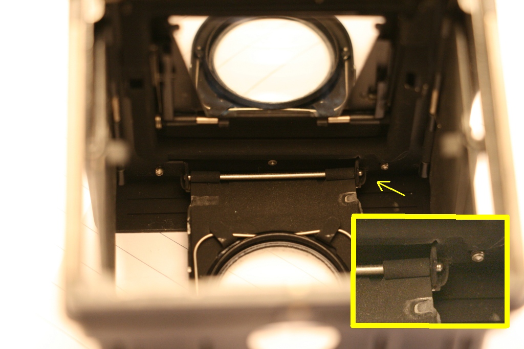

I recently obtained a very nice Rolleiflex 3.5 (S/N 2827435). It is excellent condition with the single exception that the waist level finder magnifier will not stay locked in any position. It swings freely and that makes focusing and composing a bit of a problem sometimes. Does anyone have a photo or diagram of the focusing magnifier or other information that would give me some idea of how it was made and how to repair it.
Thanks
Dennis

The magnifier stays open because of two tiny bits of metal sheet:
I looked at my 3,5F / model 3, serial number 2.283.653 (a late model 3 around 1964). Should be identical to yours.

Thank you, that is precisely what I wanted. My magnifier is missing that small piece, it has fallen off at some point in time. I will need to find a replacement magnifier bracket or some type of repair will have to be made to the bracket.
