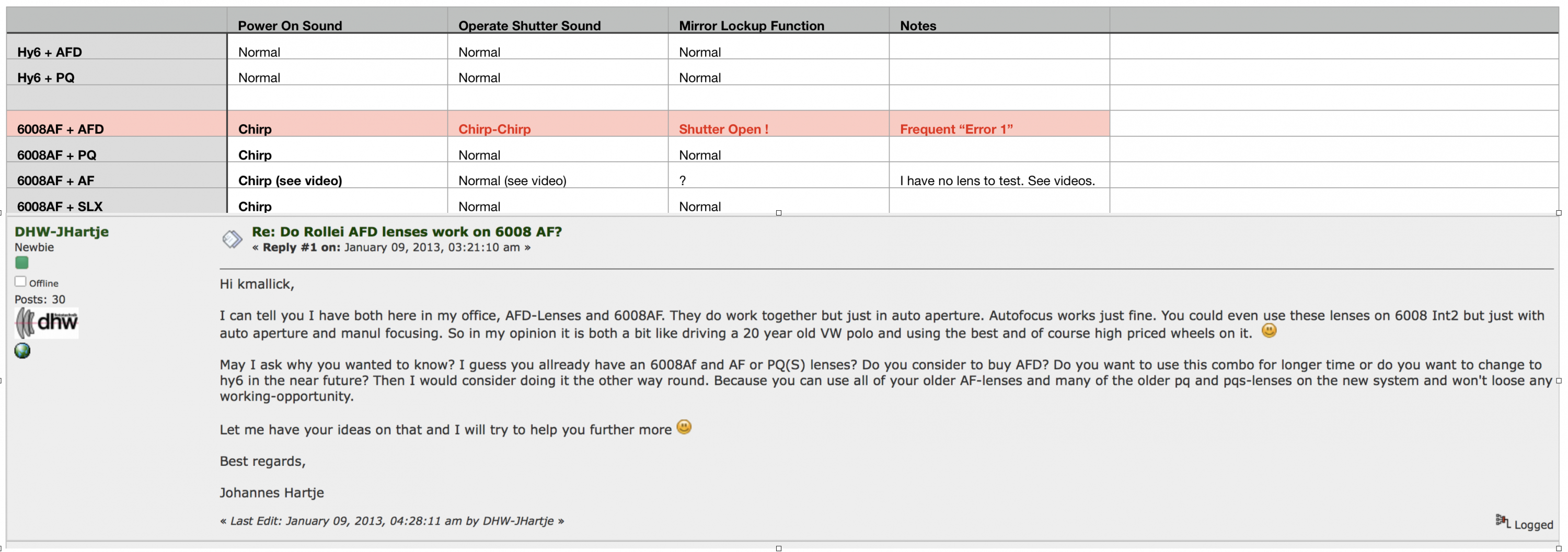

My 6008AF, which is new old stock, does not work with AFD lenses. I'm pretty sure is designed to autofocus only with autofocus lenses with an aperture ring. What kind of lens are you using?
One way to check if a lens will work on the 6008AF is to use the mirror-up button. If the shutter stays open when the mirror goes up, then the lens will not work correctly.

Some of my results of swapping lenses between 6008i, 6008AF and Hy6:

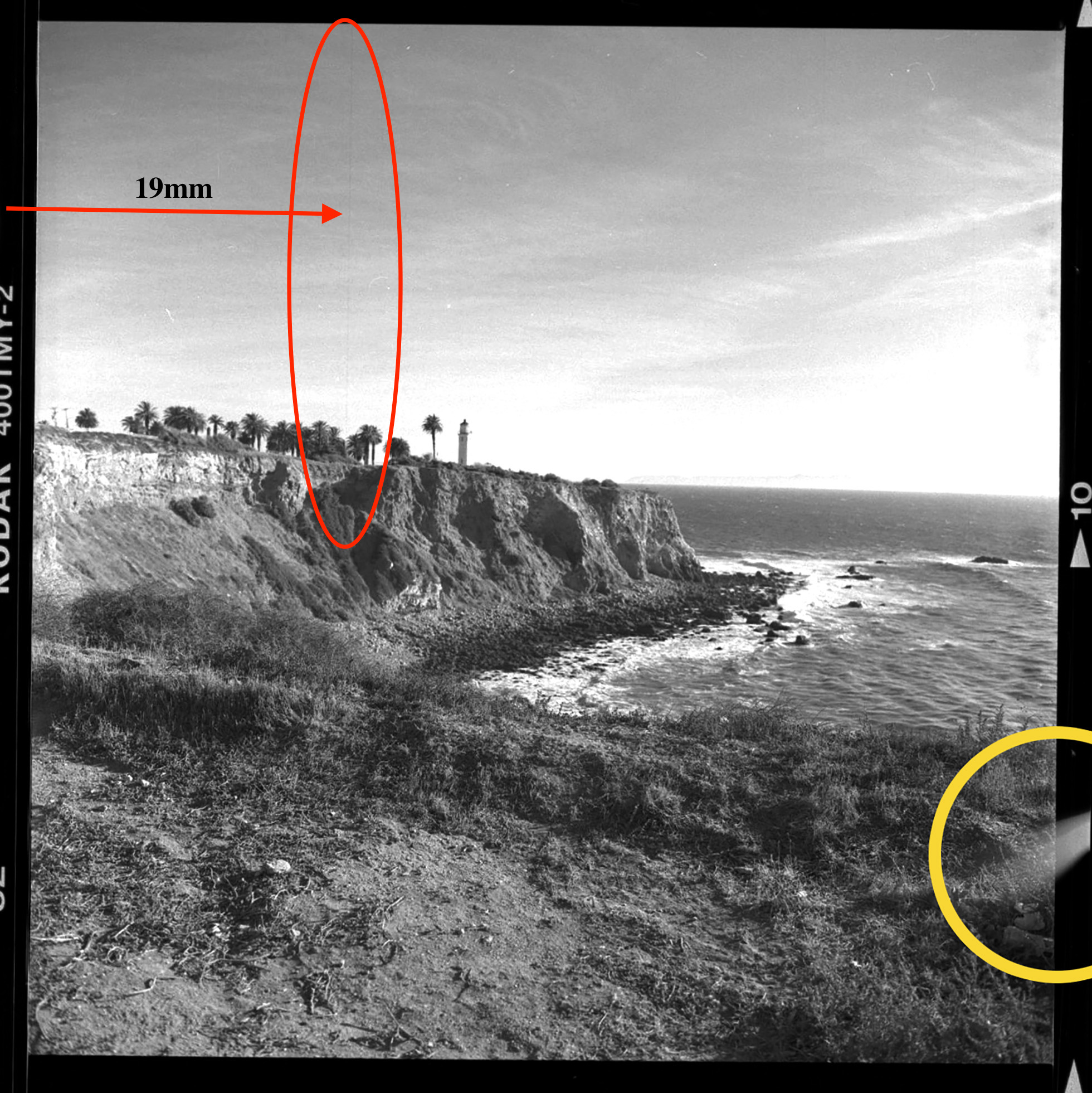

I have literally torn my film magazine apart looking for the source of the scratch. I track problems like this at work, so it is part of what I do for a living. But I still can't find the offending item causing the scratch. At this point I'm even considering Aliens from outer space or something poking out of the camera into the film channel.
Well, I measured it in multiple places and mine is actually 19.7 mm from the OTHER edge of the film (emulsion side). Also, the scratch is not constant for the entire length of the film. It disappears and comes back. It is noticeable without a loupe, but it is a very fine scratch.

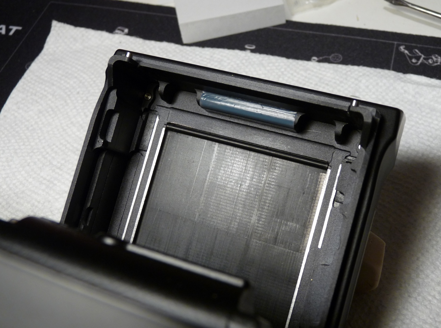

This makes me think it might have something to do with that bluish Teflon tape thingy at the top (non-hinge) side of the back. The ends of that blue Teflon are about 19mm from the edges of the film, but I don't see how the film comes into contact with it. On the other hand, there must be some reason why they put that thing there.

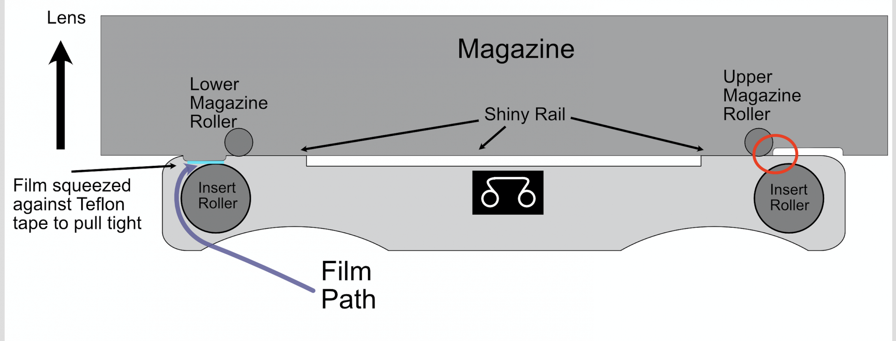

The scratch can show a slight variation from the edge of the film about 1.5mm, in my case, is always the same distance from the edge of the projected frame border. This proves the scratch originates in the camera.
My rollers, on 8x examination, are covered with imperfections, but nothing that matches the scratch.
There are numerous items that might be culprits, but nothing matches the exact measurement. I put a lot of additional teflon tape covering the interior but the scratch persists.
I replaced the Teflon tape on which the lower roller rides in my magazine and the scratch stayed in the same location, so it was not an imperfection on the original Teflon tape.
With the Teflon tape removed, the roller forces the film agains the rough aluminum casing causing hundreds of scratches.

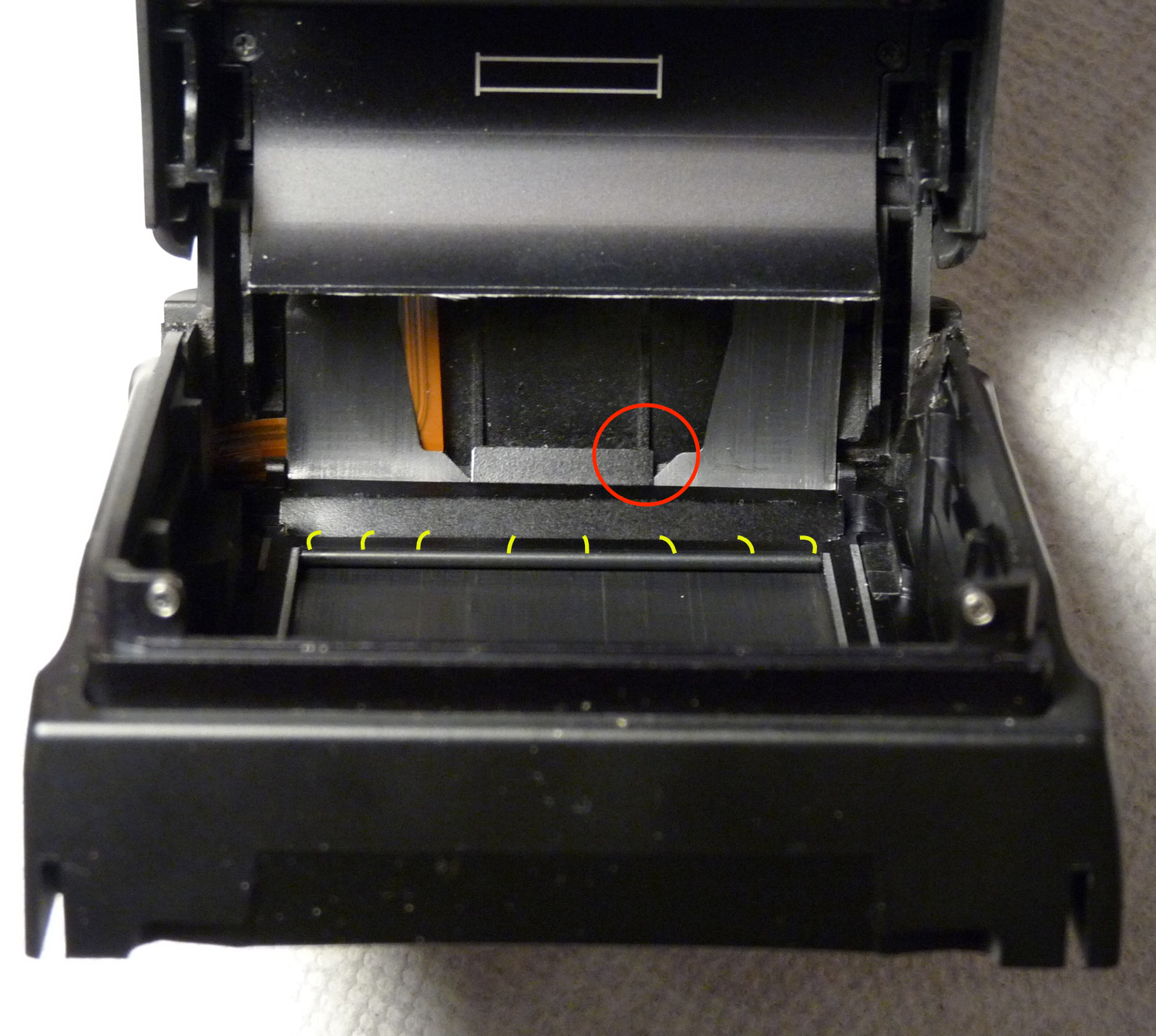

ic-racer
Feb 25, 2007
16,752
USA
The sharp edge in the circle ALMOST matches the measurement from the frame edge, but teflon tape covering that area did not make the scratch go away.

I thought I saw a burr with 8x loupe in the area indicated with the red circle, at the correct measured area to cause the scratch. I was almost certain this fixed it, but recent rolls of film still show the scratch. Also, it would be unusual for a random burr to be in the same place on multiple magazines.
