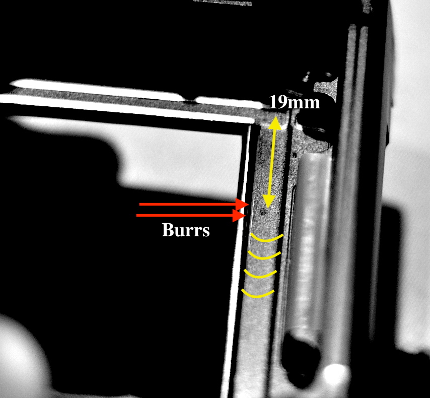

I made a mark with a Sharpie 19mm from the edge. This is the area of the magazine where the film passes AFTER exposure. It is formed with a trough so the film won't touch the housing. This is the area circled in the diagram in post #22 above.
However, I did see a couple burrs. I also took a piece of film and dragged it across here and got a scratch. I have smoothed them.
This did not make it go away. Most frames are OK but still the occasional scratch in the same 19mm location. So maybe this is not it? Maybe they need to be smoothed some more? Maybe keep looking.
I don't see anything similar in that area on mine, but don't have a decent magnifier smalled enough to get in there. My loupe is too big, so I'm using a magnifying glass. If there is a slight irregularity in the surface, I am not sure I'd even see it. But, that has to be the most likely area for the scratch to be induced, especially if the problem is common to all three of our film backs. I don't have Teflon tape on the hinge side like you do, so it's unlikely that there could be a defect on that side capable of causing a similar scratch on all three backs.
I wonder if the insert shifts inside the clamshell when the film is advanced. Because of the spring, the insert is not loose inside the back when it's closed, but when the drive gear starts turning, it could be applying quite a bit of force. That force would be greater if the film take-up spool isn't rotating freely. I was thinking that the force may actually shift the insert slightly in the direction of the non-hinged side, possibly forcing the large roller and film up against the edge of the trough. Sounds far fetched, but I'm just tryin' to think of all possibilities here. Of course, the scratch would still need to be caused by some irregularity in the trough and that irregularity would have to be common to all three backs... Every time I think I might be on to something, I talk myself out of it.
Cotton swab across area to see if it snags on a burr?
Fine sharpening stone to polish the surface?
