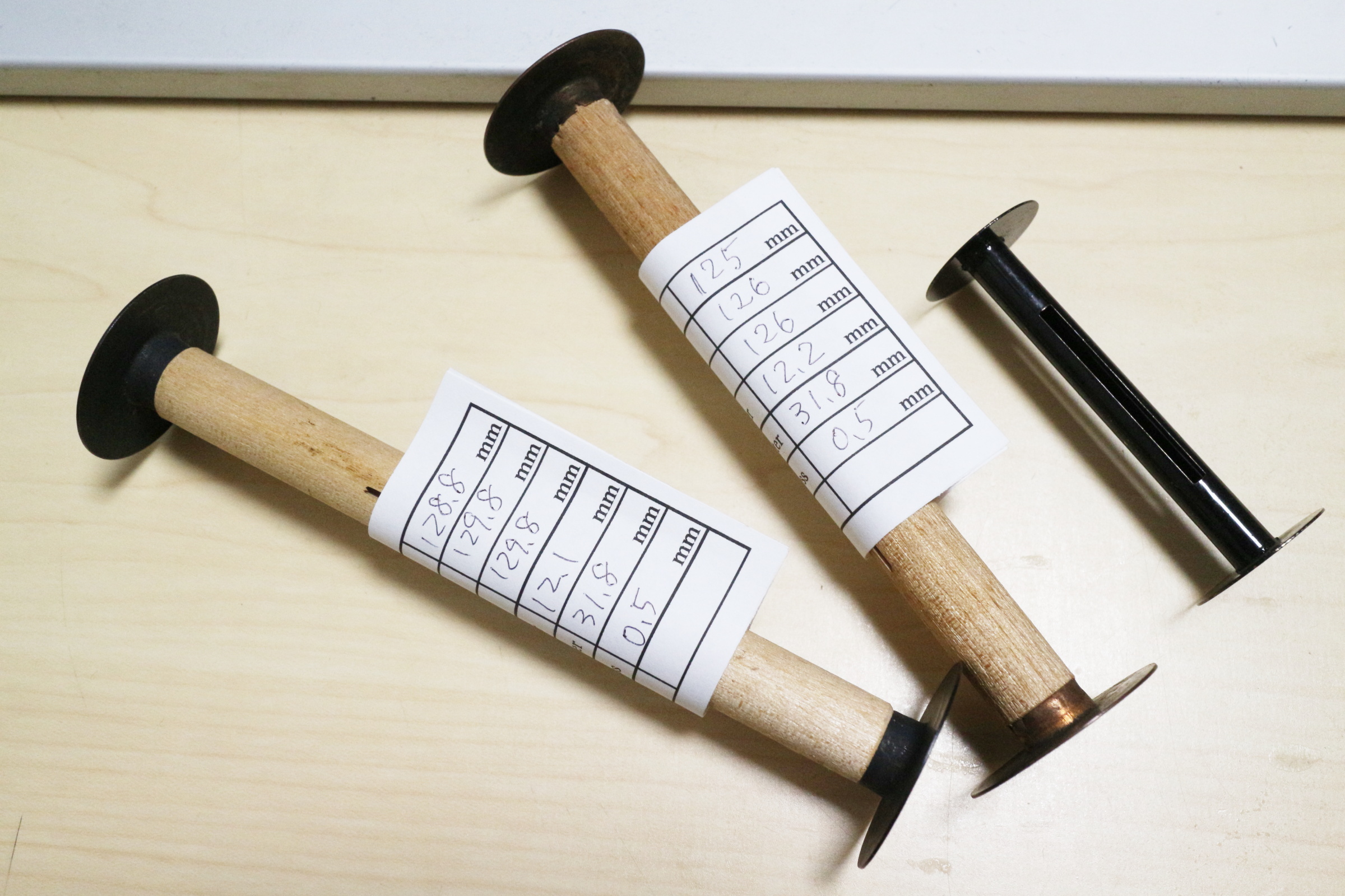

I have a question I'd like to ask.
Two film spools whose the numbers of which I'm not sure. One is 129.8mm long, and the other is 126mm long. Both have a wooden shaft about 12mm thick with 31.8mm metal flanges and are stamped KODAK.
Does anyone know what numbers these spools are?
By the way 123rollfilm is 119.5mm long, so it's different.
620 spool is for comparison.

Are the dimensions you quote overall, including the thickness of the flanges, or the distance between the two flanges?
Both sound like the distance between the flanges would be suitable for 5 inch wide film with backing paper on it.
Looks to be spools for 110 (large format 4x5 rollfilm, not to be confused with the "instamatic" film) and 104 (large format 4 3/4 x 3 3/4 rollfilm)

Incidentally, when I measured the nearly 100 old film spools I had collected (by clamping them in various places with vernier calipers), I learned that for most film sizes, the flange thickness is standardized to 0.5mm (25/128 inches?) and the diameter is 1.25 inches.
The numbers I gave in my question were the size including the flanges, and subtracting 1mm from that is the distance between the flanges.

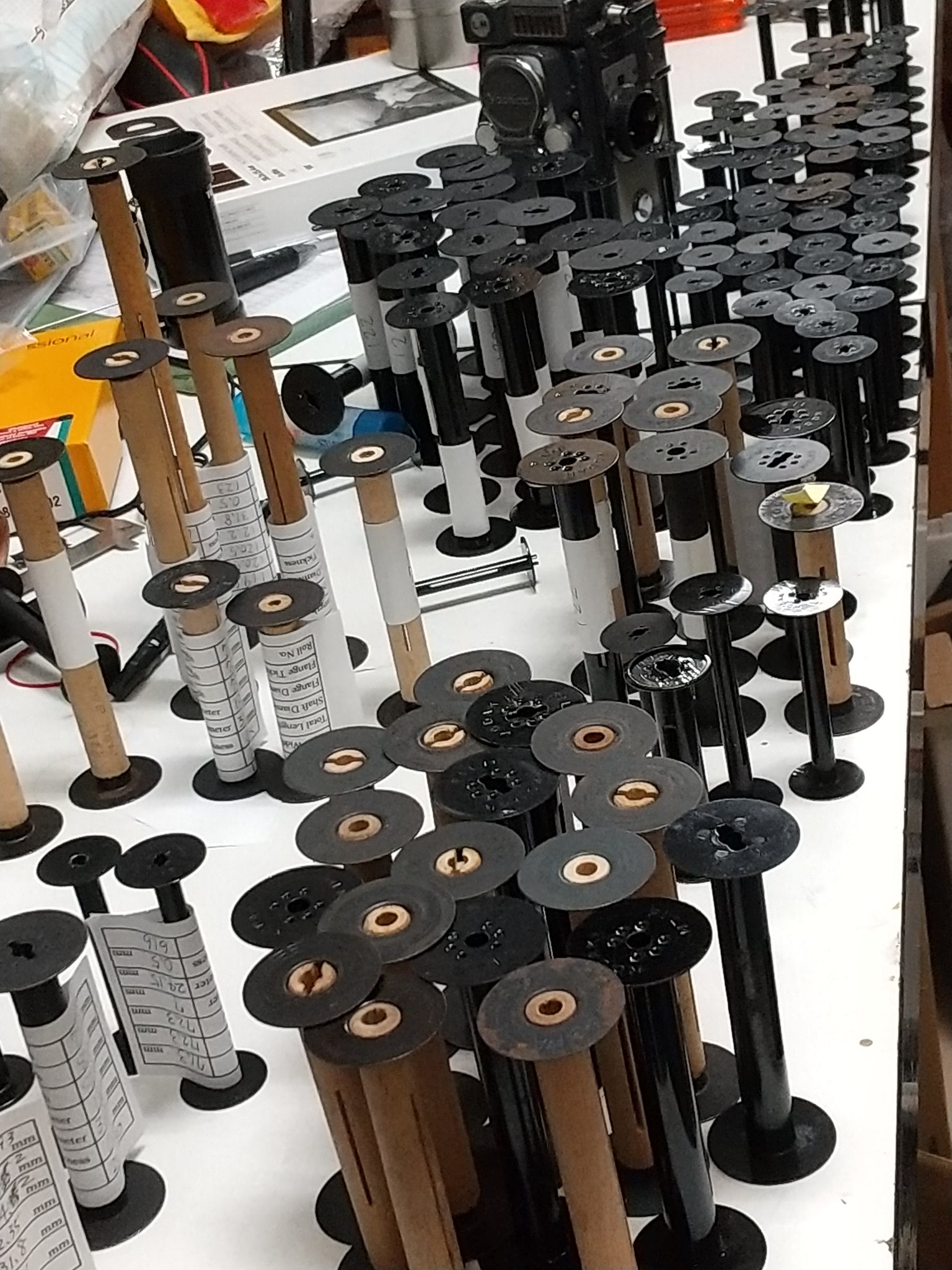

I'm currently sorting through a pile of spools that I won at auction in order to research film formats.
It seems that a camera collector who has now passed away removed the spools from the cameras he collected and stored them separately. I believe the reason his grandson decided to sell them instead of throwing them away was because he had a good number of them.
There are relatively many 118 and 122 spools, but there are also some rare 101, 105, and 115 spools here and there. Kodak cameras that use these spools were also being put up for auction at the same time. It was quite a nice collection.

Oh my that's awesome. I have managed to get a few 122 spools with the backing paper. My ongoing dream is to find a way to respool these with film and resurrect a Kodak 3A camera and make postcards! I have a small letter press that I can print the back.
I've never seen so many spools. George Eastman Museum in Rochester is where I would start. I think Todd Gunderson is involved with all the objects, not sure of the name??

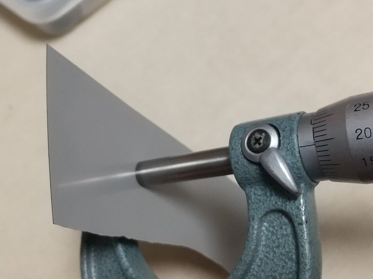

I also bought some 9cm x 50ft film to revive my 3A FPK and it's sitting in the fridge. Just to be sure, I cut off a end of the film and measured its thickness, which was 0.195mm (about 1/128 inch).
It's much feel like thicker and harder than the original film sheet.

Is it a polyester base?? I suppose that the early 122 film is nitrate, later an ordinary acetate, I'm not sure??? Original 122 would not have been polyester. Could be Ilford is just slitting sheet film stock.
The 120 roll films on polyester are "stiffer" not sure that's the right word, but stand out straight(er) than acetate. I noticed this right away first time I processed Kodak Gold 120, actually seemed easy to load the developing spiral/reel.
