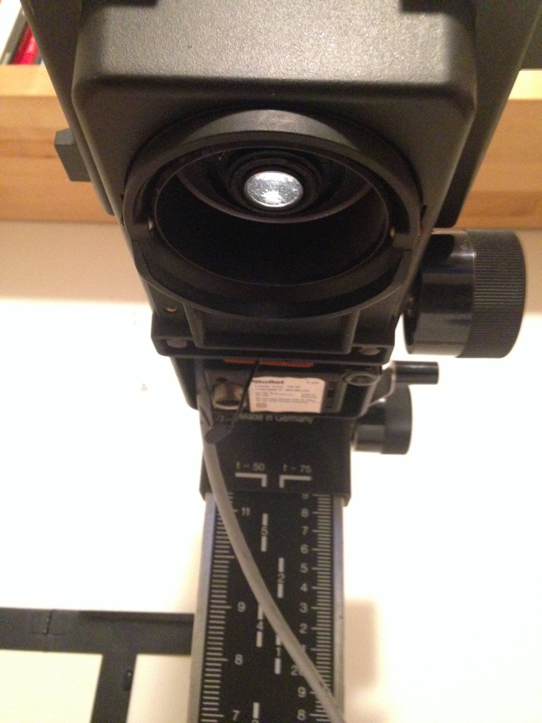

Hello... many years have passed since this post but I have since been given a Rolleimat Universal enlarger. I am struggling to understand how the lens is attached and how to change it. If anyone has suggestions please let me know!
@Carko: You might to PM the OP either on here or / and via his website (under his 'Information, via his name on the left), as he only seems to come on here about every 6 months, so it might be a long wait otherwise (if you are lucky) for him to reply.
In the mean time, you never know, but someone else might answer your question. :smile:
