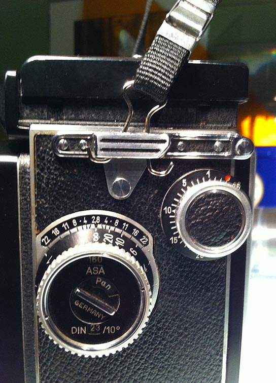

Just wanted to share my solution for attaching a strap to my Rolleiflex 2.8C. Although it looks like you should be able to feed a strap straight through the slot on the body, I found that the webbing on all my straps was too thick. I was thinking about forming something out of wire when it hit me - binder clips! Removing the wires from a medium sized clip, I bent the ends up and out a bit to hook onto the bar on the body. Even when pulled at an angle, it would take a considerable force to pull right out and they won't slip out no matter how the strap is jiggled around.

Clever!

But I would feel more safe if it would attach directly to the same bolt as the original clamps. To protect the WLF you need the guideance of the bolt.
It is ridicolous how complicated it is to use a strap on these cameras :D

excelent idea!
the only worry i have is excessive wear on metal to metal parts.

excelent idea!
There is likely to be some wear, although I doubt it would affect the integrity of either part as they are both steel. It's a pity the Hassy connector won't fit through the slot, but the 2 angles on it are too acute. This means that the strap ends will rotate as the camera swings on the strap, & that's where the wear comes in.
I wish someone would offer an aftermarket copy of the original strap connectors!
I think you guys are talking about two types of Rolleiflex straps:
1. The older models such as the C use a plain strap that goes under the metal slot and then over a stud. Solution: buy or find an older narrow SLR nylon strap (not the idiot braided banjo straps of the type sold at mass market stores). Remove the the end and neatly cut a slot that will fit over the stud. Burn the nylon to prevent unraveling.
2. The Rolleiflex E, F and possibly the FX use a strap with the metal "scissors" clips. These are great because they are quick to remove if you take the camera in and out of the case or mount to a tripod and don't want the strap in the way. Rather than spend time looking for a used strap, just go buy one of the brand new leather re-creation straps from Fotodiox via Amazon or equivalent. Their new metal scissors clips are excellent. Just go do it rather than inventing kluge adaptations.

I can't speak for anyone else, but I'm writing about the 2.8c. I initially bought a "scissors" a.k.a. "alligator" strap for mine, due to the seller misidentifying the camera. Then I bought a barton1972 RolleiStyle strap — no joy there either, as the leather ends are a half-millimeter too thick to pass through the narrow strap hangers. So far the only thing that works is my Hasselblad strap.
