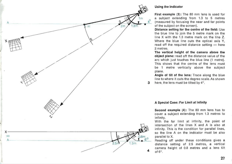

The user's manual is pretty nice explaining how the camera works:
I don’t think either book has much on how to use the camera beyond some technical information about the photos. Get the user manual and shoot. You really shouldn’t need more instruction than that.
Like Pieter12 suggested, the Barry Thorton books are image making books with technical details. Not so much "how to use the camera."
